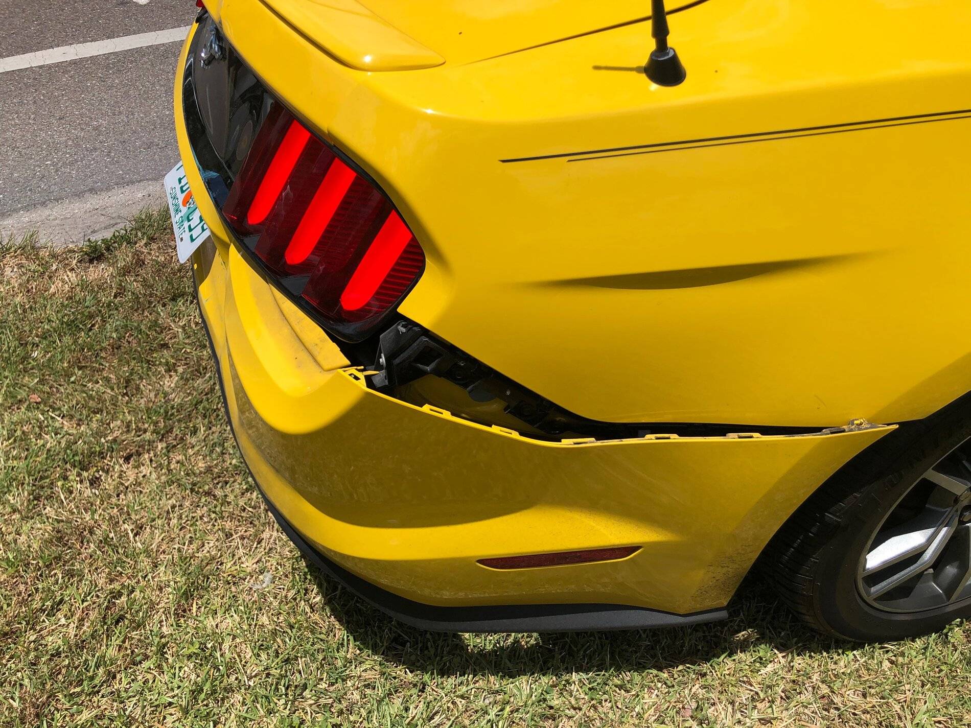

I was rear-ended in May. Low-speed impact at an intersection. (Had owned the car for 3 weeks to the day.) It is a convertible, so less rigid than the coupe. Rails needed straightening. The shocking total was $12,112.80.

Mine was half the damage yours sustained.
When the insurance gave me an estimate, it was around $2,900.
After 12 weeks at the shop, the total came out to be close to 10k.

Looks about like mine did. $14k .....and lots of waiting on backorder parts
