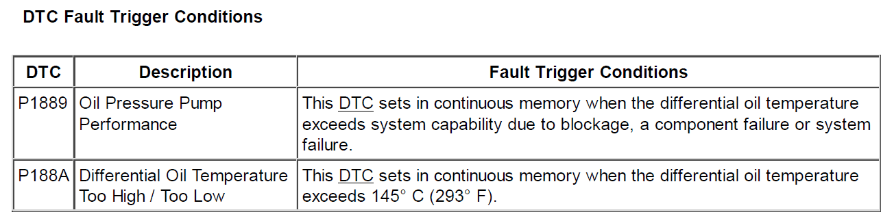

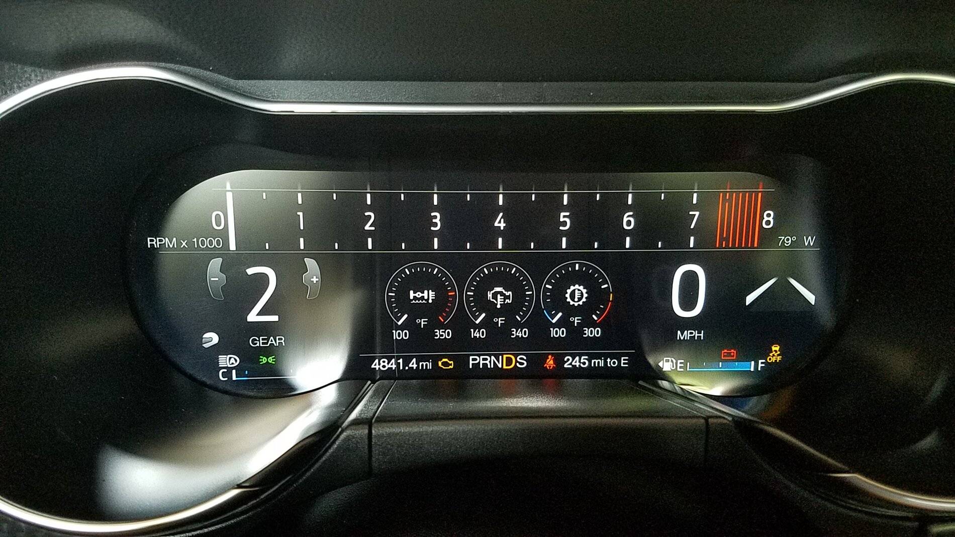

For those that have experienced the "warning" and "limp mode" ...
- At what temp does the warning appear and
- At what speed are we limited to during limp mode?
