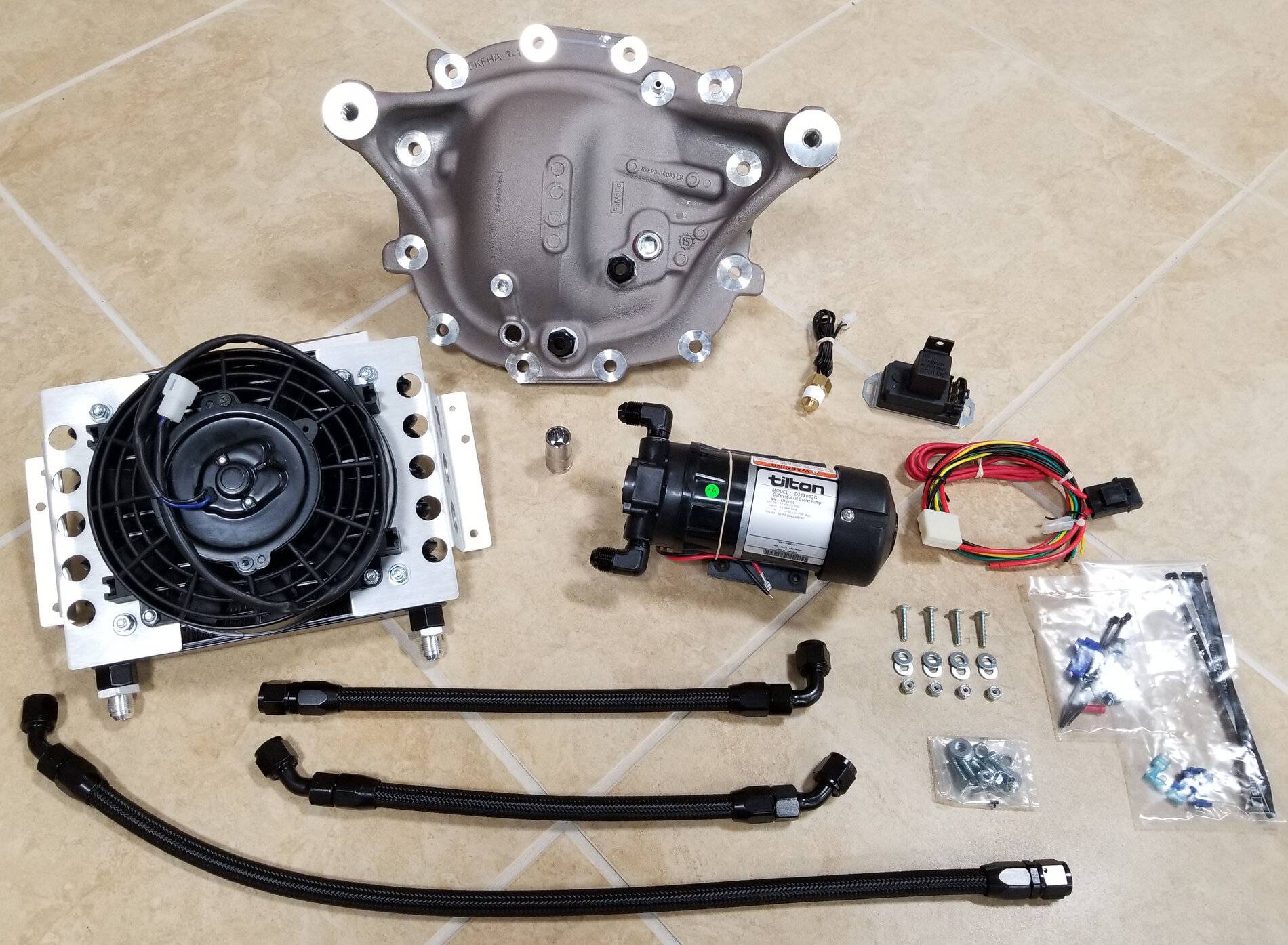

However, when I look at the FTBR setup, like on the image, they provide another diff cover where there is an extra fill hole for the feedback line from the oil pump back to the cover. That is the one with the black AN fitting in it. The regular s550 cover does not come with this fill hole, only the GT350s.

The pp1 unit does, sort of, I just undo the bottom AN fitting to drain and then undo the upper AN fitting and put a 1/4" soft nylon tube into the 90° elbow upper fitting and pump the fluid in it starts to run out. I know some will say that its suppose to be 9mm from the top but 9 mm won't hurt it at all.
