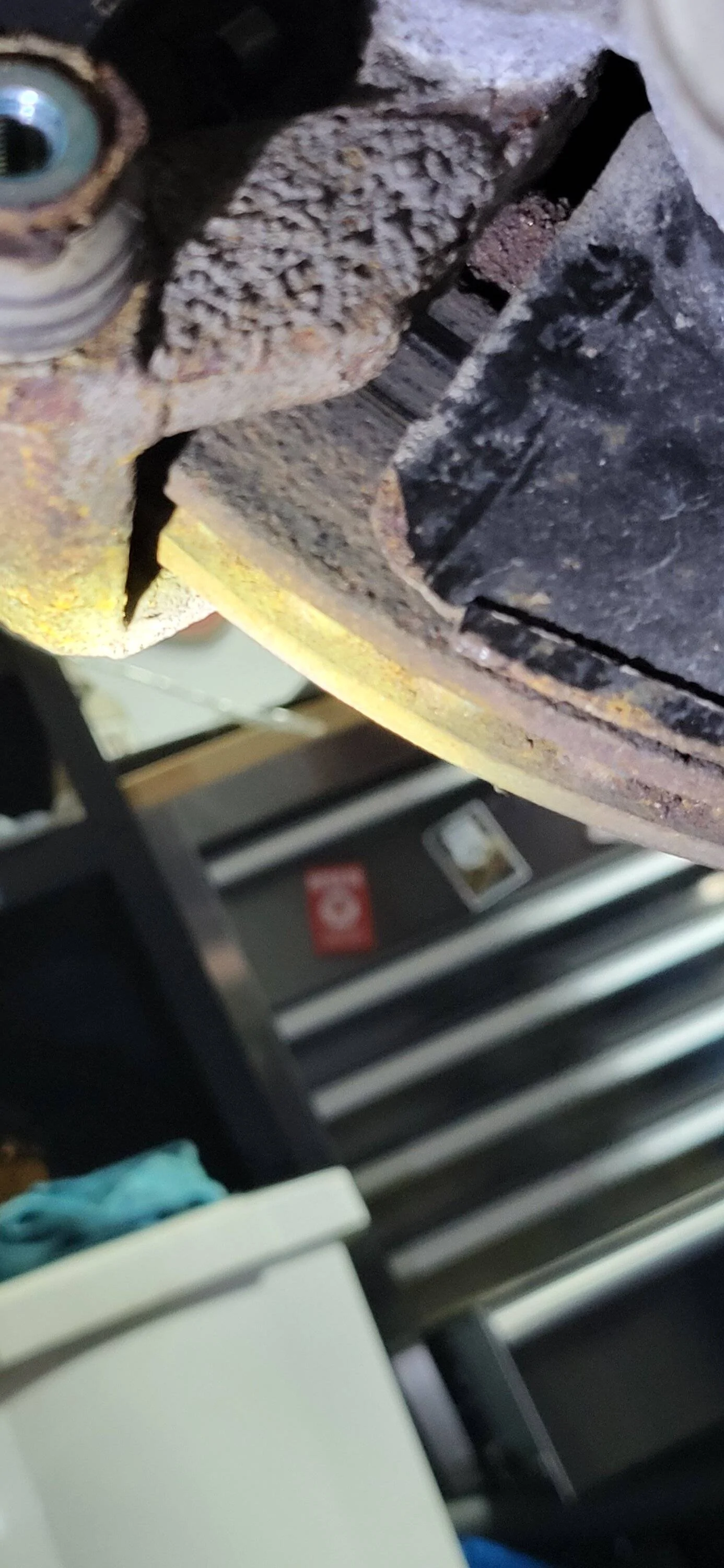

This is the brake pad. It should be inside the caliper.
This is the dust shield, under the caliper. Here's another shot (That shows that I had removed half of the caliper though :) )

Hello!
Was u der the car this morning and I notice that the inner side of the rear brake disc was like it never saw Ă  brake pad for decades (unless a very thin line)
The other side of the disc is normal, and the pas are still ok (car has 30000 miles and is almost daily Driven).
I guess my caliper is stuck, due to previous winters and salt on the road, but I wonder if you guys have any ideas or advice.
Thanks!
Yves.

Montreal , QC, Canada :-)
That was my daily driver for 4 years, including during winter.
Despite having cleaning it carefully before storage last winter , this happened ... :-(

I removed the pads, pushed back the piston and brush everything, along with a hand brake adjustement. The piston was actually moving freely back and forth so I guess the issue was more due to rust preventing the pad to come closer enough to the disc.
I now have a slight friction noise and the rust on the disc is going away.
Anyways, I've ordered new discs, pads, and calipers, along with dust shields and will fix this properly soon.
