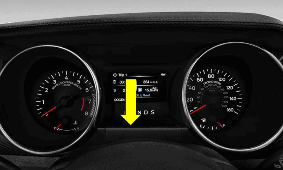

The plastic piece between the speedometer and tachometer on my standard instrument cluster has an annoying rattle. Picture below for reference. I know it's the problem because if I use a little force to push and hold it back against the cluster, the rattle stops. Has anyone else had this issue? Thoughts on a quick fix? The entire flat piece easily pops out, but I'd rather not remove it even though it serves no real purpose.

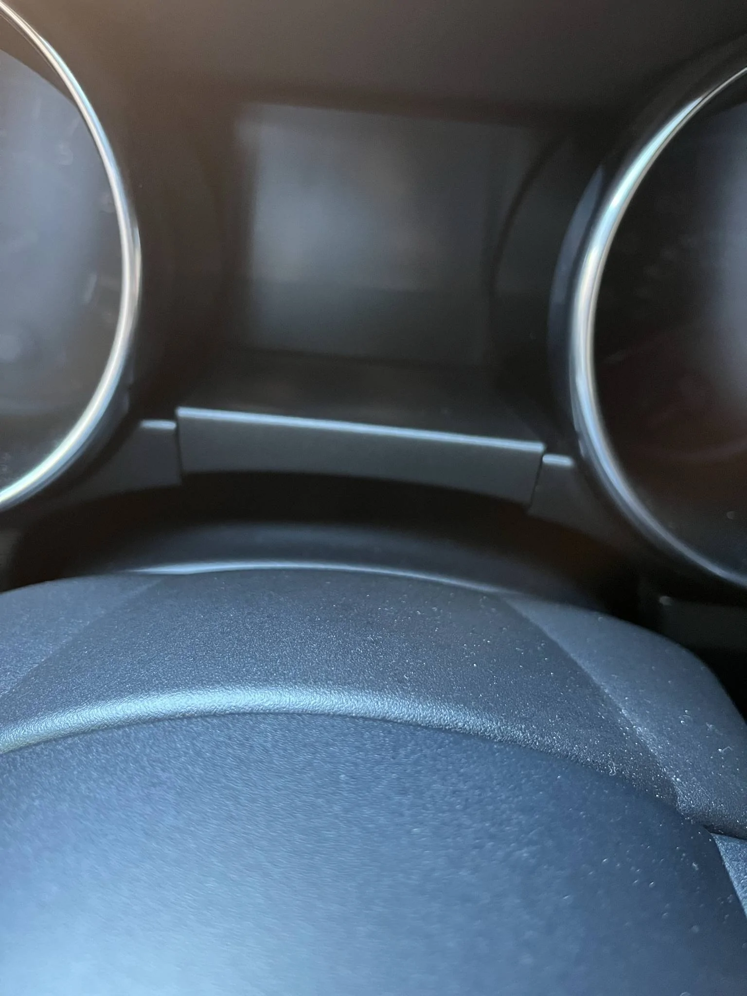

Same happened with mine after I swapped exhaust. Oddly enough, I think my new exhaust is quieter than stock. But anyway, I have that piece sort of half snapped in for now and will get some thin flocked/felt tape to get the rattle out.

I popped mine up and then put it back half way, now it is pinched and no long rattles. But it does stick up 1/4 inch, but it looks fine.
Ha! Jinx. Same here...
@txpat3 - I dunno yet. I put it in the position pictured above while driving* and thought I'd screw with it this weekend. If you find a trick, holler. There's a void under it. Might be able to stick a piece of foam in there.
* rattles make me bat**** crazy and I will pull over to make it stop.

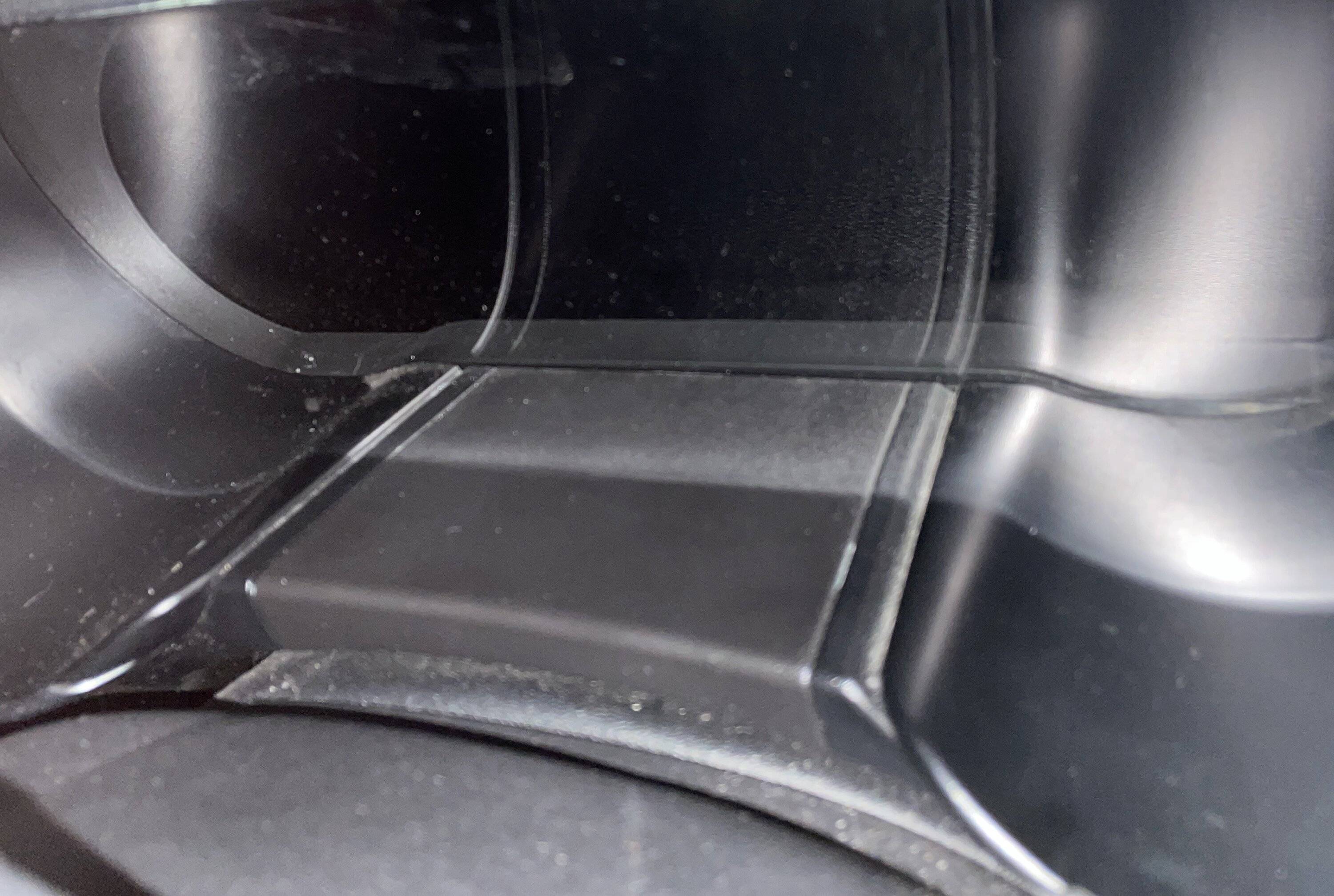

I put a piece of foam packing material (similar to a pool noodle) in the void under that piece and rattle is gone . You really can't see the foam from the driver seat and you don't have to worry about breaking that plastic piece by popping it out.

If you want to stop it.....
Just do a drop...and I mean a drop, of silicone sealant. Clear. Right in the molded crevice where you won't see it. Just enough to stop the buzz, not enough to cause an issue if the piece needs to be removed in the future.
