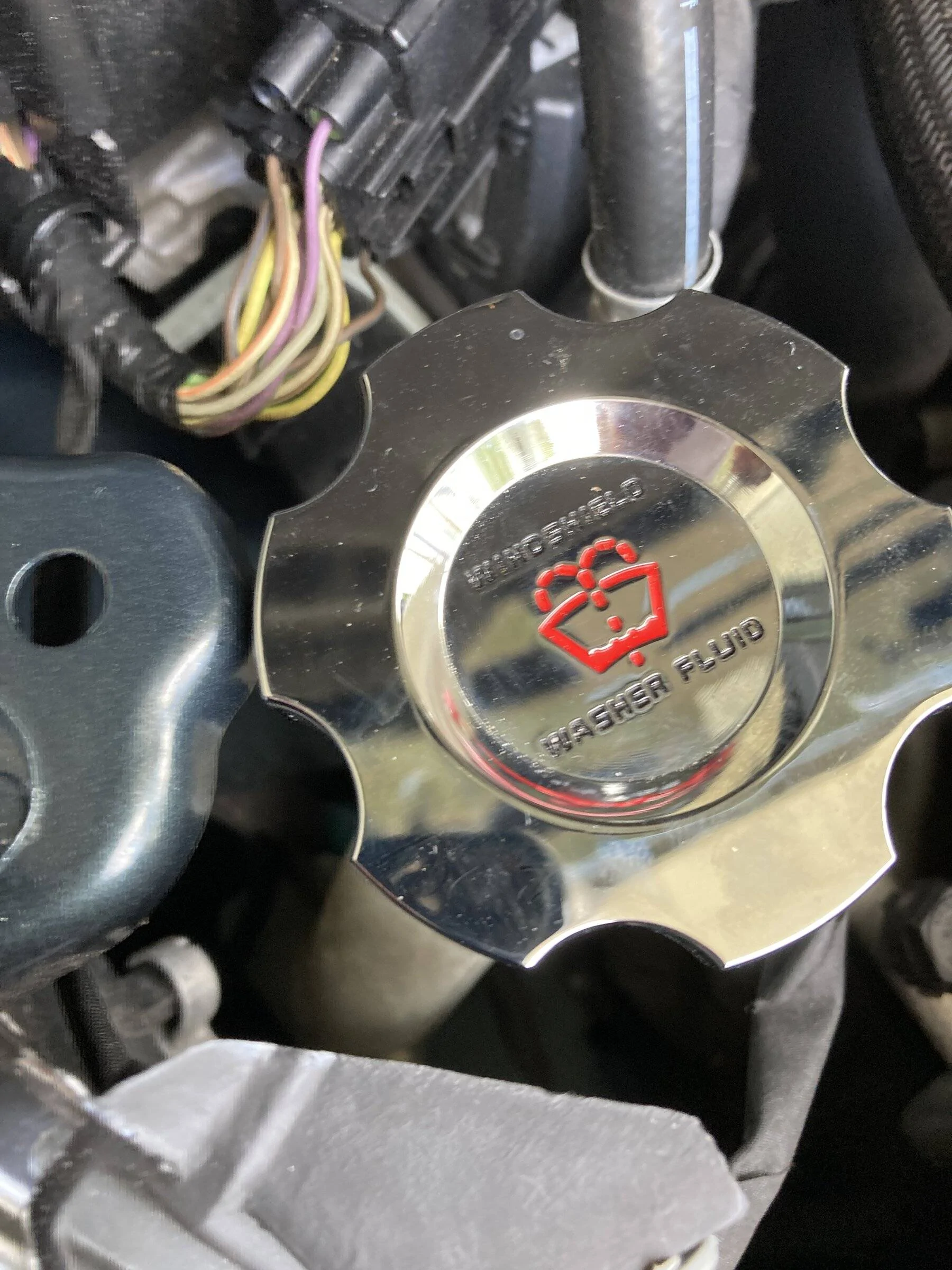

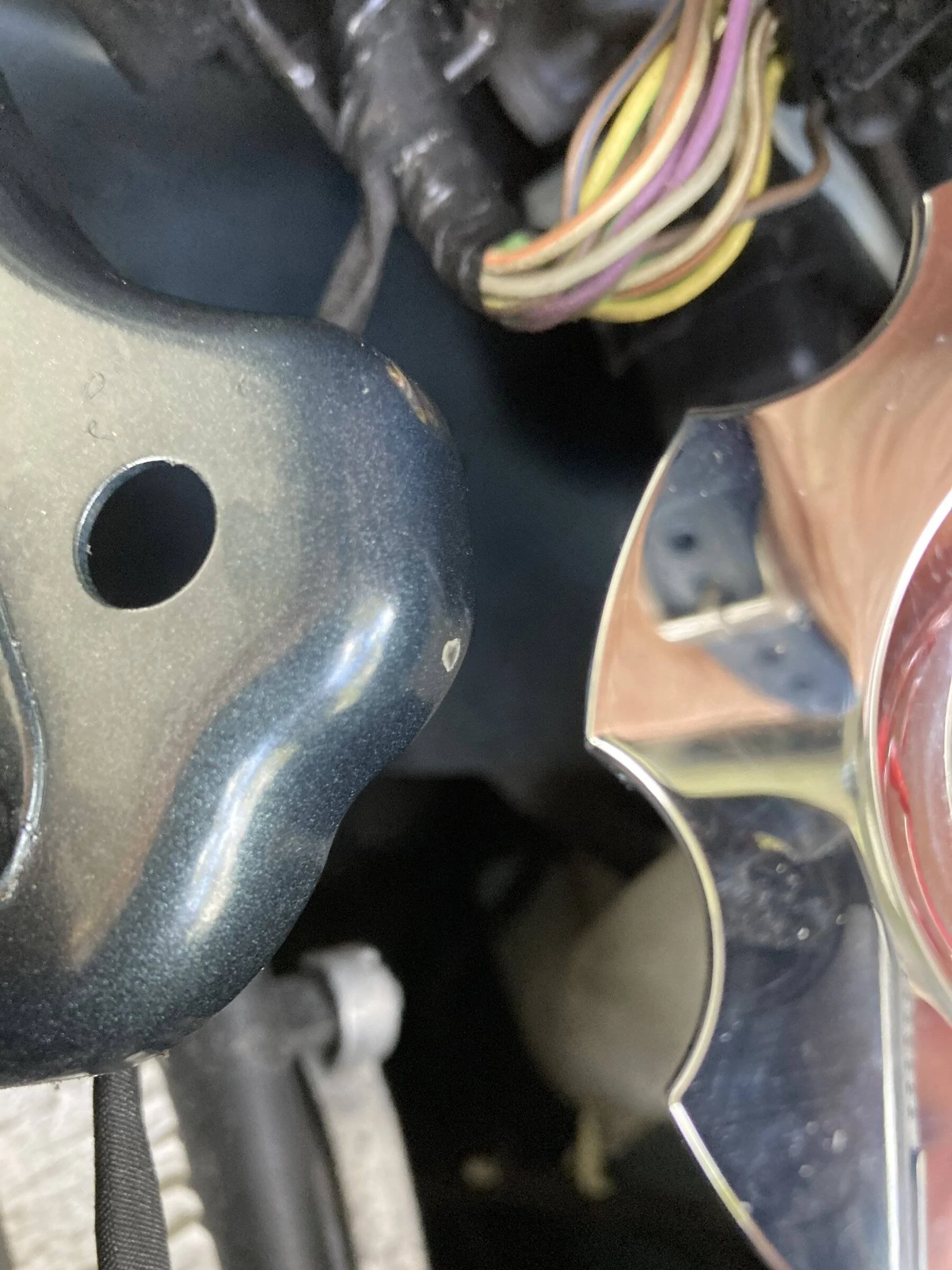

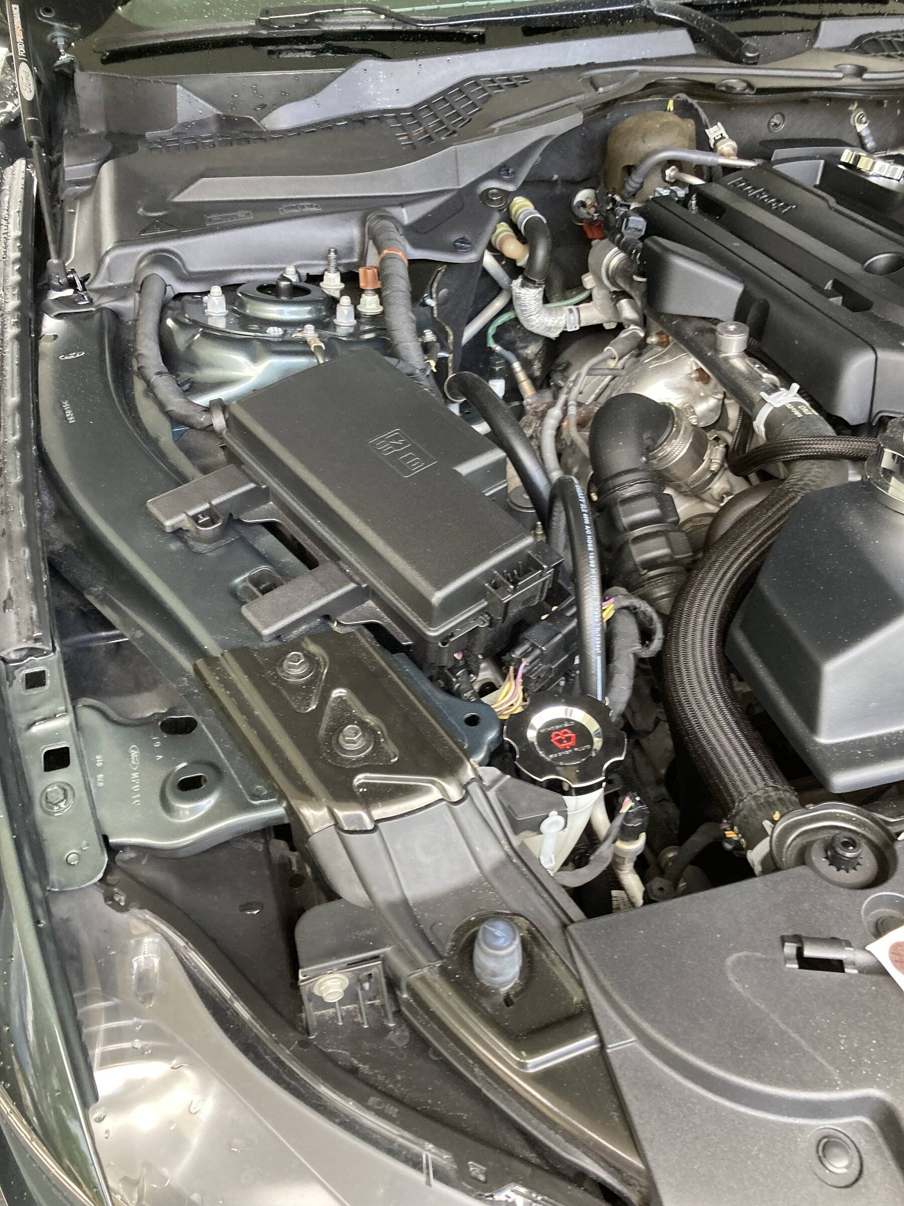

Well, the mystery of the passenger side rattle has been solved. And, the winner is a response from "dgcomps" who deserves a hardy thank you and a great "atta boy" Seems after installing some nice chrome filler caps the cap for the washer fluid neck was tapping on the front end of side frame. Amazingly, this tapping noise transitioned aft through the frame and sounded much louder in the dash. Installed some temporary press on felt tabs to the side of the chrome cap and the rattle is gone. Now the process of finding a more permanent, professional looking solution. Attached some photos to help everyone visualize the problem. Thanks again to everyone who gave their time to help with this dilemma . In one of the photos you can see the rub
mark on the frame.
