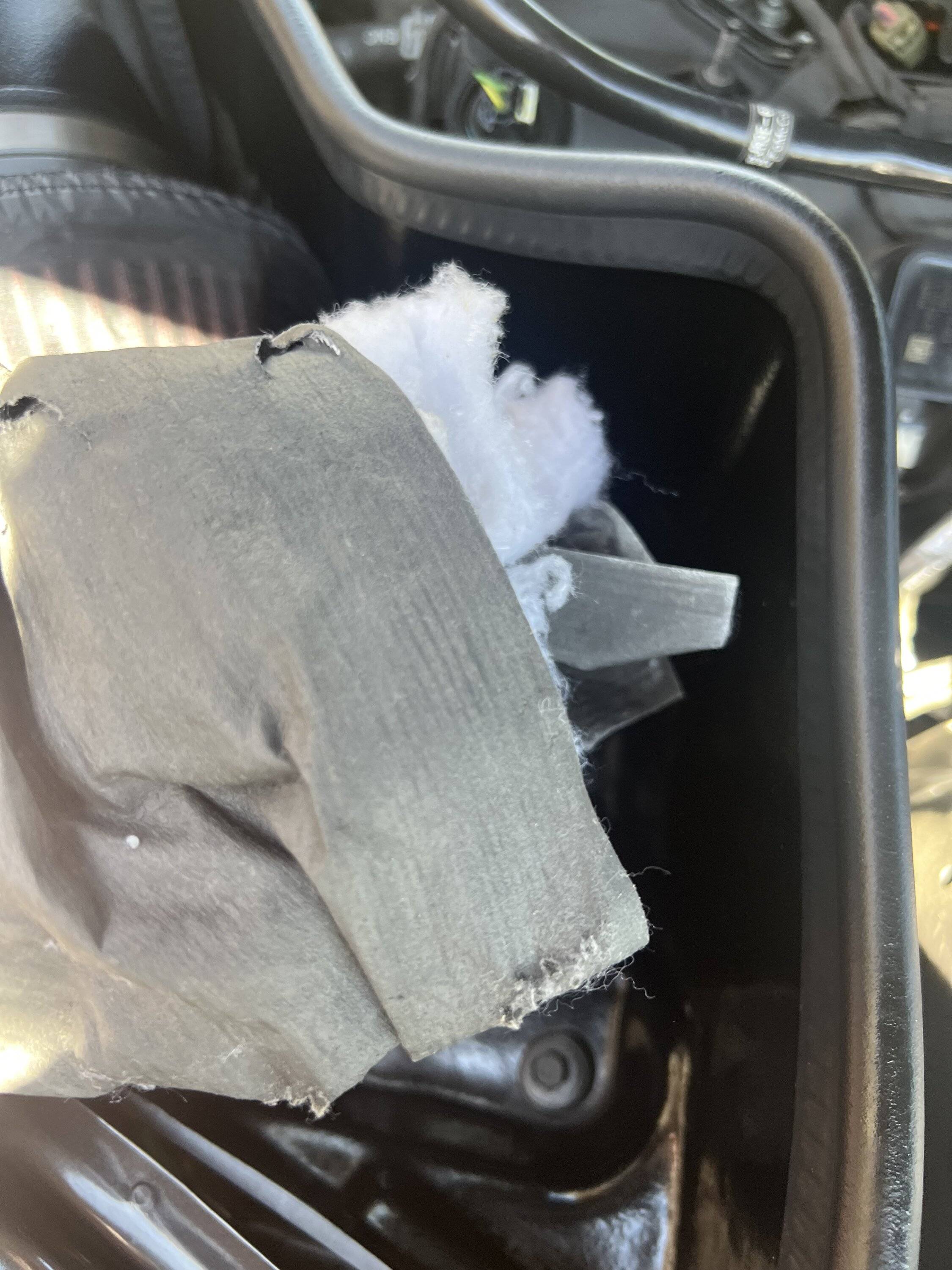

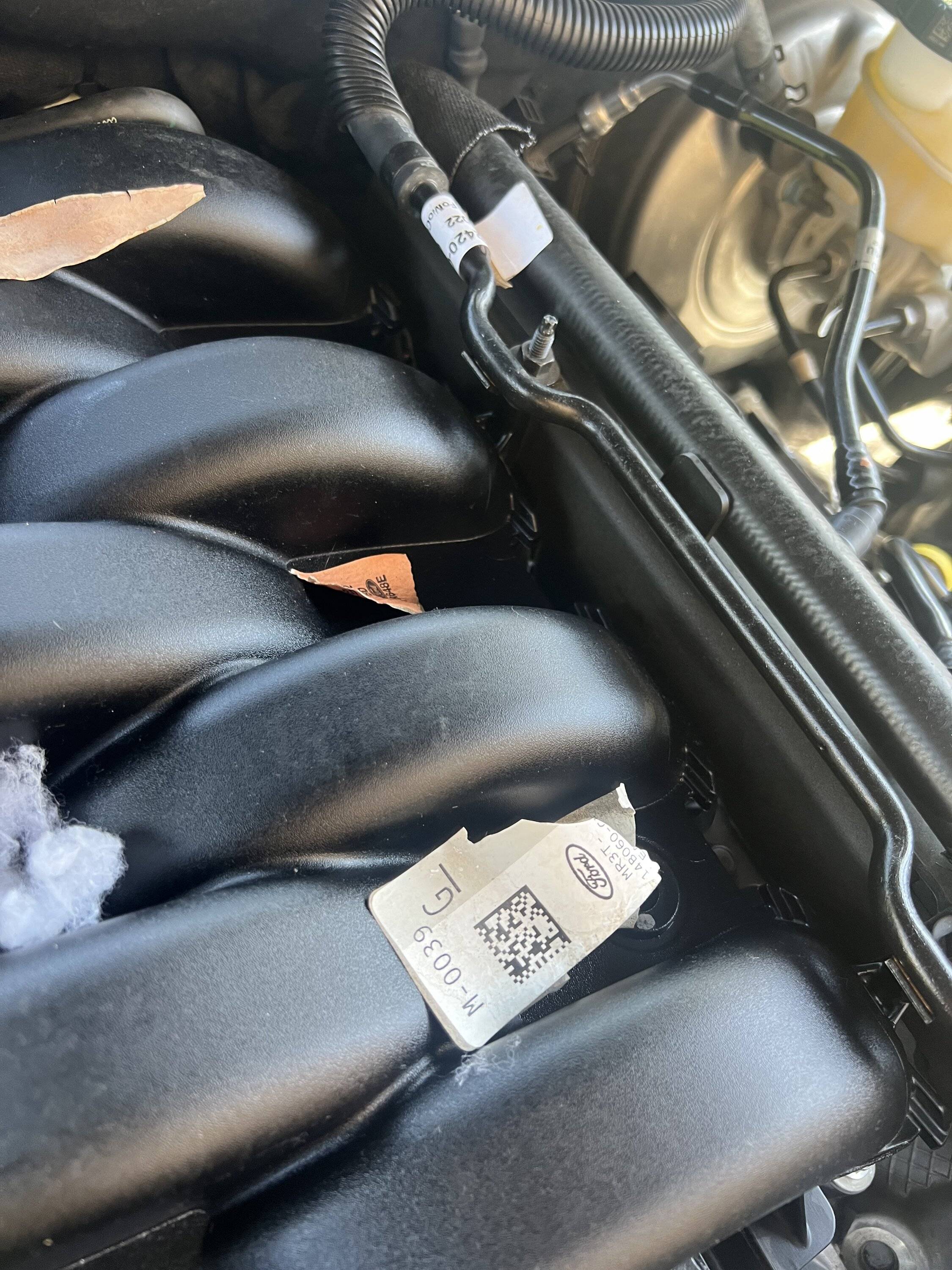

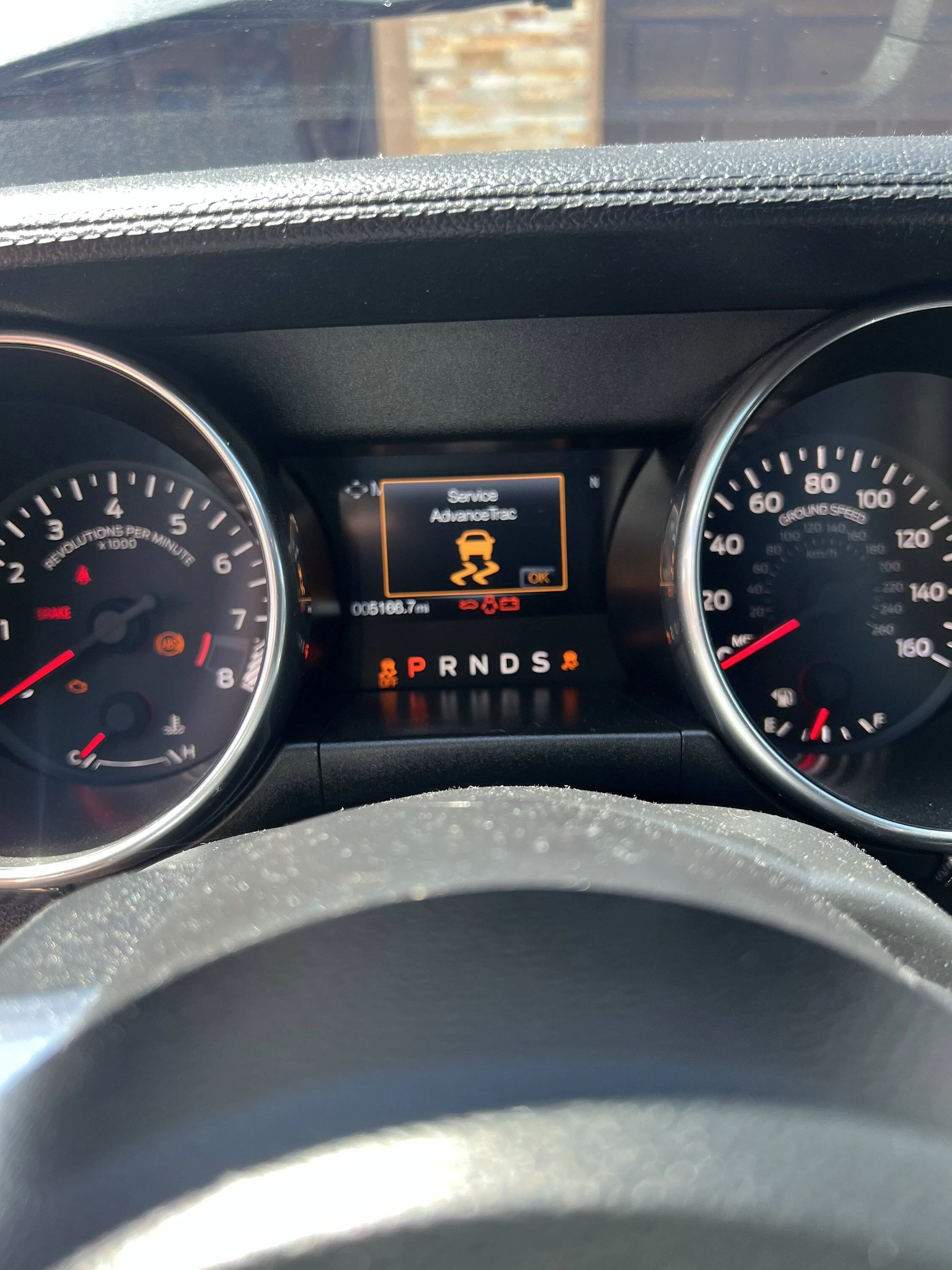

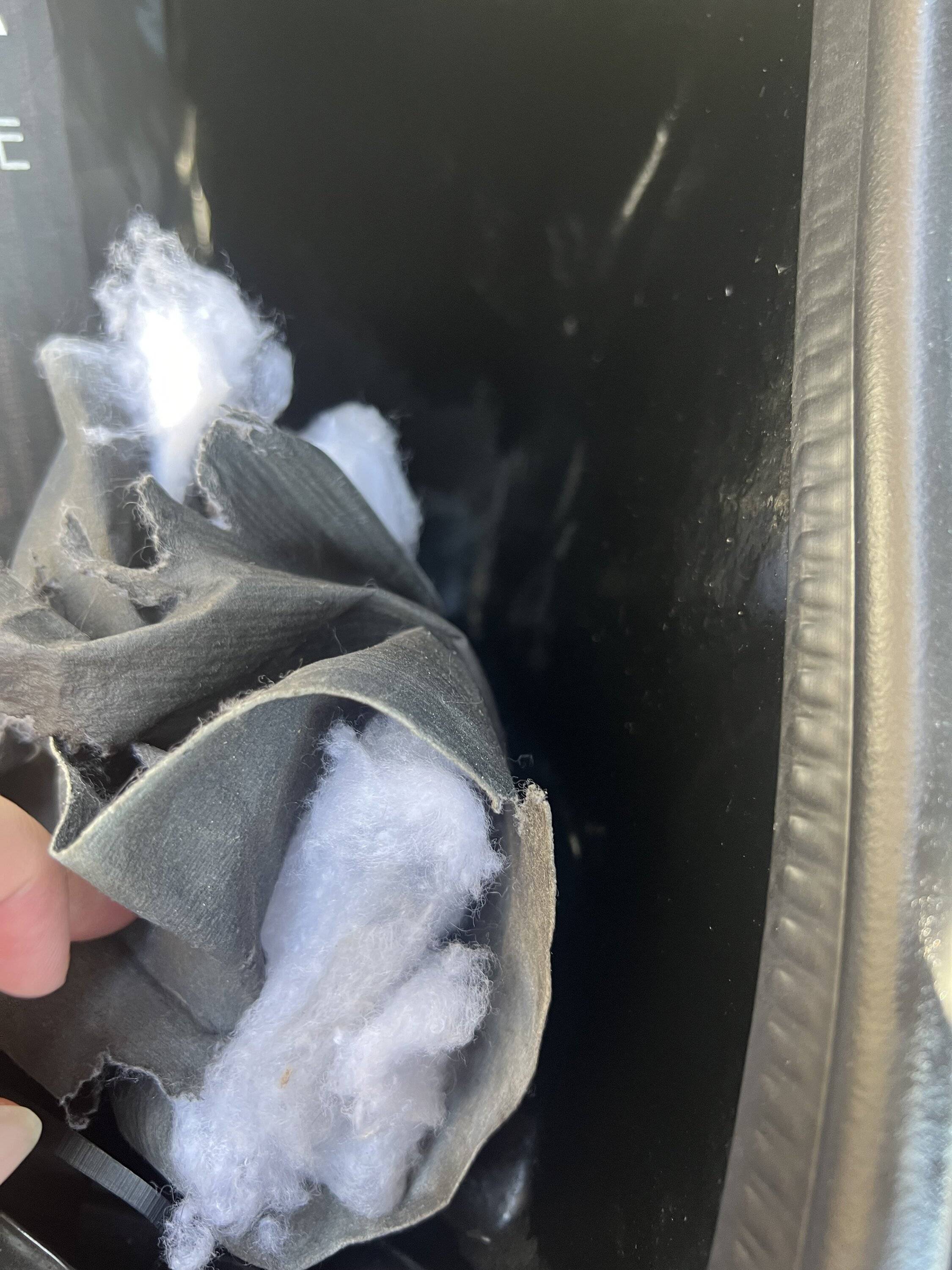

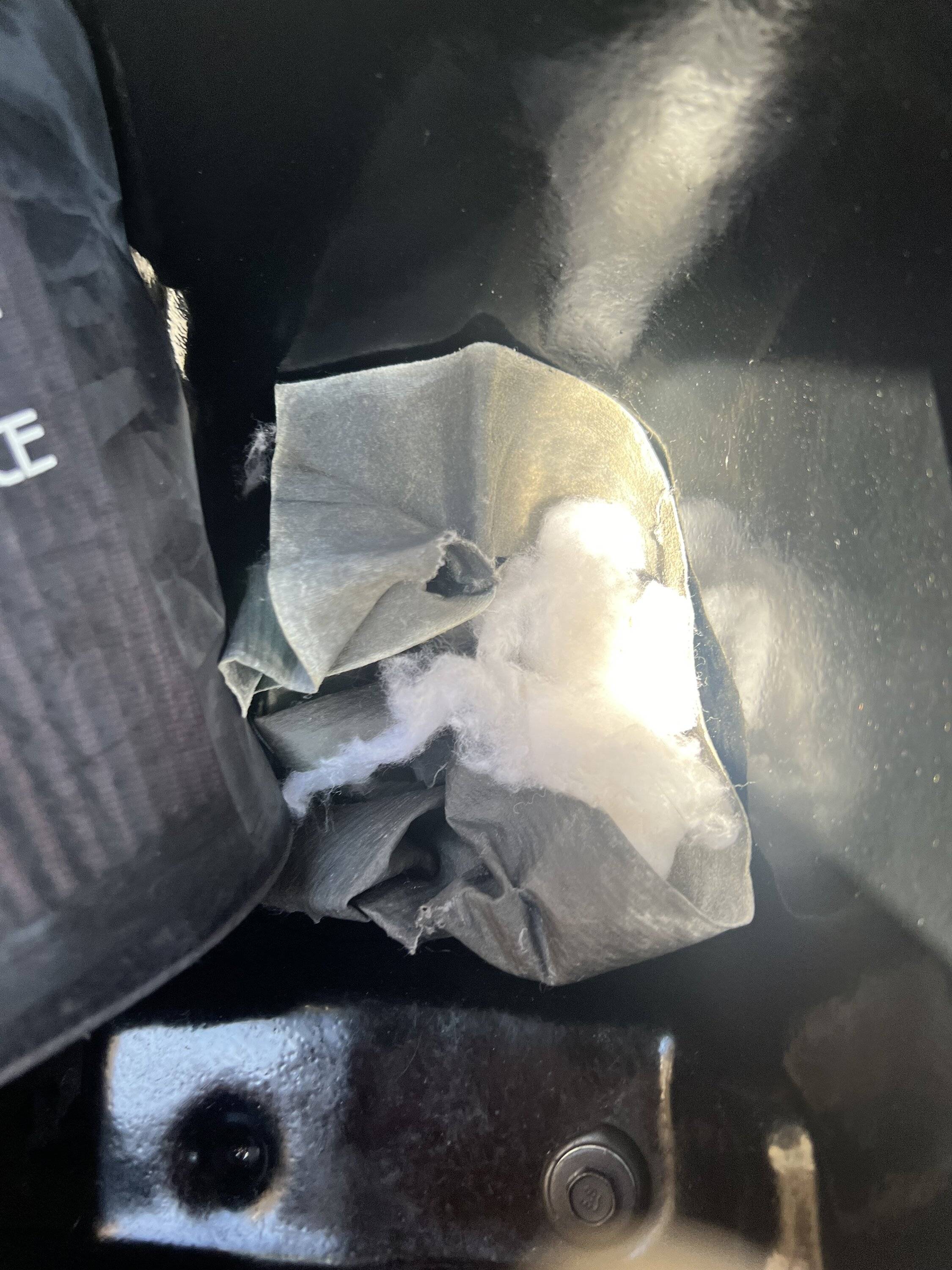

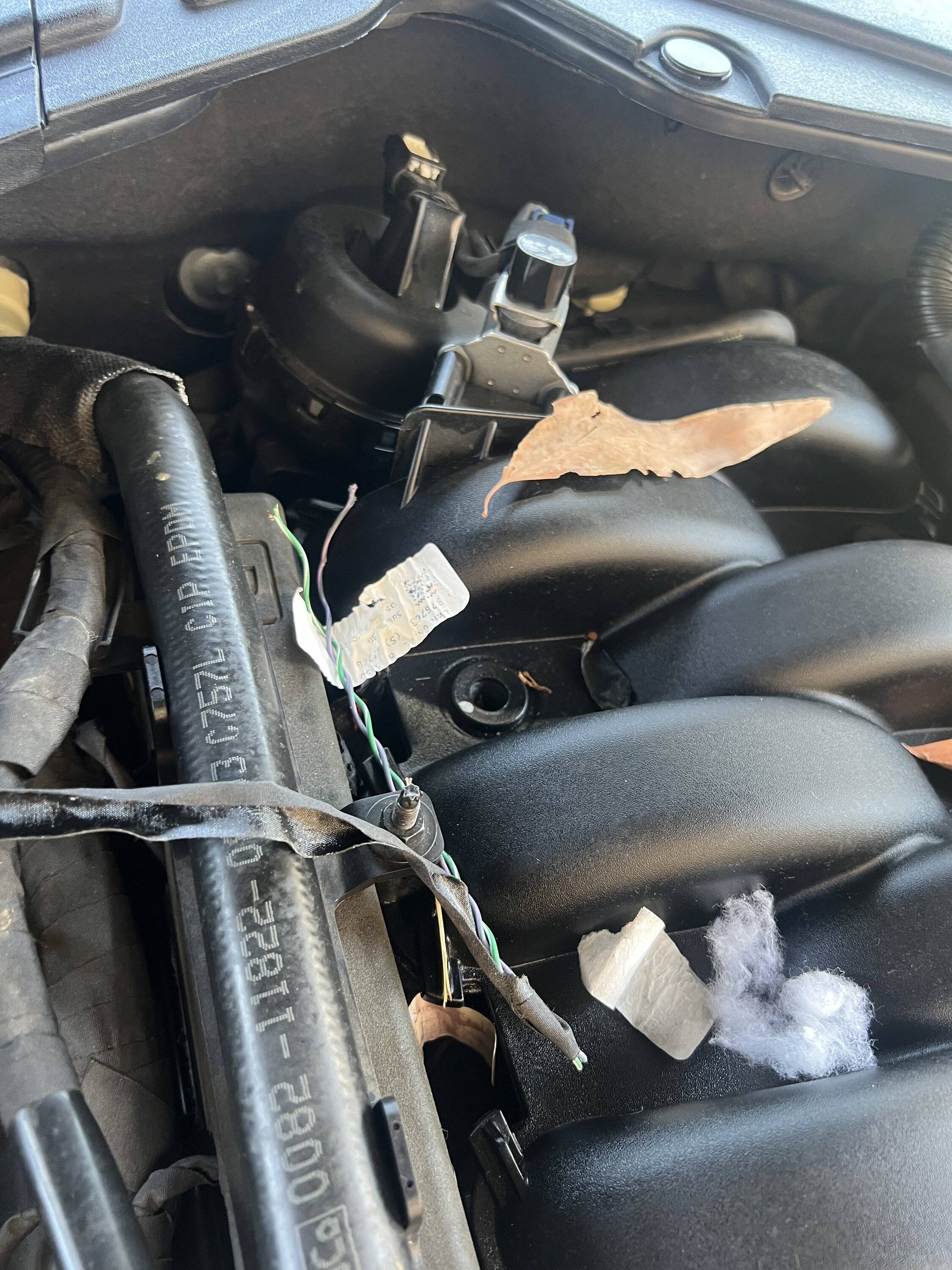

Any help is appreciated trying to figure out where this wire went and if this wrapping and fuzz is off the car to when turning on car says pre collision assist not working and service advance track. Sucks they got into my brother truck a week ago and I put out bait and stuff to late I guess. car sits under a cover for a week while at work then uncover it and cruise for The Weeknd’s bummed out for sure.

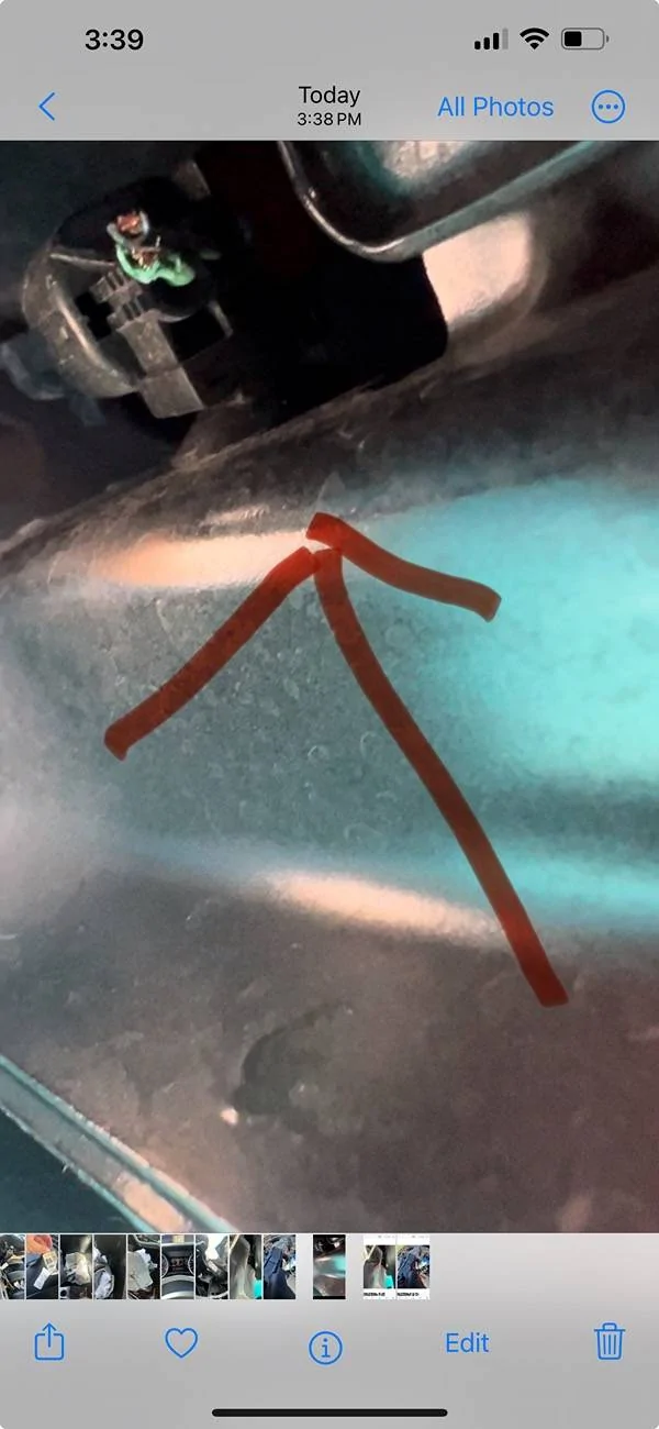

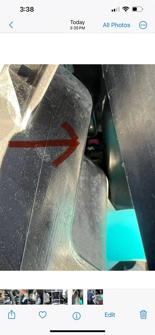

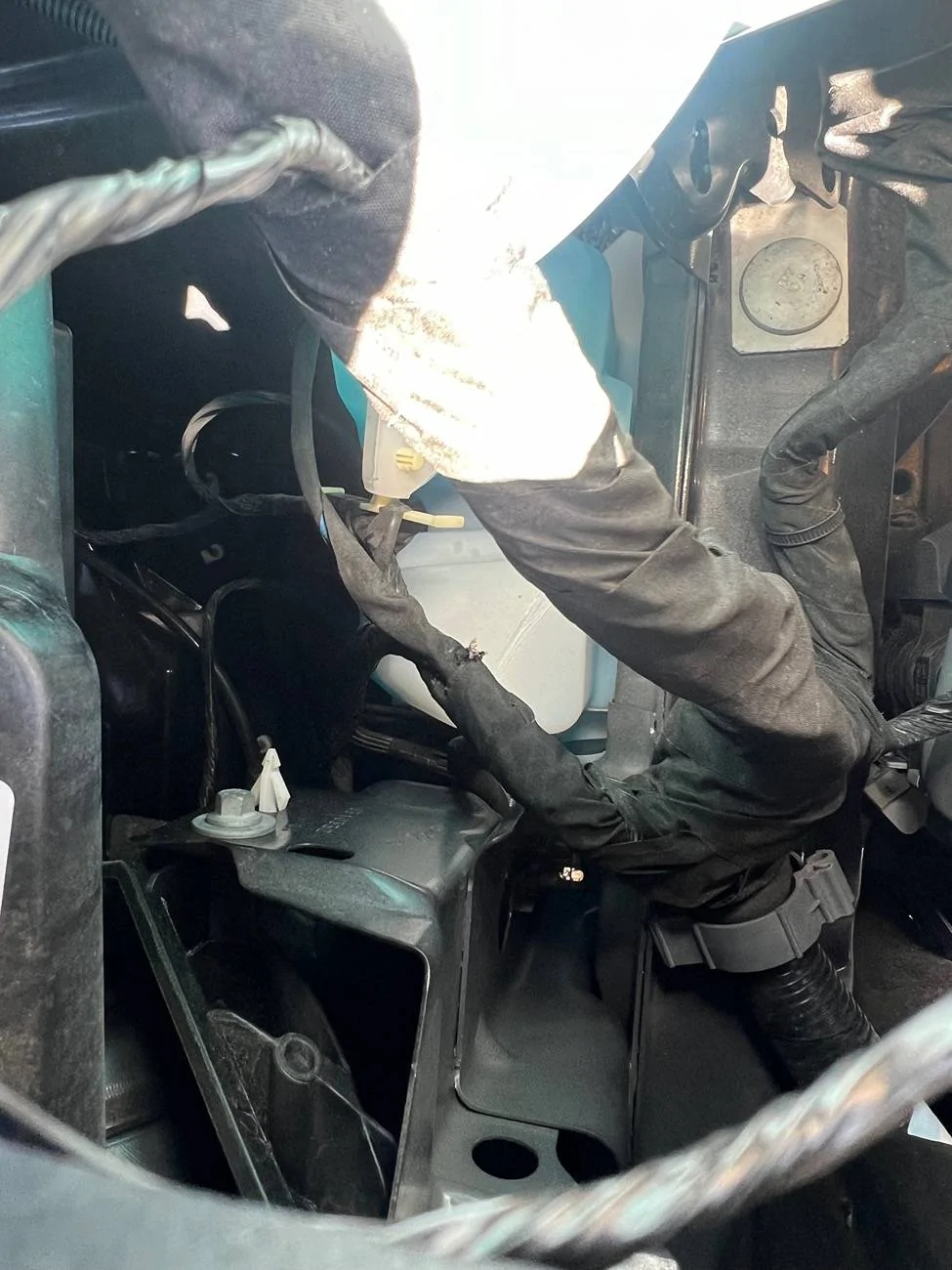

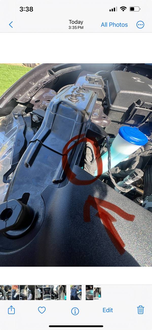

Found it behind the window washer reservoir

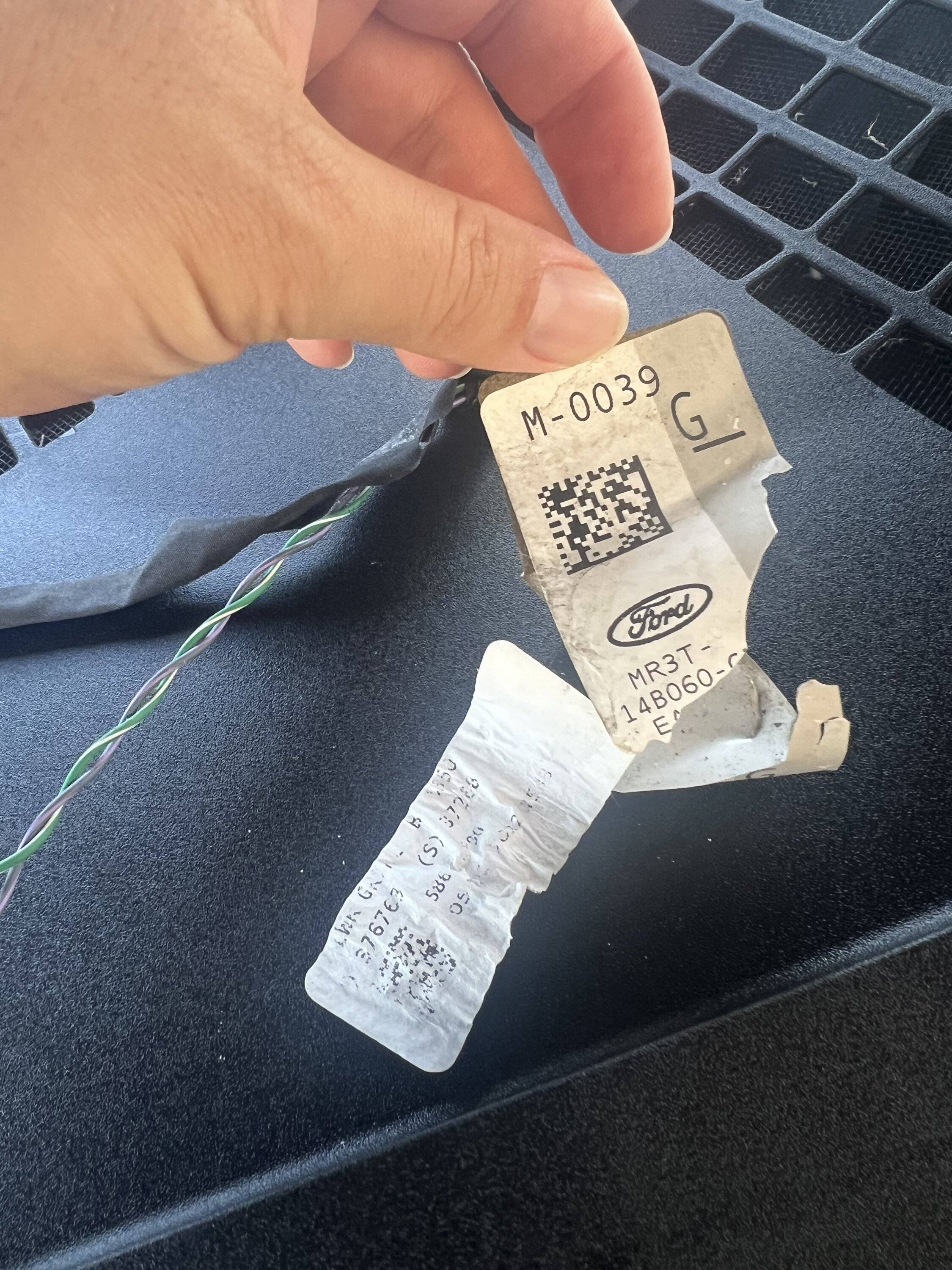

Those wires are a "twisted pair" and as such means they are data wires. Obviously something that contributes to the traction control system. Could be ABS related, speed sensor, something from the transmission, etc hard to say exactly what. Just take care when repairing them. I'd use a couple of uninsulated crimp barrell conectors and cover them with marine grade shrink tubing with sealant/adheasive inside. If they won't go back in the harness easily get some small split loom or some dedicated wiring harness tape. Don't use normal plastic electrical tape.

If you can locate a friend that has a bit of electronics expertise he/she may be able to solder the wires back together, and as @ORRadtech stated, use marine grade heat-shrink tubing with the sealant inside. I've had better luck personally with soldering than barrel connectors, but regardless, with the system the wires support, you'd want a trouble-free repair.

If anyone has to deal with this wire for future reference this goes to the front right wheel speed sensor so it tripped out the abs and what not. I ended up calling the insurance and they covered it wasn’t to bad of a fix couple hours at the dealer they spliced and did a wire kit would been about 280 out of pocket if paying. I’ve been throwing green cubes around in stations and using peppermint spray around the engine so far they havnt came back hopefully they just move on I rather not go on a killing spree but mess my stuff up got no other choice ha ha.
