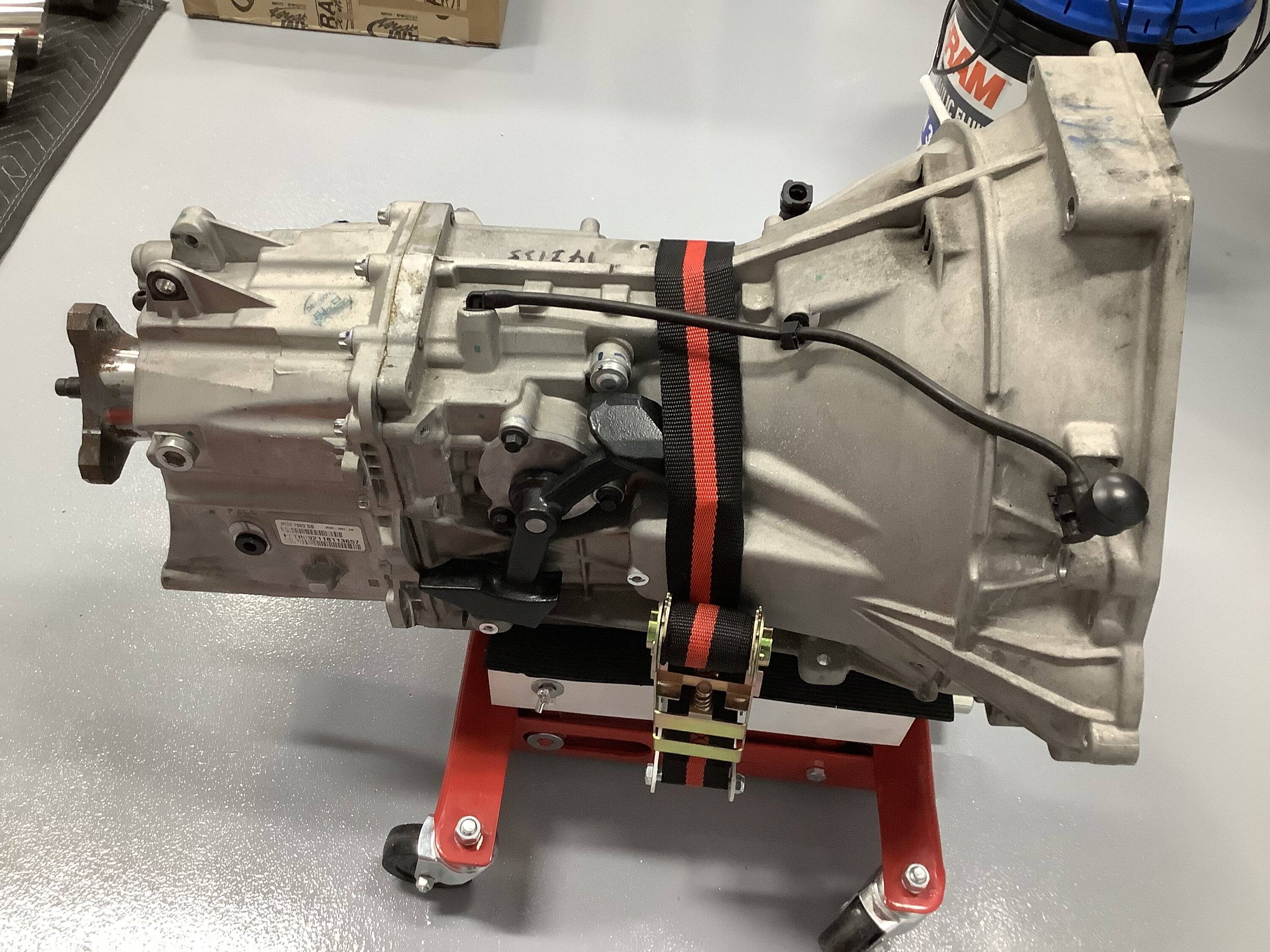

Are you lugging the engine and upshifting too early? That’s what it sounds like to me. If you are, that will
cause gear rollover noise. Try running the rpm’s up a little higher in each gear and don’t lug the engine (only upshift when necessary) and see if the noise goes away. I rarely use 5th and 6th gear in my car (only on the highway and even then, I usually only shift into 5th if I do).
One other thing that rattles on the MT82-D4 tranny is the counterweight on the right side. If You can, Jack the car up, slide underneath and wiggle the weight to see exactly what I’m saying.
I removed that weight and installed the Calimer weight delete plate earlier this summer. That weight makes all kinds of noise!
