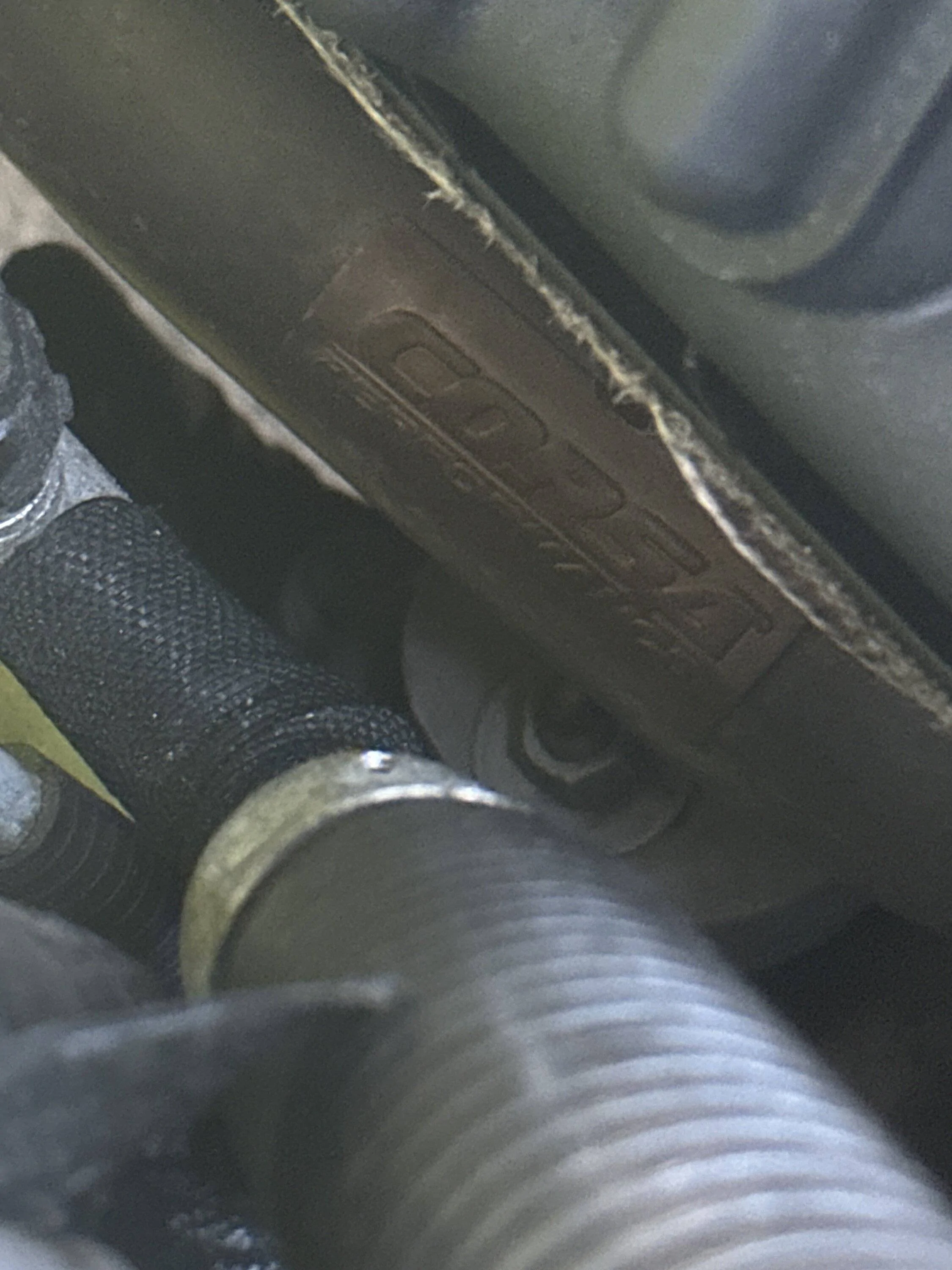

Is that sound in the second 13 related to exhaust?
NGOT8R
Jul 19, 2020
154
9,403
7,901
Adrian
2019 Bullitt
It could be exhaust making contact with the frame rails. When your friend puts the car on his lift, ask him to look on the passenger side by the AC lines. Some brands of headers make contact in that area. The fix is to shift the motor over as far as possible to alleviate the problem.
NGOT8R
Jul 19, 2020
154
9,403
7,901
Adrian
2019 Bullitt
That header primary tube looks close to the frame rail. I’ll bet it is making contact from engine torque-over when accelerating.

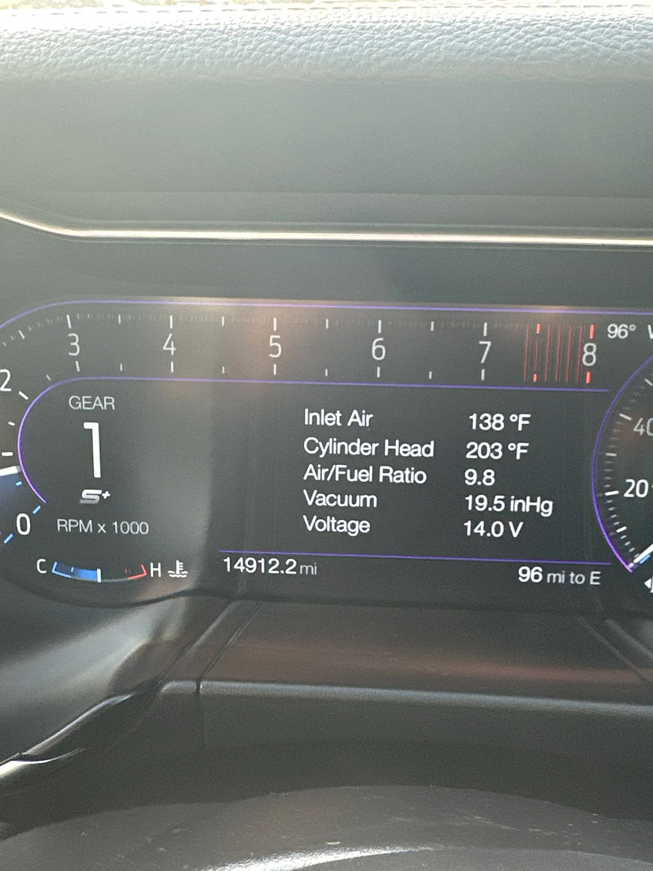

I’m believing car is tuned . Only has up stream o2sensor ? Is that possible?
Erick101
Erick101
Sep 24, 2023
Largo
Erisnel
2021 mustang gt
Downstream are closed .
Erick101
Erick101
Sep 24, 2023
Largo
Erisnel
2021 mustang gt
No check engine light but 9.8 fuel ratio?
NGOT8R
Jul 19, 2020
154
9,403
7,901
Adrian
2019 Bullitt
I think your PCM has been flashed for an E85 tune.
