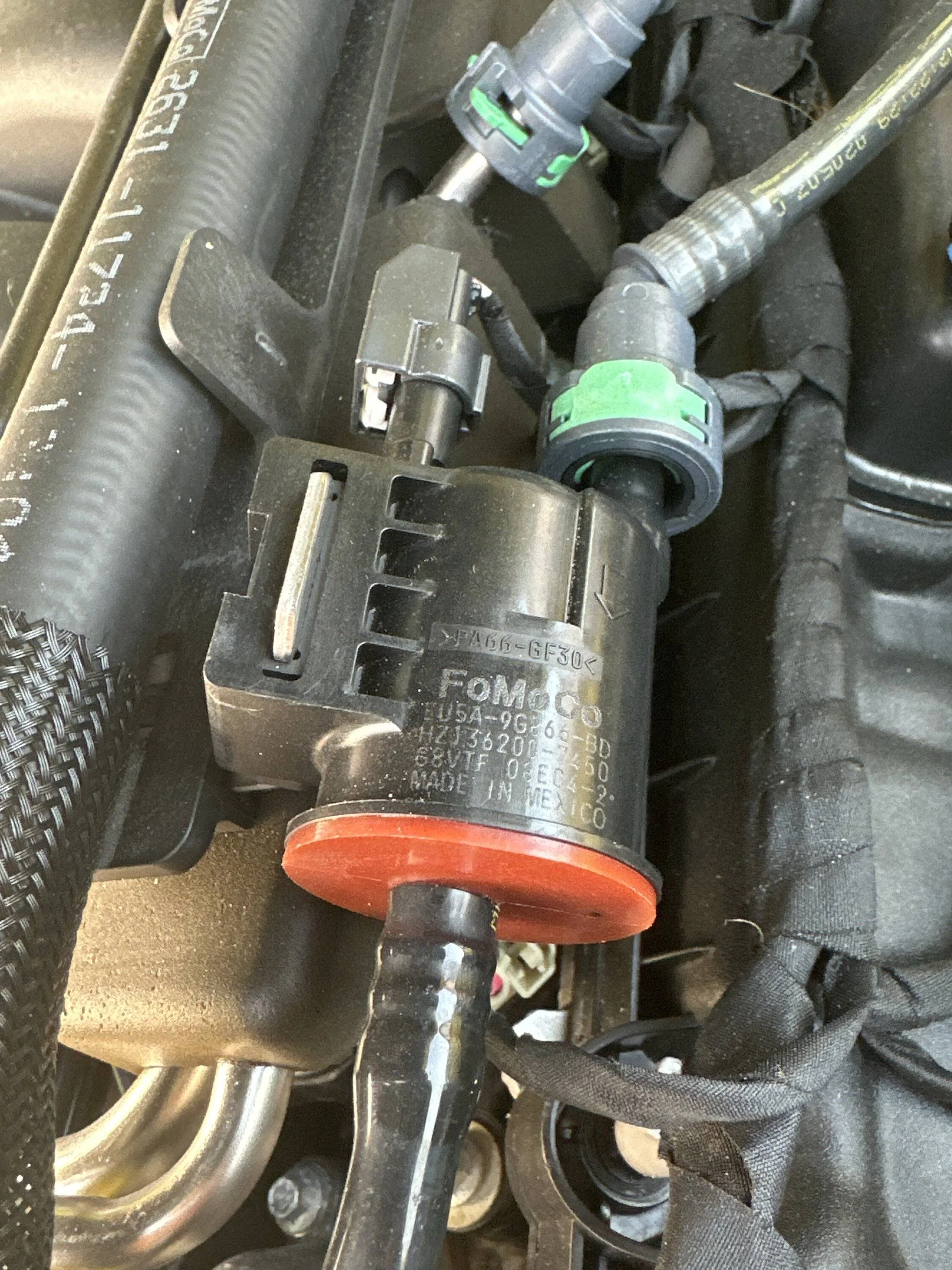

Okay, that‘s a factory component there. They’ve obviously made a few subtle changes between the 2019-2021 models.

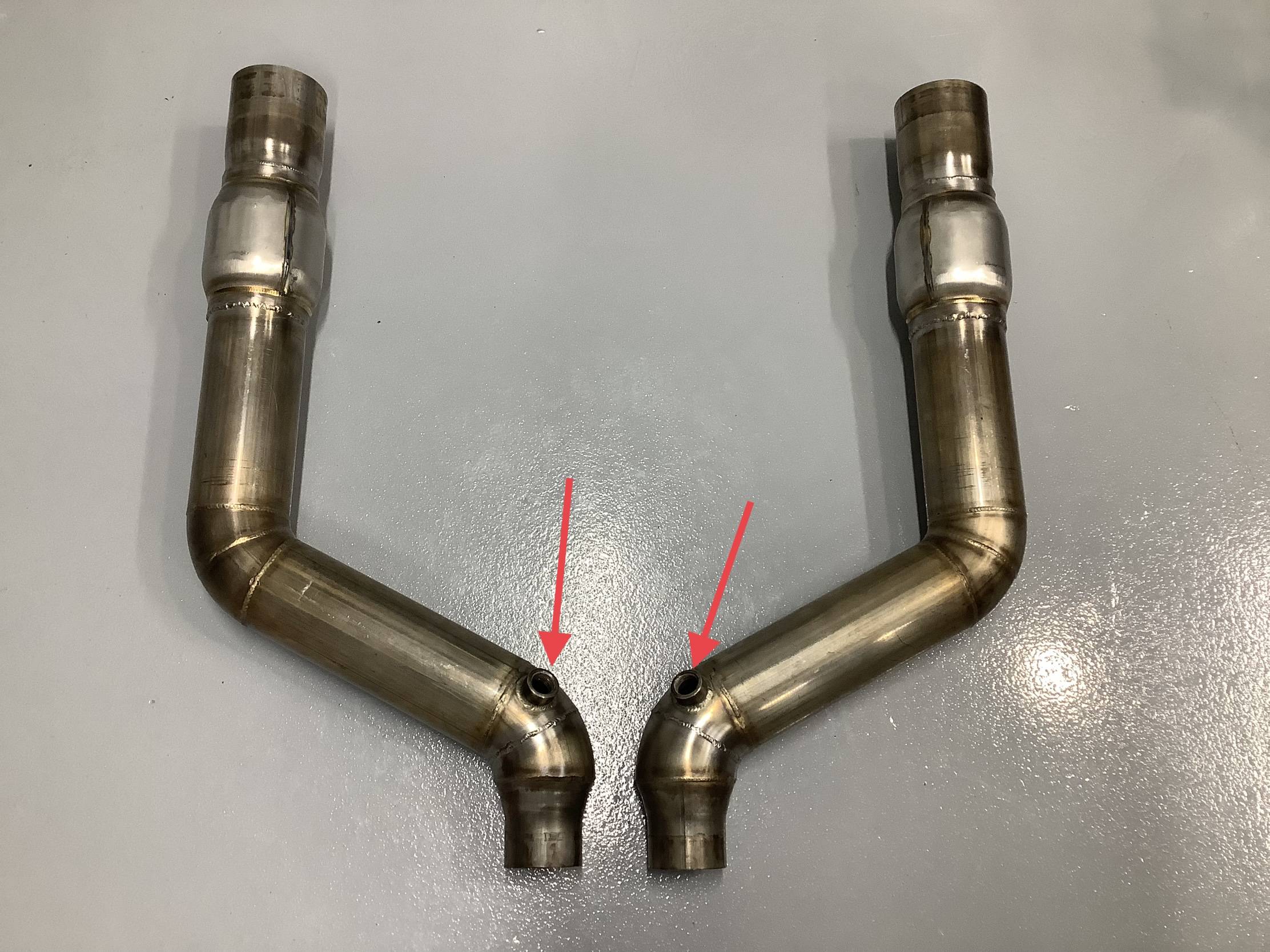

Ok . I’m planing to reflash car with ford . So I need to plug downstream o2sensor after reflash ?

Yes. You will need to remove the two plugs and install two new factory downstream o2 sensors. Your mid-pipes should look similar to mine. The o2 sensors will plug in here (torque them to 30 ft-lbs) and plug them into the factory wiring harnesses.

Yes I will do that . I need my air/fuel ratio back to 14.1. Thank you all for the help .
