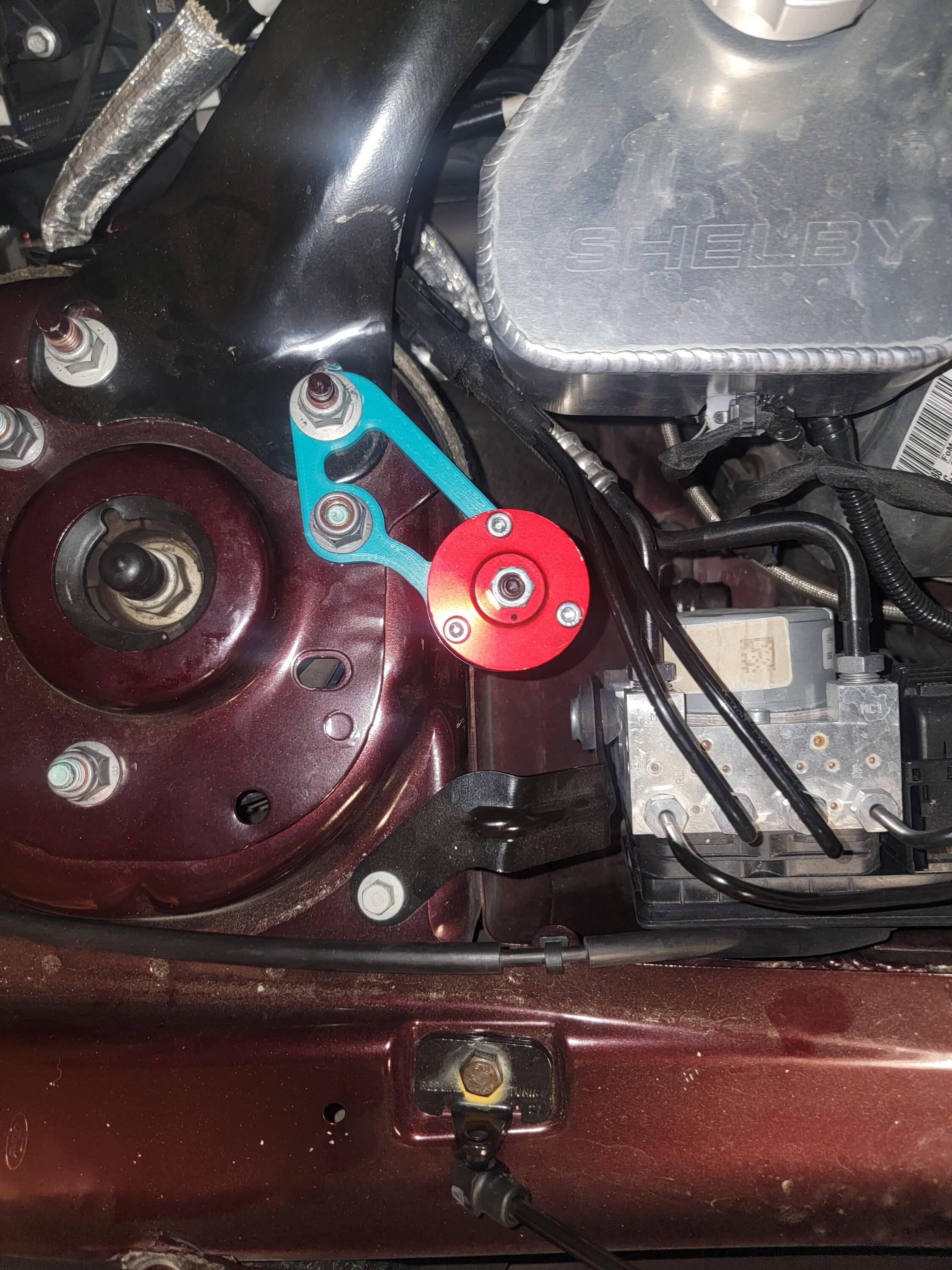

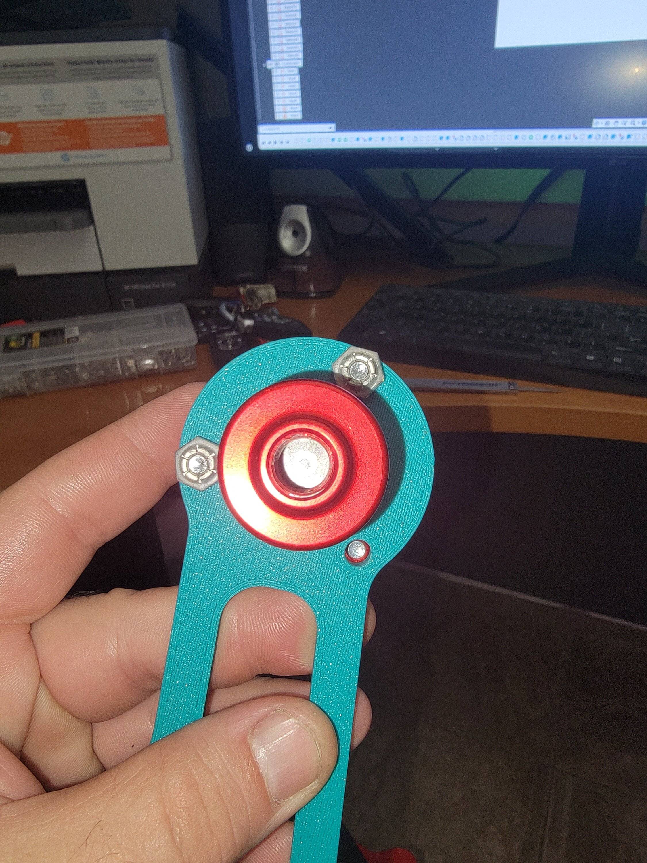

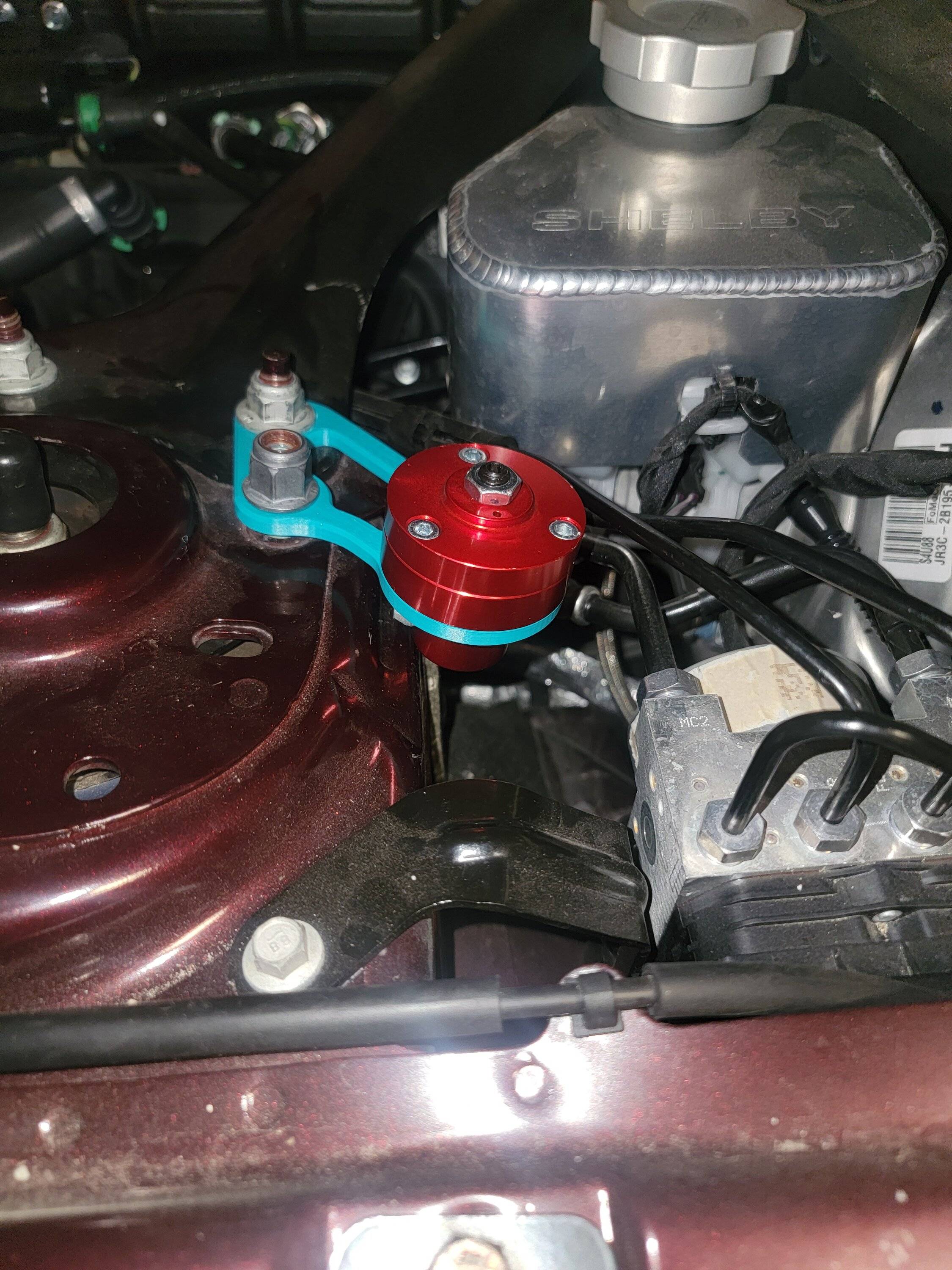

I avoid drilling holes if i can. Took to cad to draw a mount up for my clutch pedel height adjuster and 3d printed it out for fitment. I will have a metal one made using the cad design.

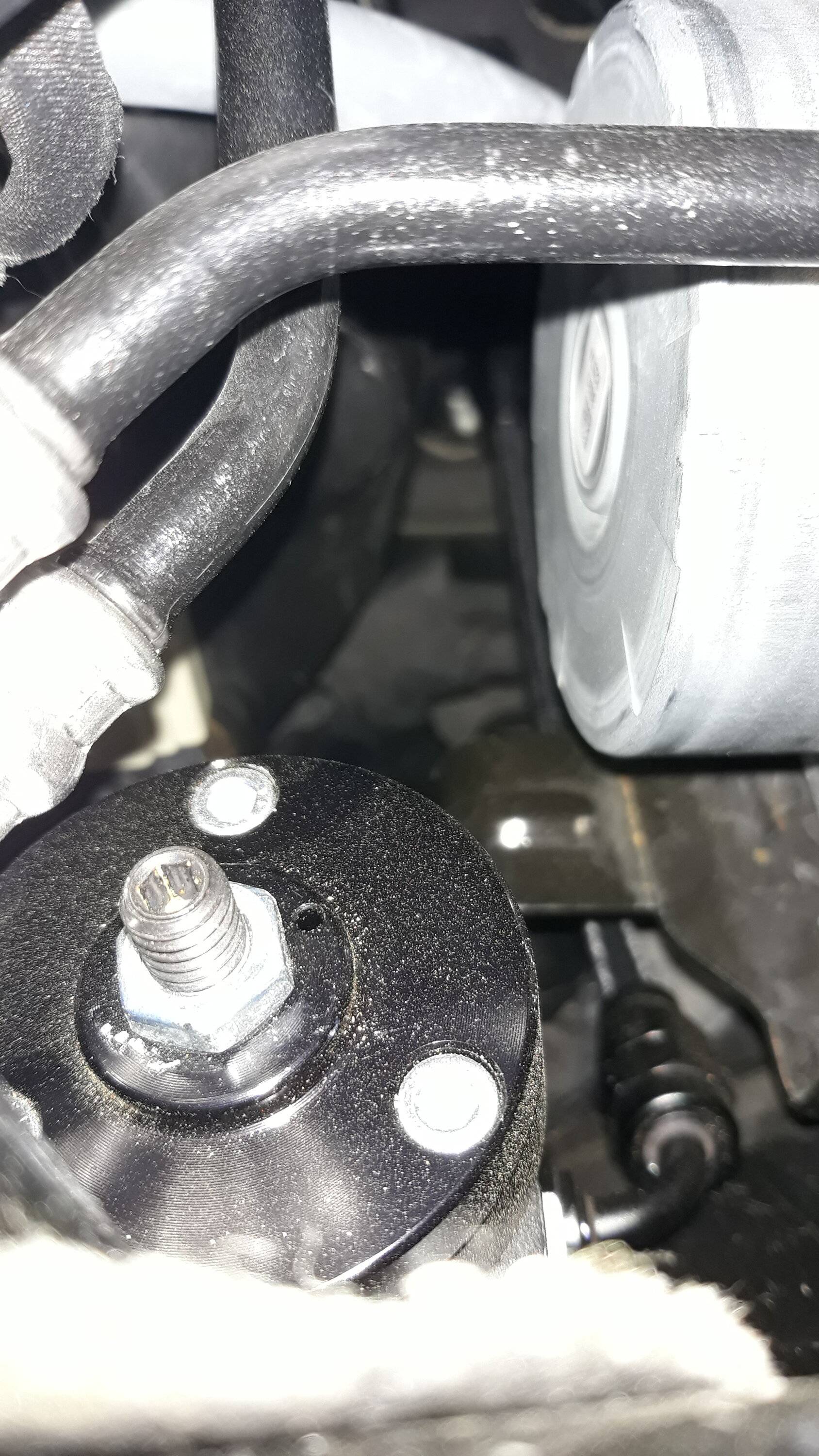

Nice work. I used the same spot but welded the bracket that comes on their valve to a 90 degree angle piece. Valve sits down about 4 inches vs being elevated.

Any pics of how yours is mounted?

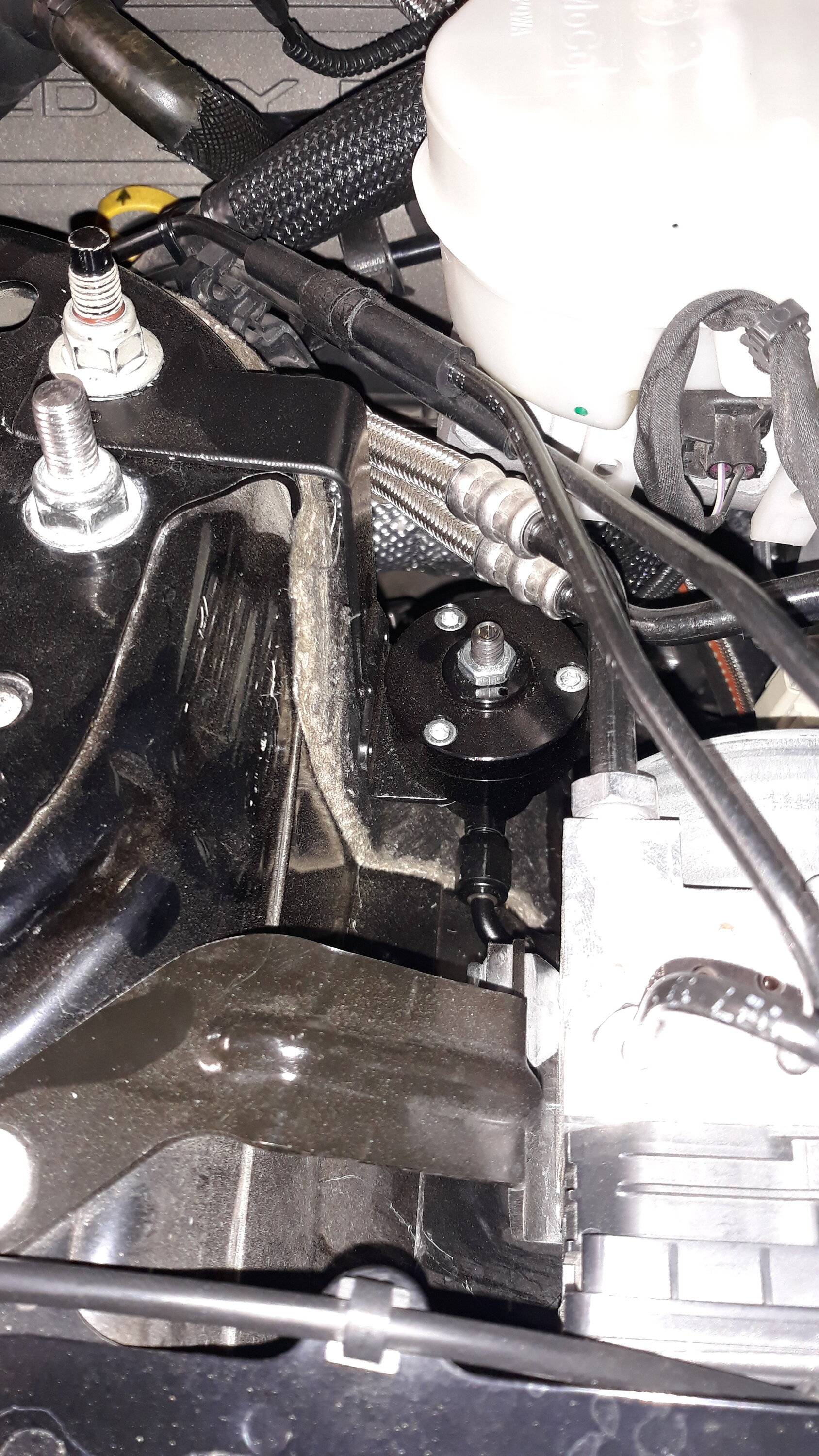

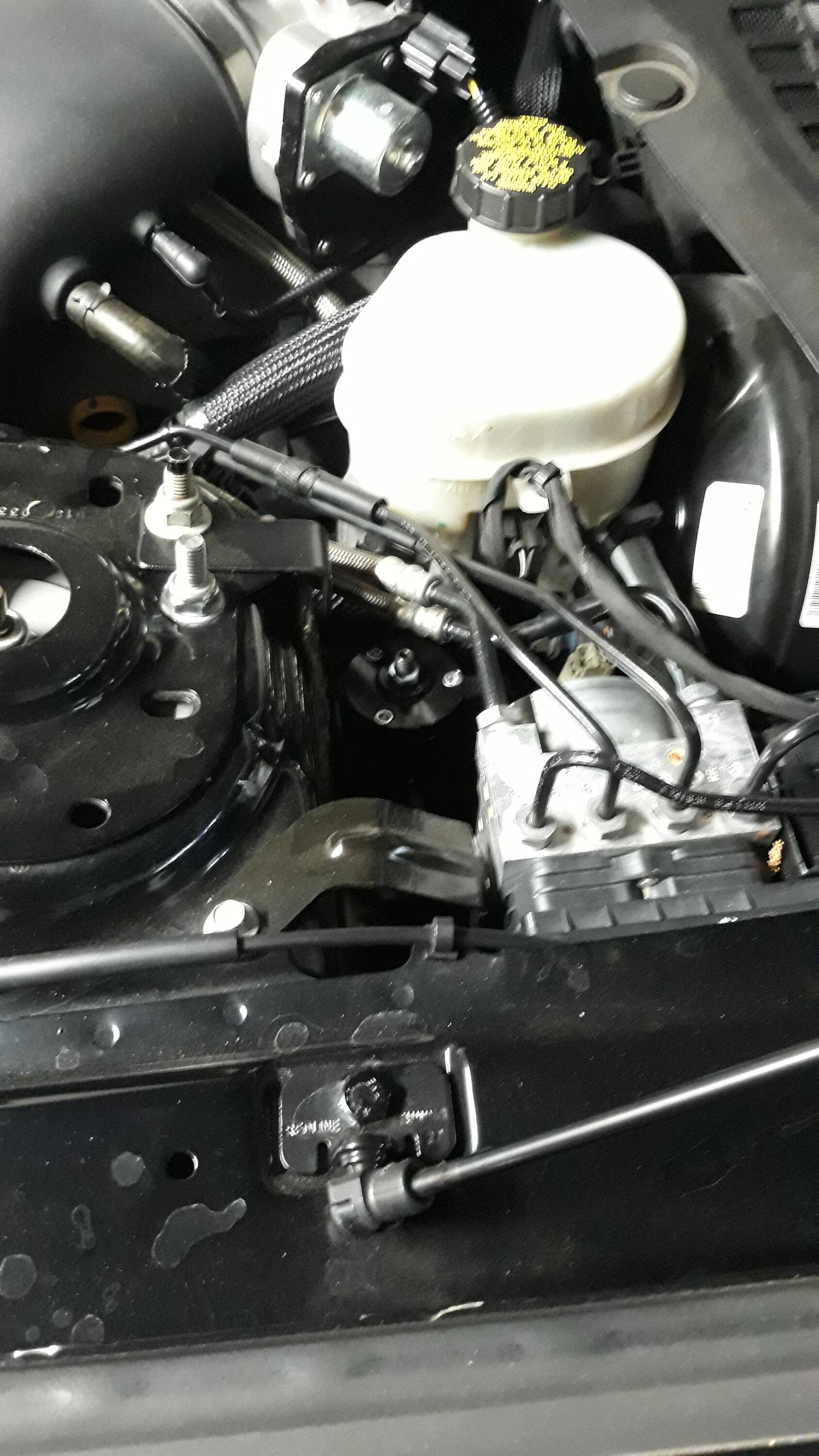

Sure thing. The left fitting is pretty much a straight shot from master cylinder fitting to valve.

Thank you for the pics. Where do you have your bite point set at (low, midway or high)?

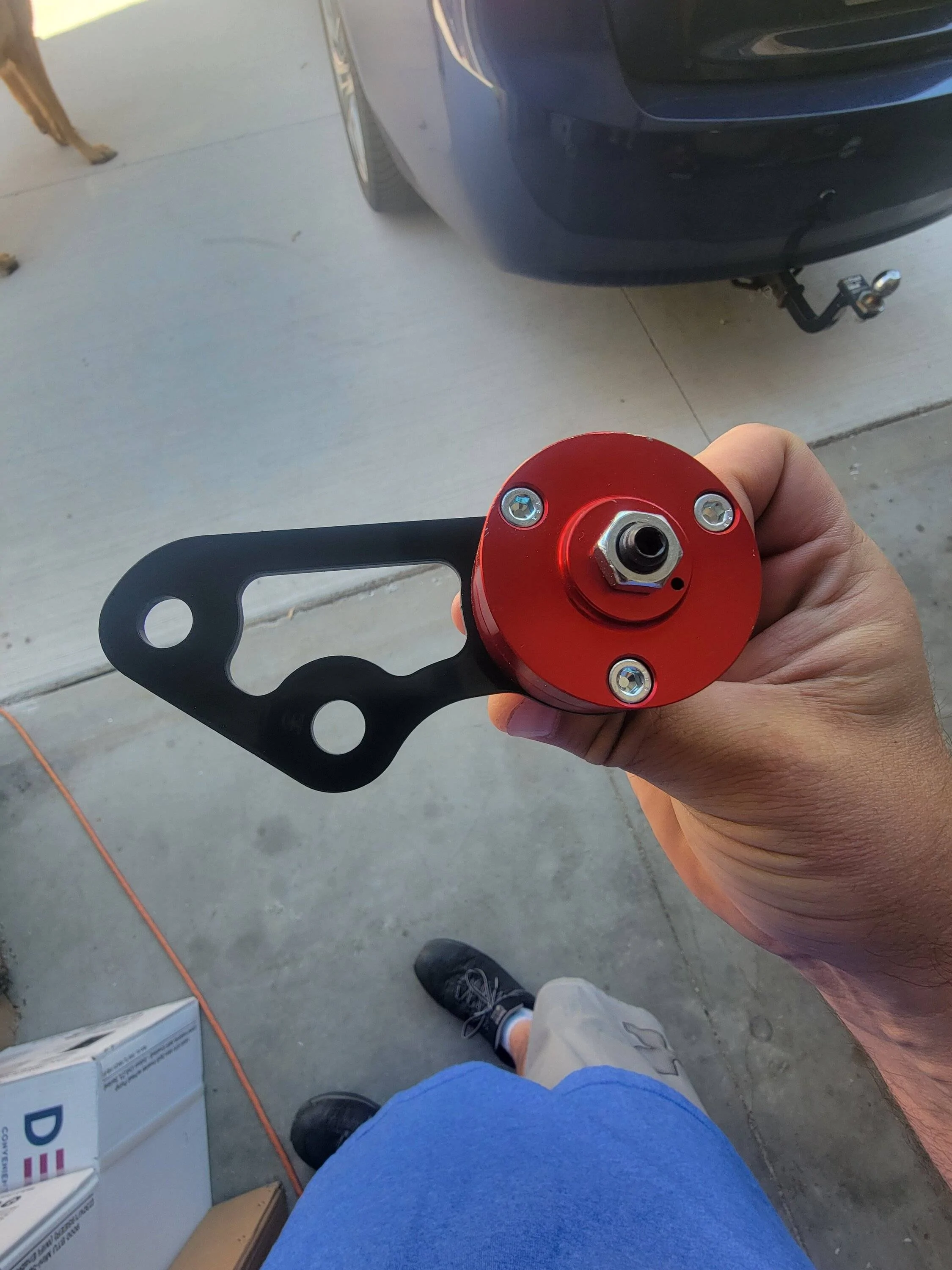

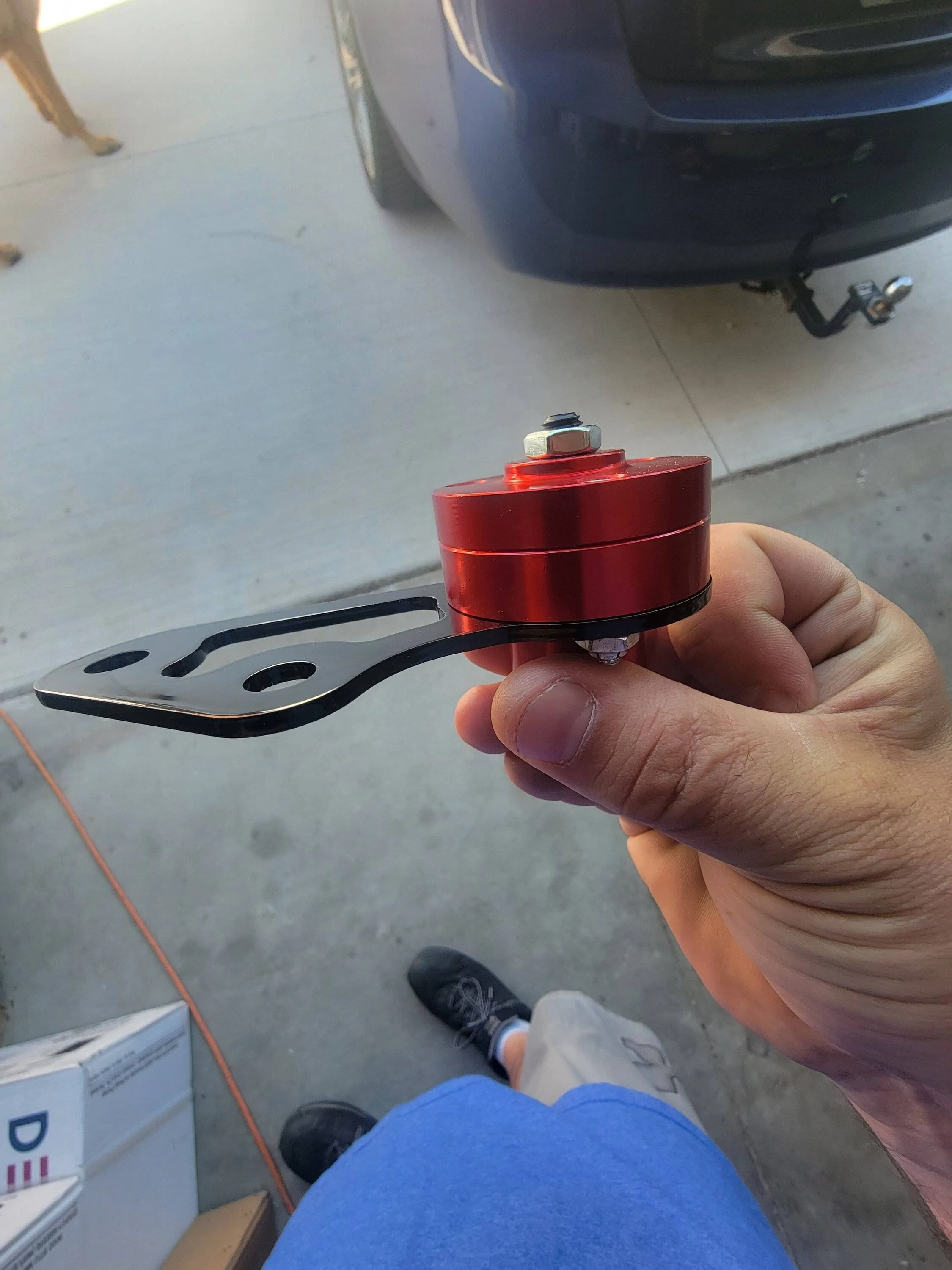

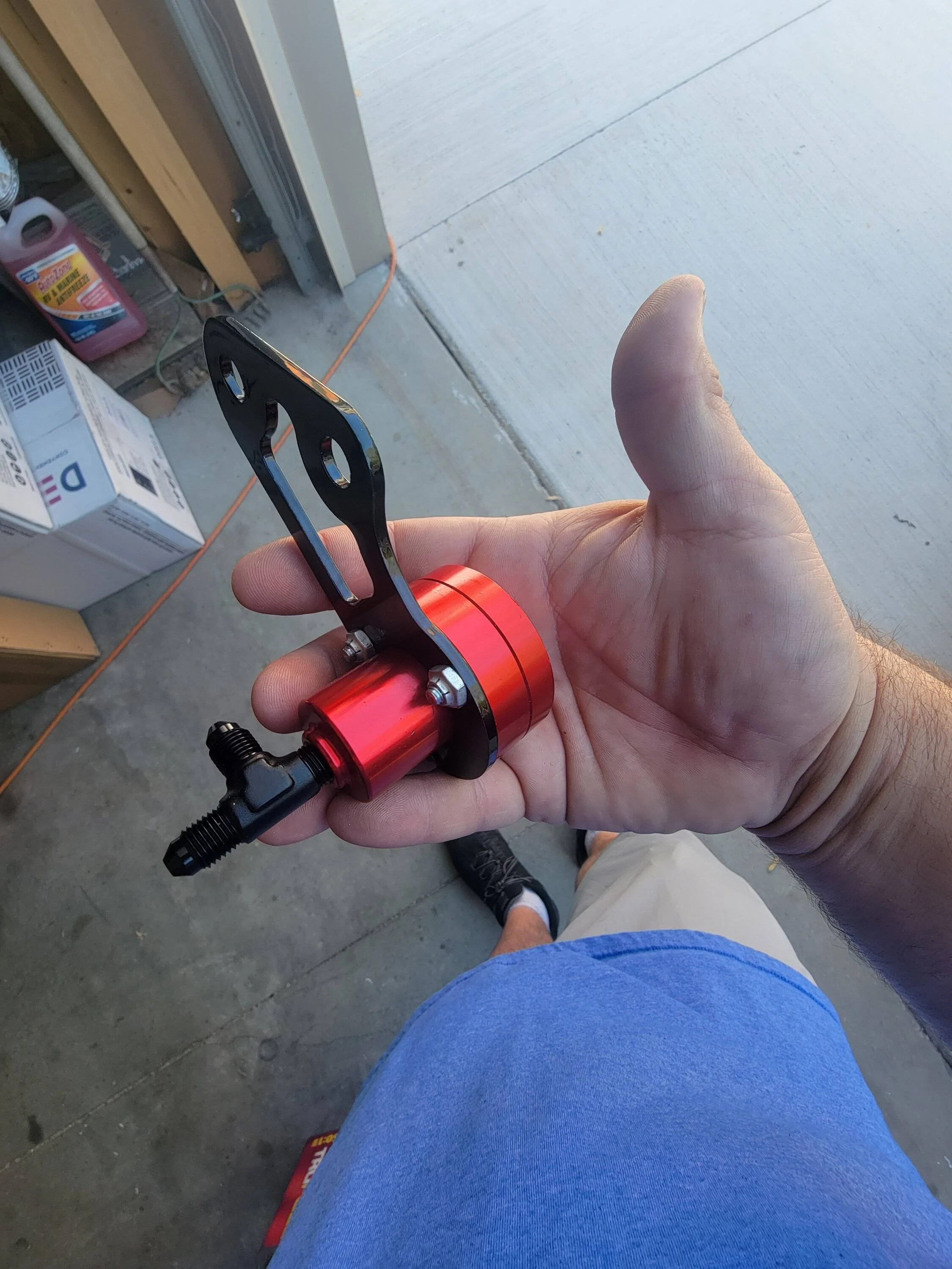

I ordered 3 brackets made and powdercoated black as there was a minimum order. After fitment is confirmed i will sell the other two if people are interested.

Got my brackets in. I like them a lot. 1/8 steel powdercoated gloss black. Got to find out the thread on the strut tube nuts and make/buy a spacer but i think its gunna look great.
