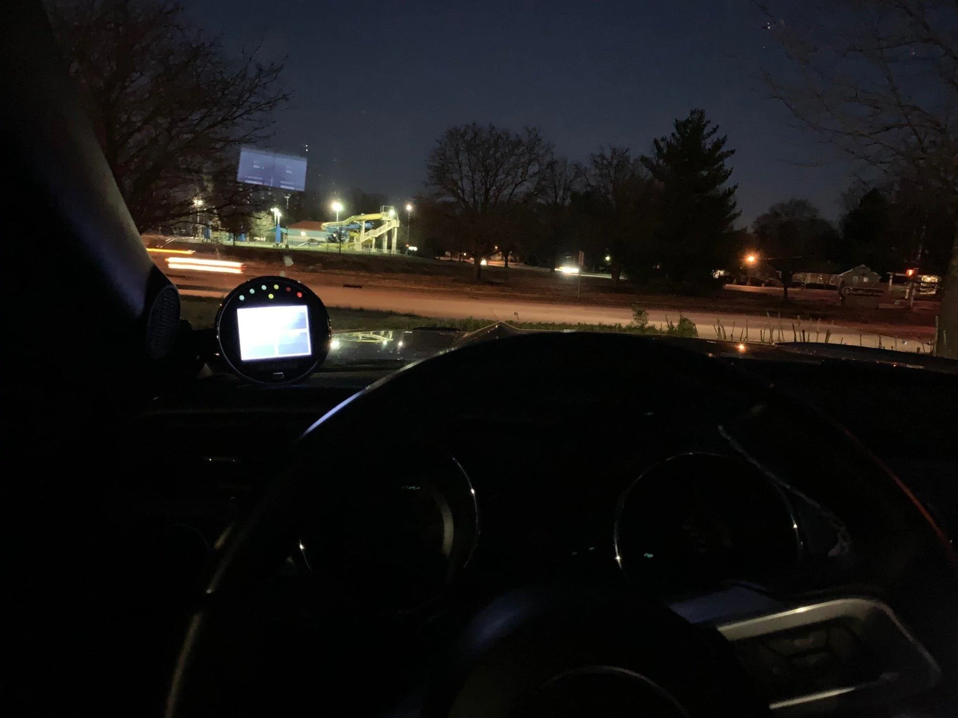

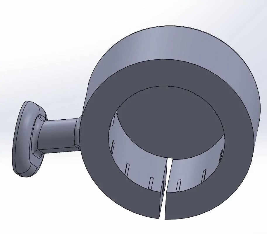

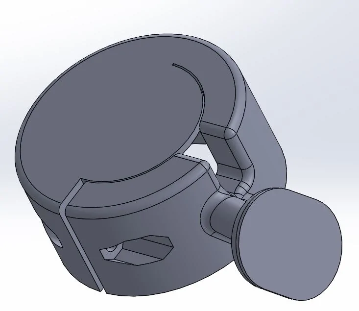

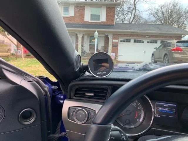

I wanted to put together something that didn't require me to permanently alter my car or affect the airbag deployment, but still give me good visual access to the nGauge. I ended up with this. It's modeled and printed to accommodate the nGauge without the adapter cup (oddly sized, 2" even). The attachment piece uses 2 sided tape to mount to the A-pillar. There's a relief for expansion in the back wall and a place to put a 10-24 nut/bolt for retention. Worked out perfectly, with even a nice canted angle for better viewing from the driver seat. Files are here for anybody who wants to duplicate it.
