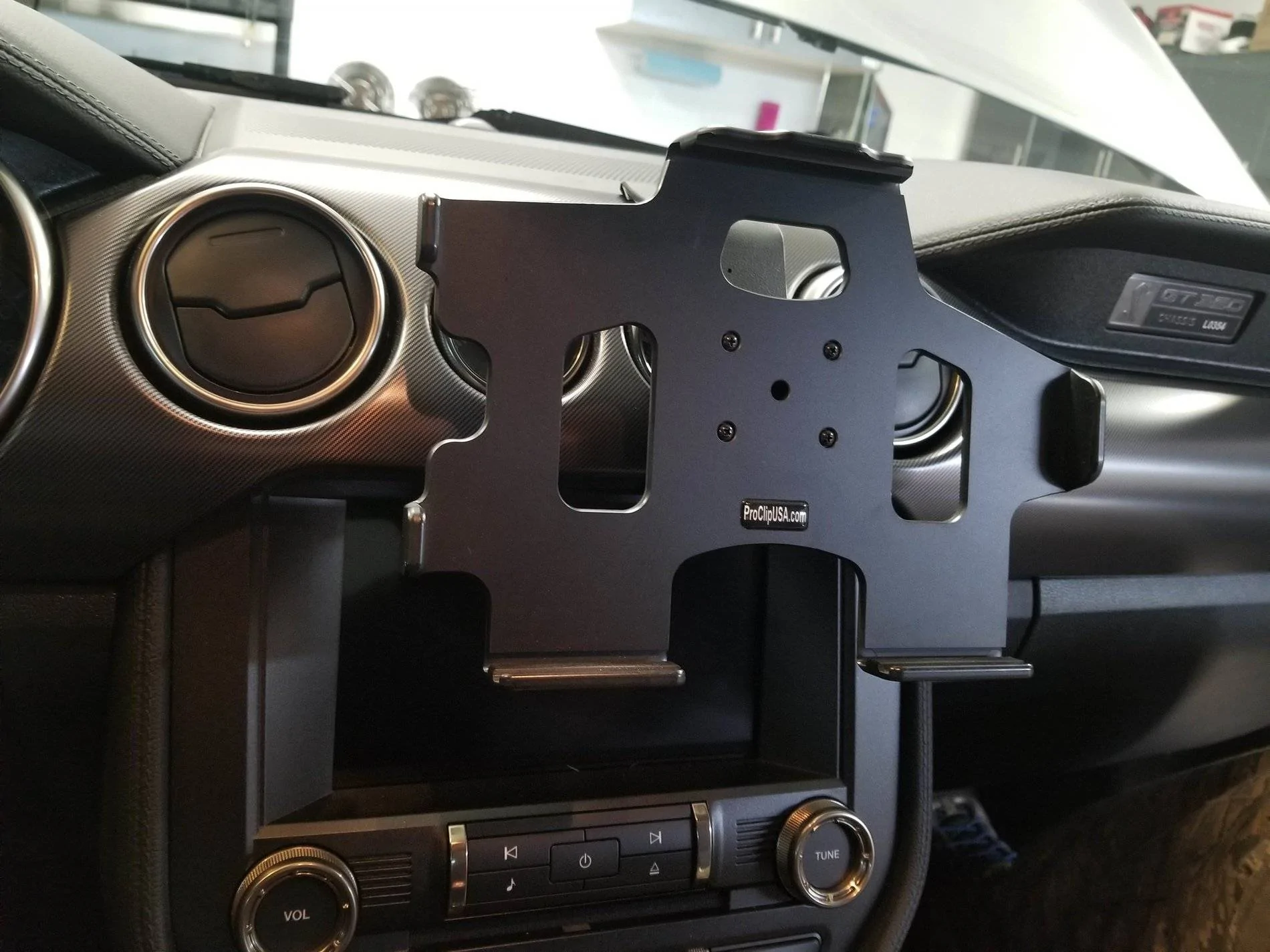

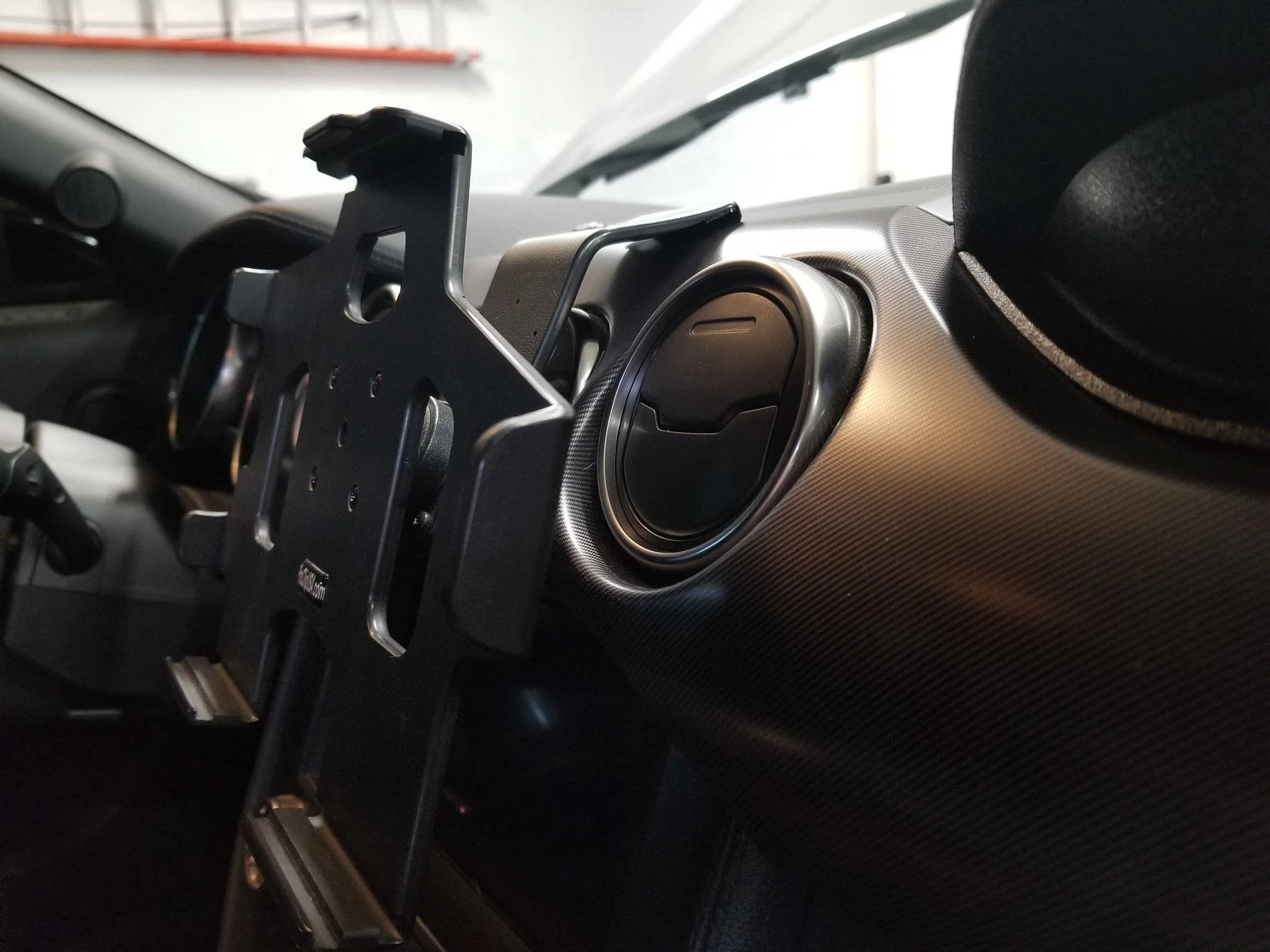

I use the same size tablet for the same purpose and found the ProClip mount works extremely well.
You can see how well it holds in this video:
NightmareMoon
NightmareMoon
Nov 22, 2015
7,211
6,510
Austin
2016 Mustang GT PP w/ Voodoo
Looks like its pretty secure
