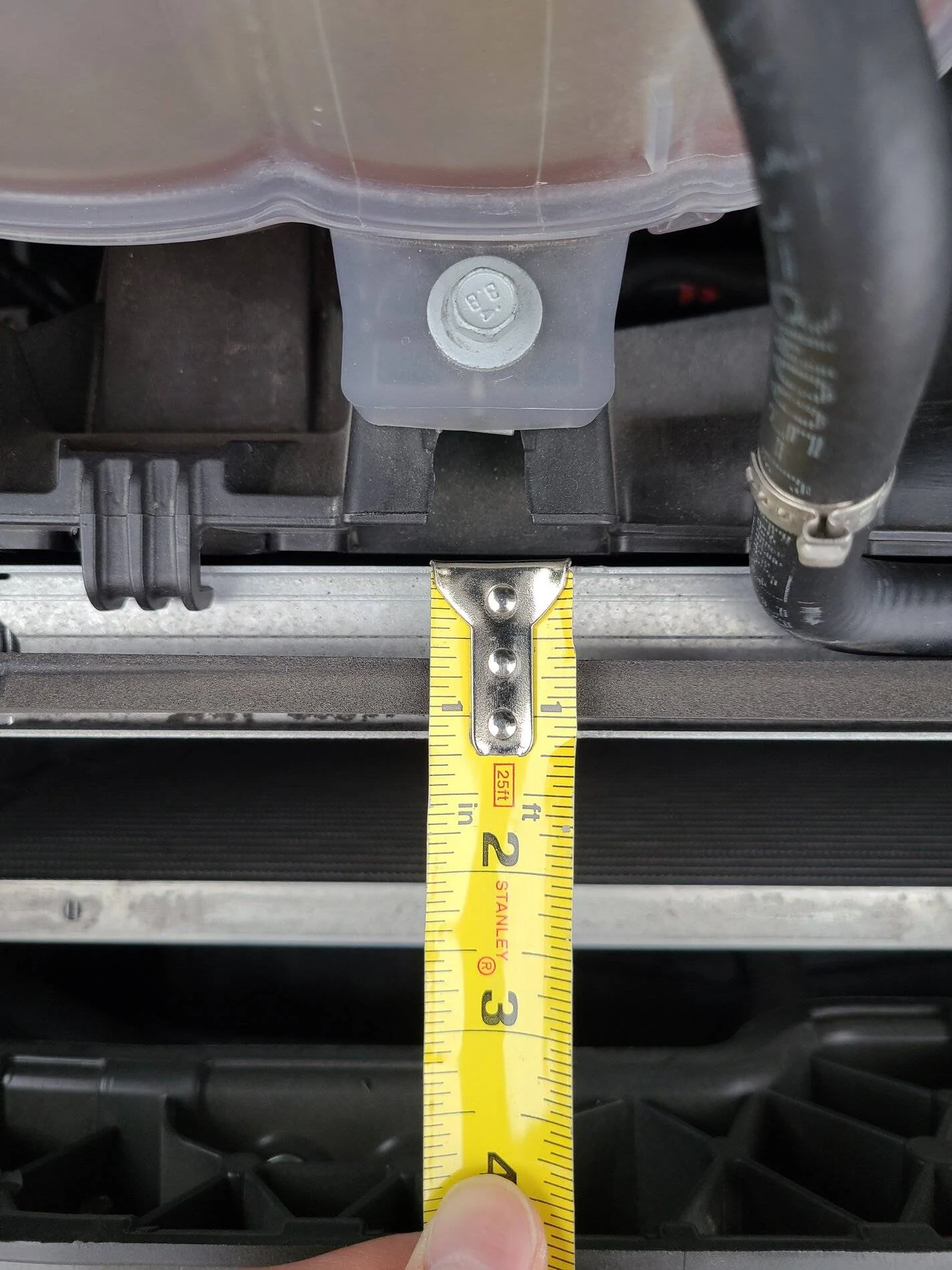

Standard rad is about an inch in thickness, PP radiator is an inch and a half. All other dimensions remain the same. I'd love to see this build sheet because I've never heard of that item before.
Below is the stock radiator.

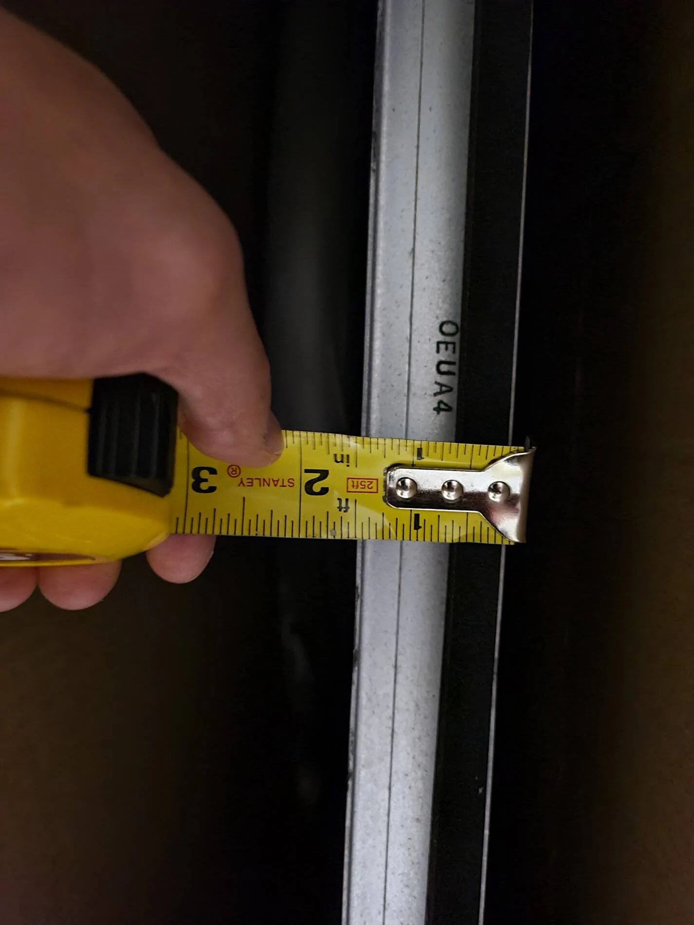

Do you know if it includes the thicker radiator? I have a spare PP1 radiator in a box, here's the proof its almost exactly an inch and a half in thickness.

From memory and thinking of the proportions, I think it’s the thicker one - the hood should be up later so I will check :like:
