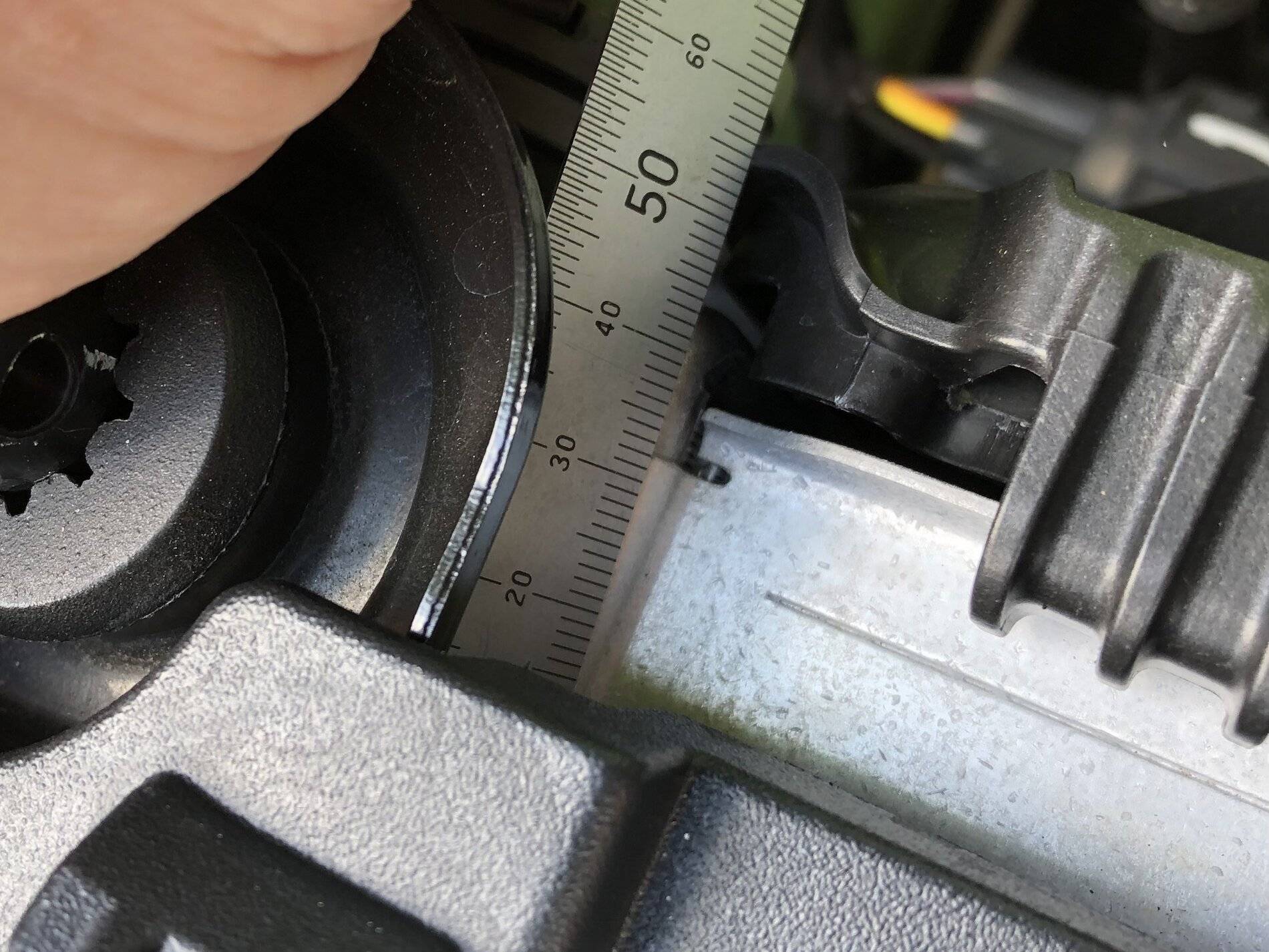

You can just about see the front edge of the rad, without removing the radiator panels and looking down the hole in the panel under the hood strut securing clip.
Lining the steel rule up to the front edge of the road gives me approx 37mm, which lines up with the 1.5" thickness quoted for the PP rad :

Thanks for that - my build sheet gives the radiator measurements as 643 x 502 x 36.4 mm (1 & 1/2 inches) so it must be the PP1 radiator fitted. These must come standard with cars built for Australia/New Zealand and possibly Europe as the build sheet also says 'standard cooling system'. It is great to find all these things out as I am very new to the Mustang world. Have owned Mercedes-Benz for 40 years. First car of a different brand for a very long time! But the looks and sound of these cars are like nothing else.
