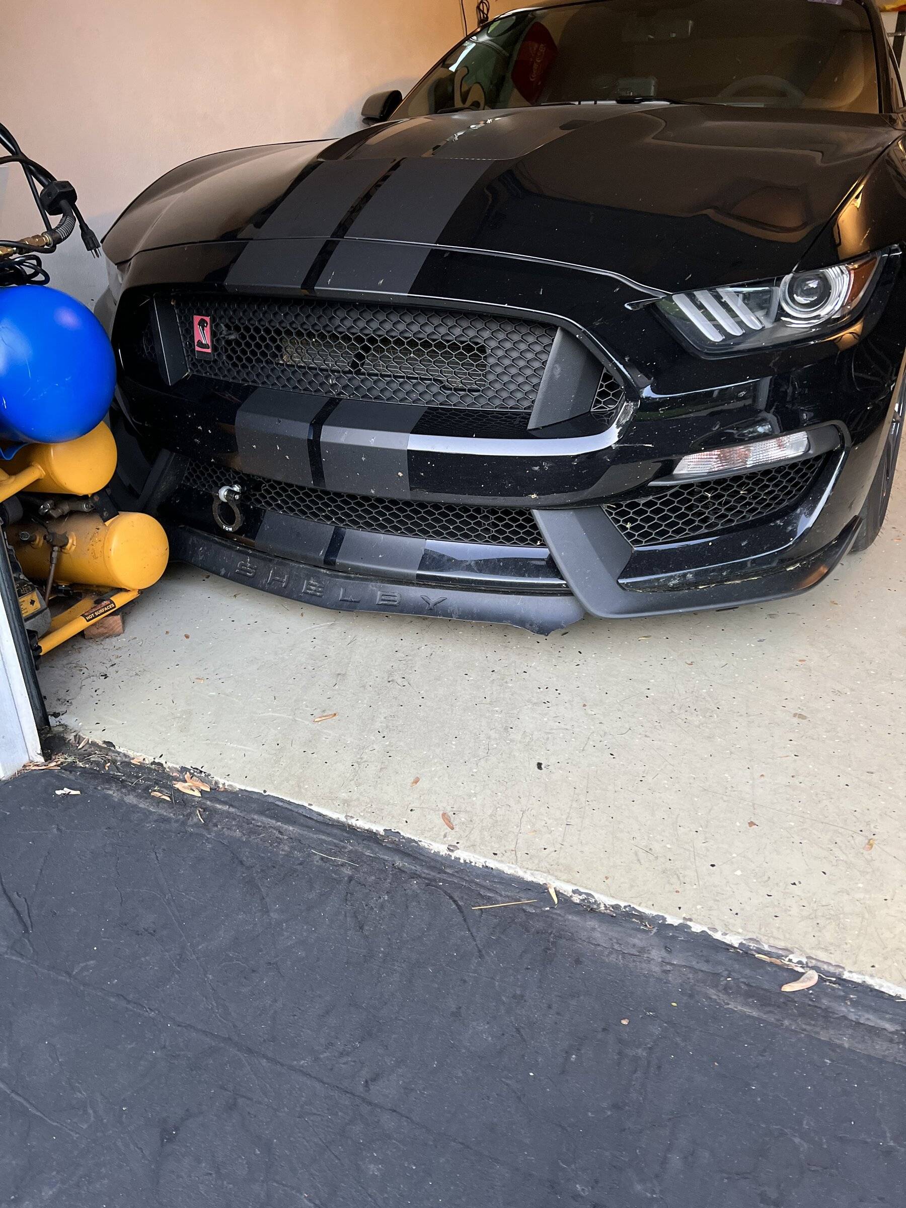

How silly of me :)
As the car rotates backwards, you’ll see lots of grass flying through the cabin from left to right. I had grass in the back window, headliner, everywhere. I just got done cleaning that out and unfortunately didn’t snap any pics.
This is the best pic I have. The center portion of the grill doesn’t look horrible, but you can see it bunched up around the margins. Ohh…. And the splitter cracked and 1/3 missing.
Looks like a bumper removal is in my future.

Wow - you weren't kidding about the grass clippings flying into the car! Glad it wasn't worse. Yep - I'd pull the bumper and inspect everything, clean and re-install.

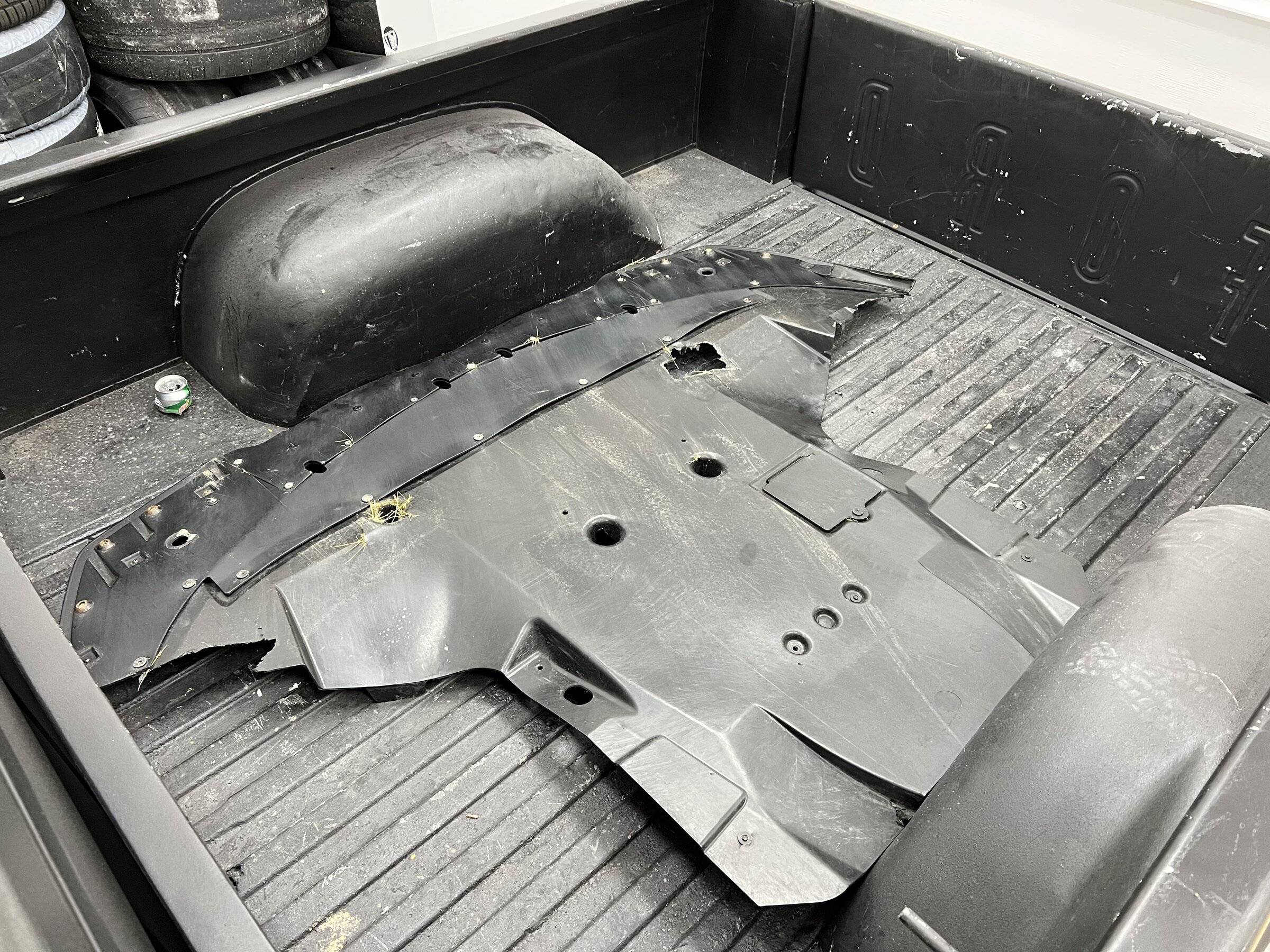

Forgot to add the pic of the belly pan (which they found in the grass where the car came to rest). Other than there being a hole where an attachment point was, it doesn’t look horrible.
