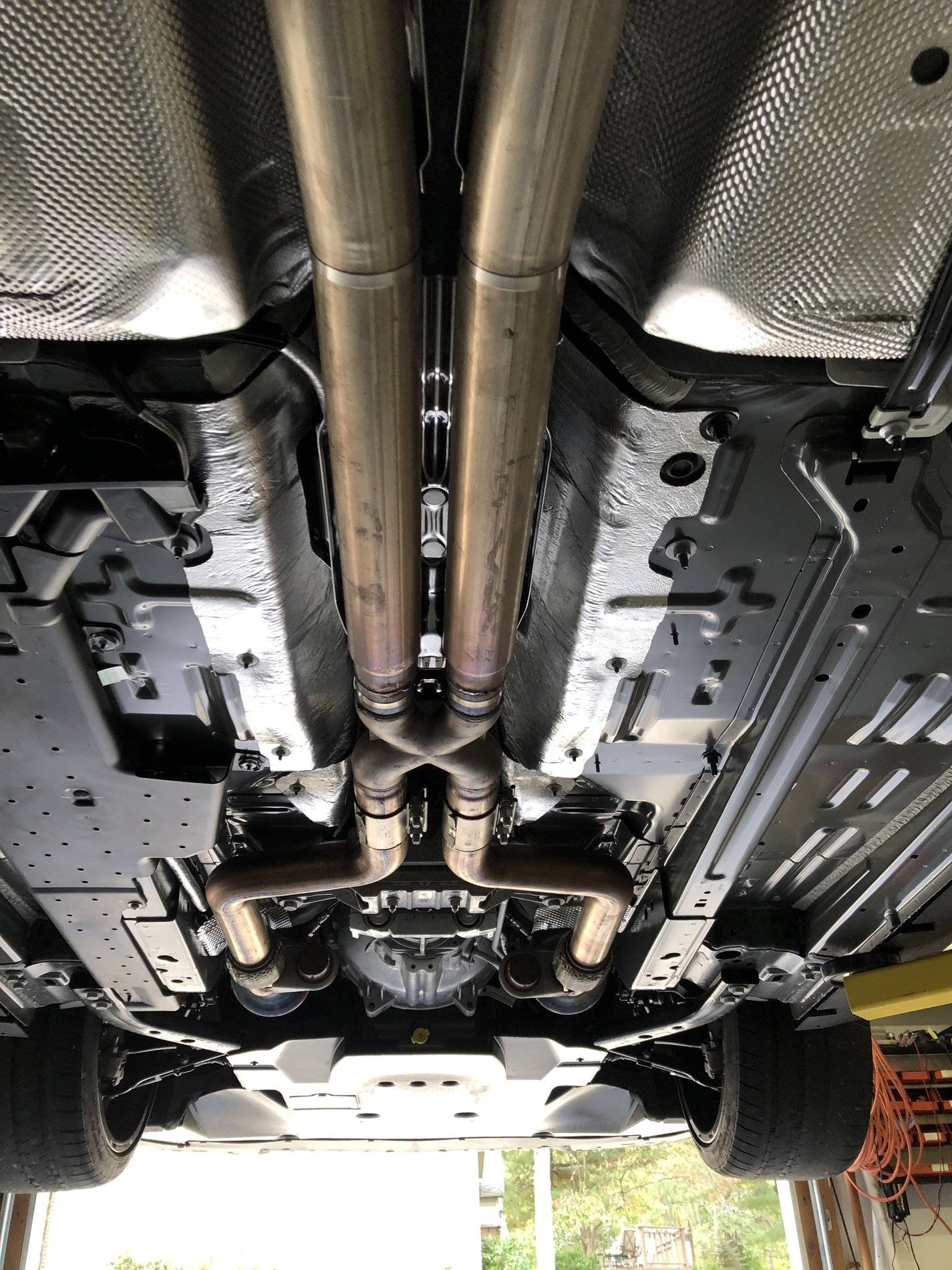

Anyone that has an R model, what did for do with the res delete? is it straight piped? X pipe? Whats the pipe diameter if I wanted to replicate?

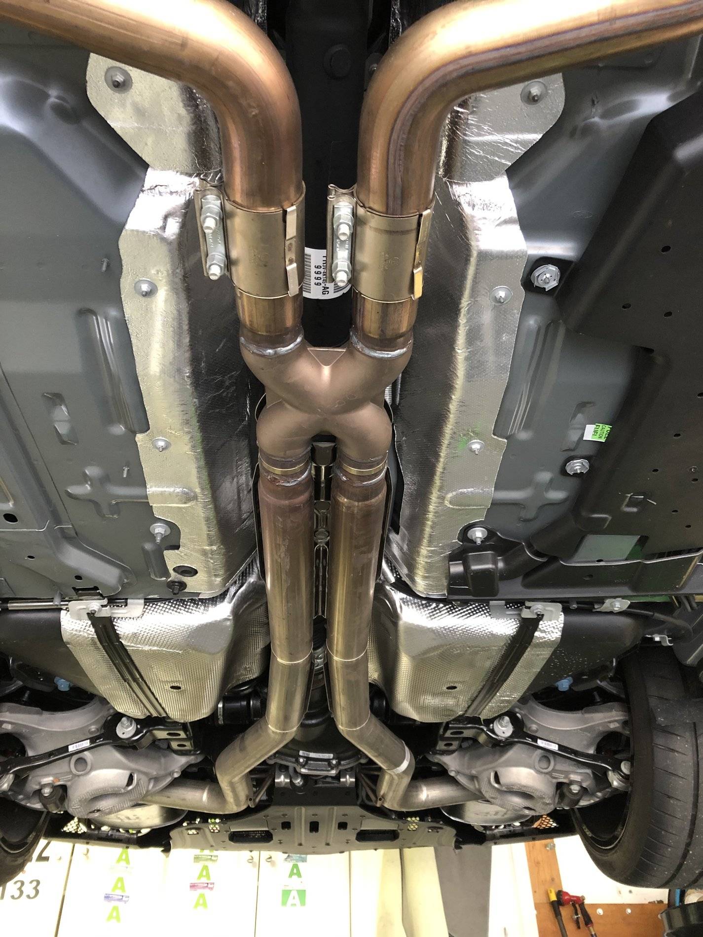

Here's a pic. The diameter looks to be exactly the same as the rest of the pipes.

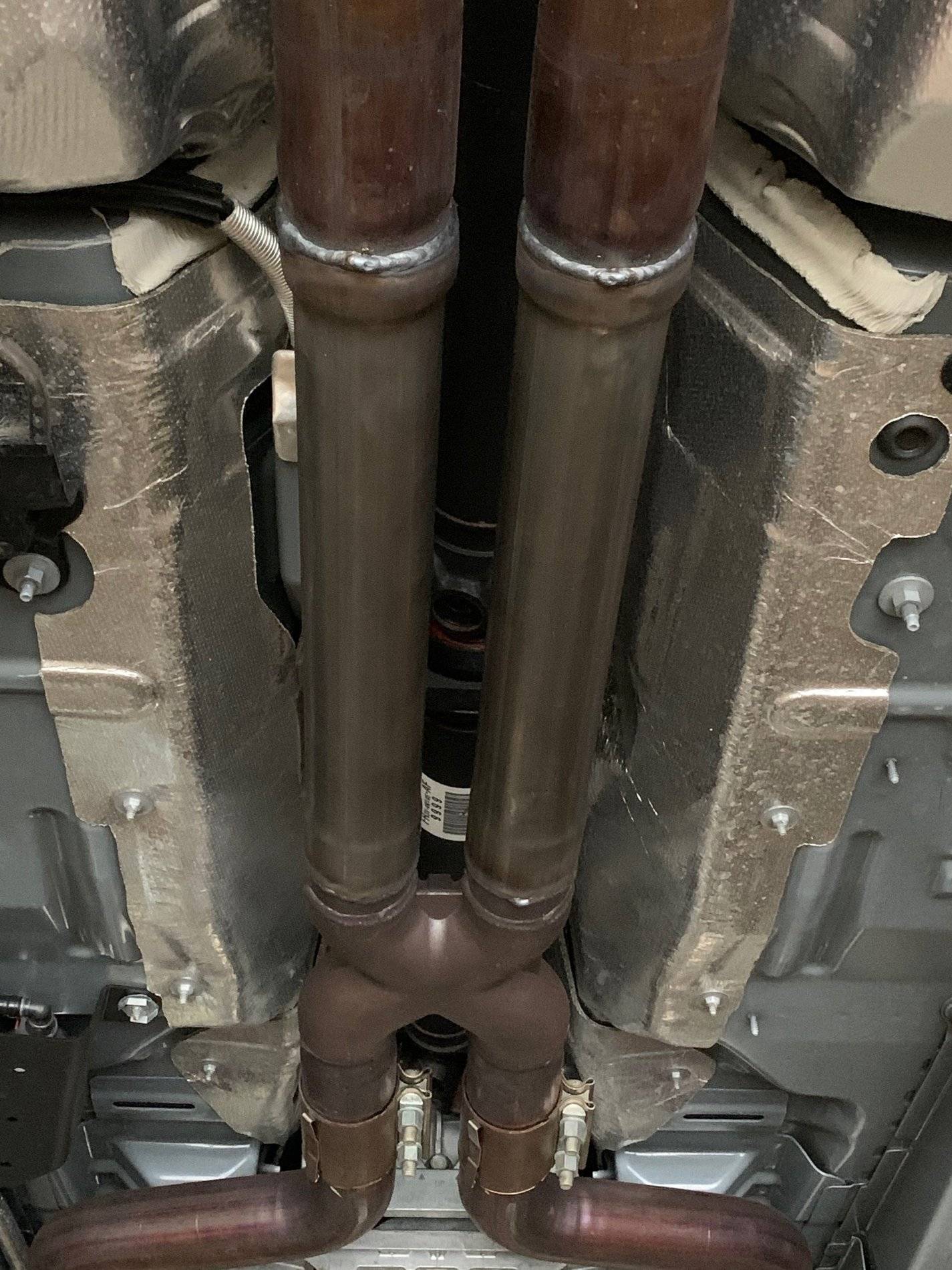

I replaced resonators with straight pipes on my GT350. The diameter of straight pipes on R is 2.75".

Any droning at all? did you have a muffler shop do it? what was the cost?
No dronning. The guy who own muffler shop cut off resonators and welded straight pipes for $160 out the door.

Are you sure its 2 3/4in? I just left a muffler shop and gentlemen said that's a very odd size, they would have to check to see if they can get a piece of that in stainless. Was it a 3 inch pipe they reduced at the tips to fit? He was trying to talk me into replacing my entire exhaust, maybe he didn't want to be bothered with a small job..
Were they able to reuse heatshield?
You may double check on the pipe size. No heat shields needed and I don’t have them on my. Make sure this guy can do good welding job. You don’t want hole in the exhaust.
