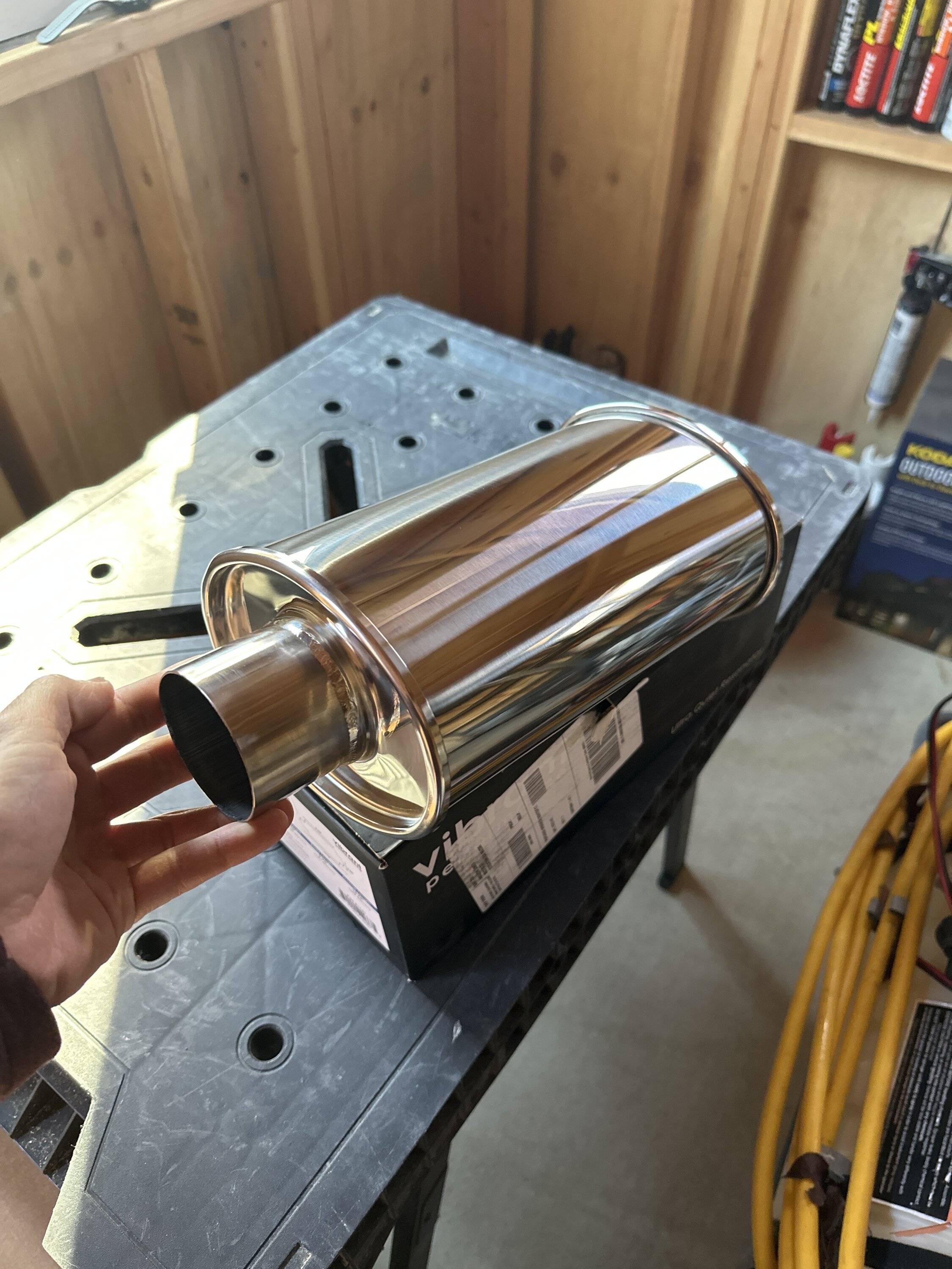

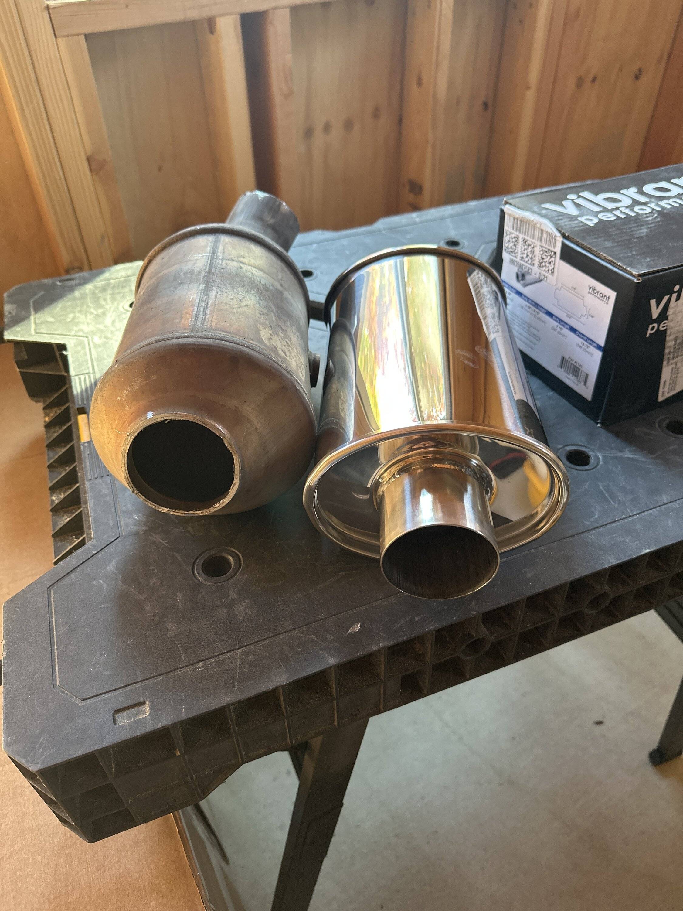

Thanks. The ones I'm talking about are these:
They are essentially a mini muffler. I don’t think it will be night and day but realistically if I can cut about 20% of the volume and rasp down I think that would get me where I want.
Oh yeah, I see. Those do look like they should quiet things down a little for you. Are they close in size to the factory cats?

Ya, they are definitely close. I think you may be able to get them mounted close to the stock cat position, but it could take some custom bending to make sure they clear everything.

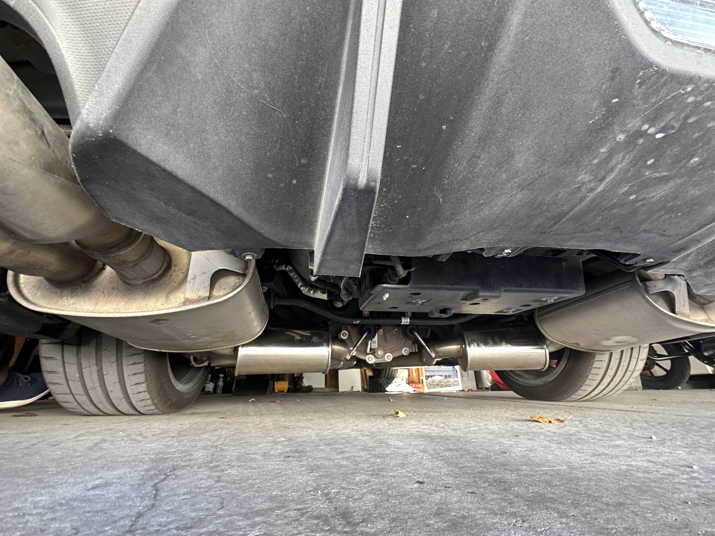

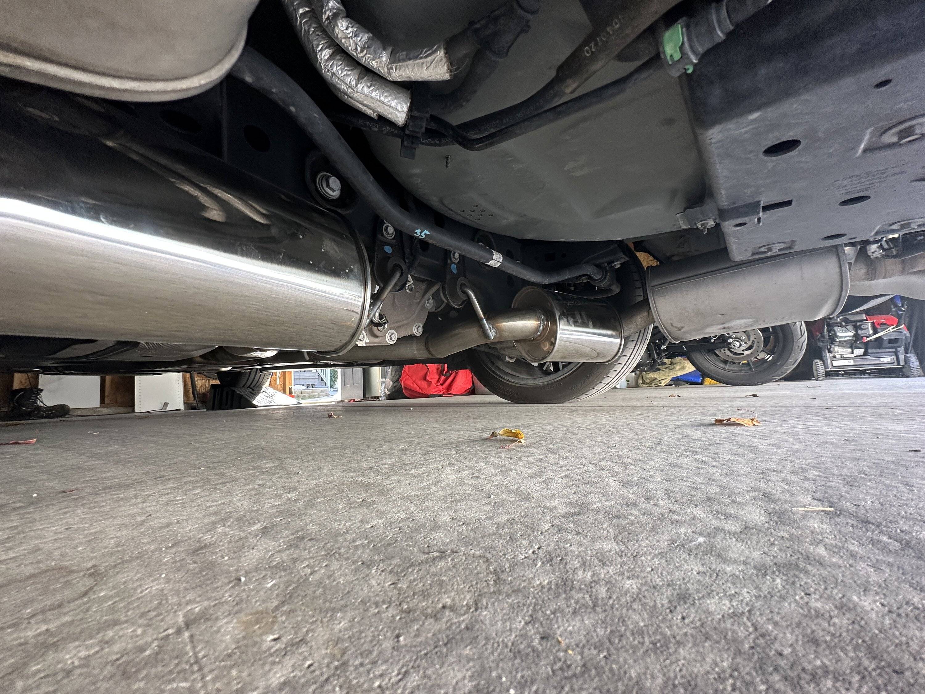

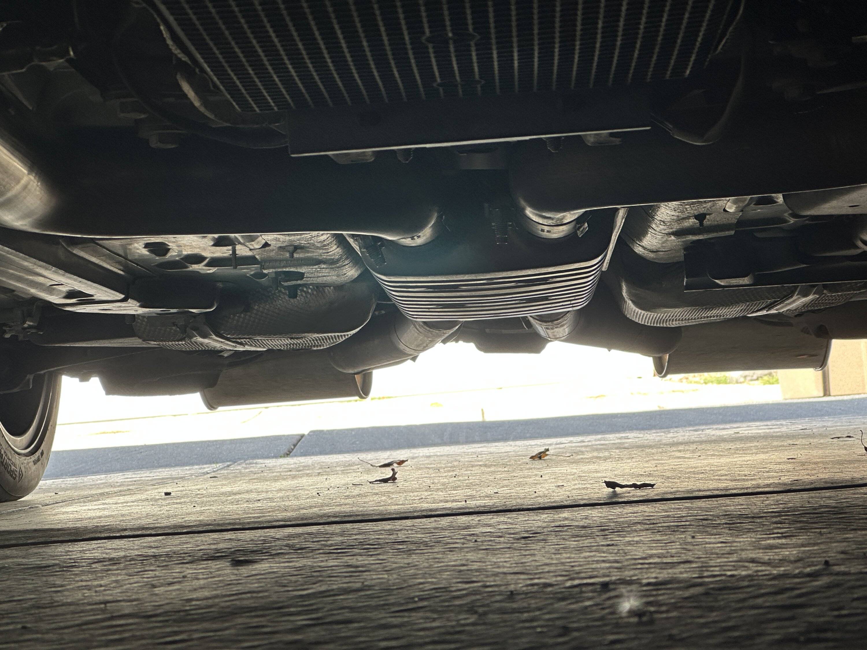

Happy to report that the ultra quiet resonators did the trick. Since sound is subjective in terms what what people consider loud or sounds good, I would say the volume is very similar to the stock active exhaust. Due to the resonators and the tone, I would say in some place it may be a touch quieter due to a slightly different tone at WOT it may be just a hair louder, but overall, it is really close which is what I was going for.
So if anyone else is out there trying to do the same, this would be worth a shot. Here is where I put them:

Looks like plenty of ground clearance. Could you have rotated them for even more clearance if desired, or would that have caused interference with the sway bar when jacked up? My right side axle back pipe kisses the sway bar when I have it in the air on my lift, but once it’s back on the ground I have about 3/8” of clearance.
Can you get us some sound clips of cold start, revving, cruising and WOT?
