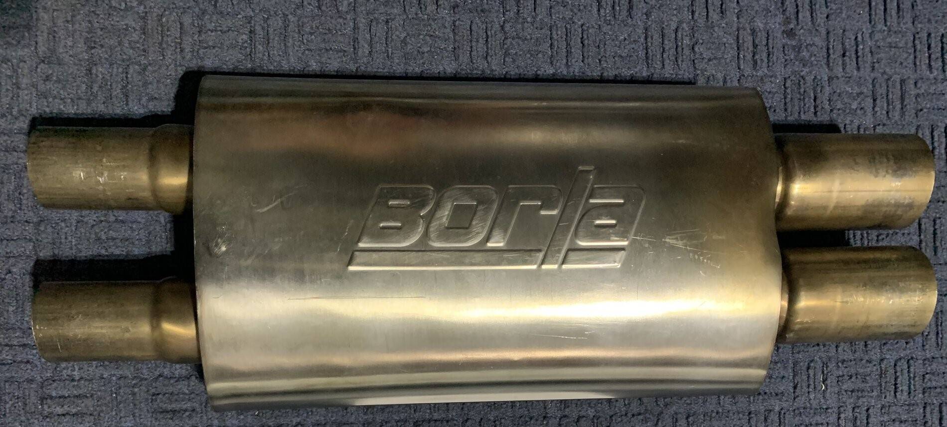

Hey this is Junior from N4SM, Borla exhaust sells a resonator that is a straight through design so there is no restriction in air flow. At the same time it quiets the car down a good amount. That might be what you are looking for.

Thanks junior, what I haven’t been able to get a solid understanding of is if the Borla or Magnaflow resonators are quieter, louder or about the same as the oem resonator. I’ve read comments from people that vary wildly on that.

Your car should not be pulling 3 degrees with them shut then adding 3 degrees with them open. The borla resonator will be similar to stock. Magnaflow use to make one that was slightly quieter. What you have now will be one of your quietest options.

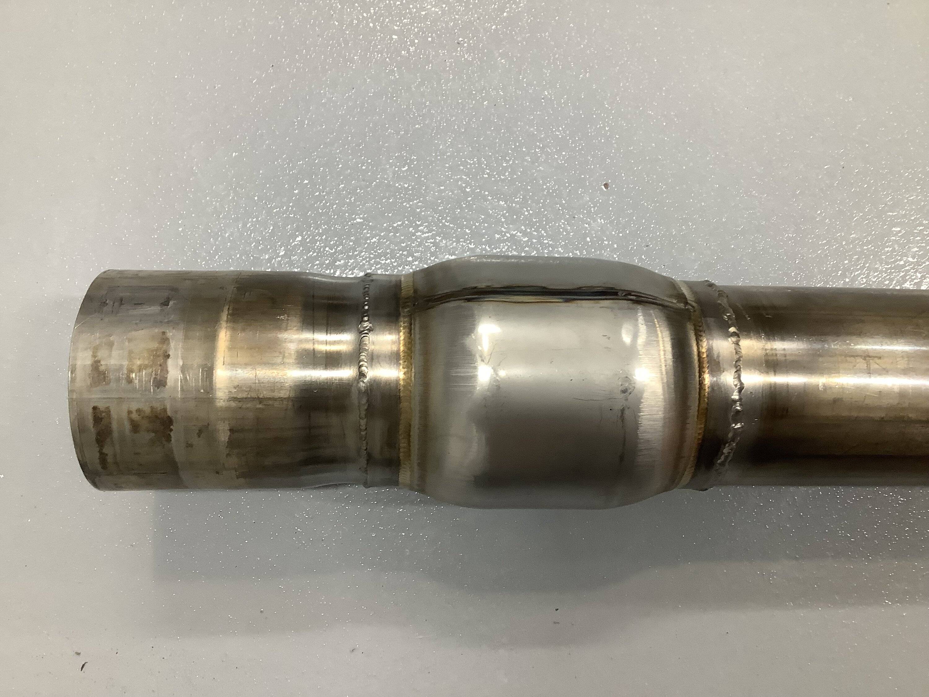

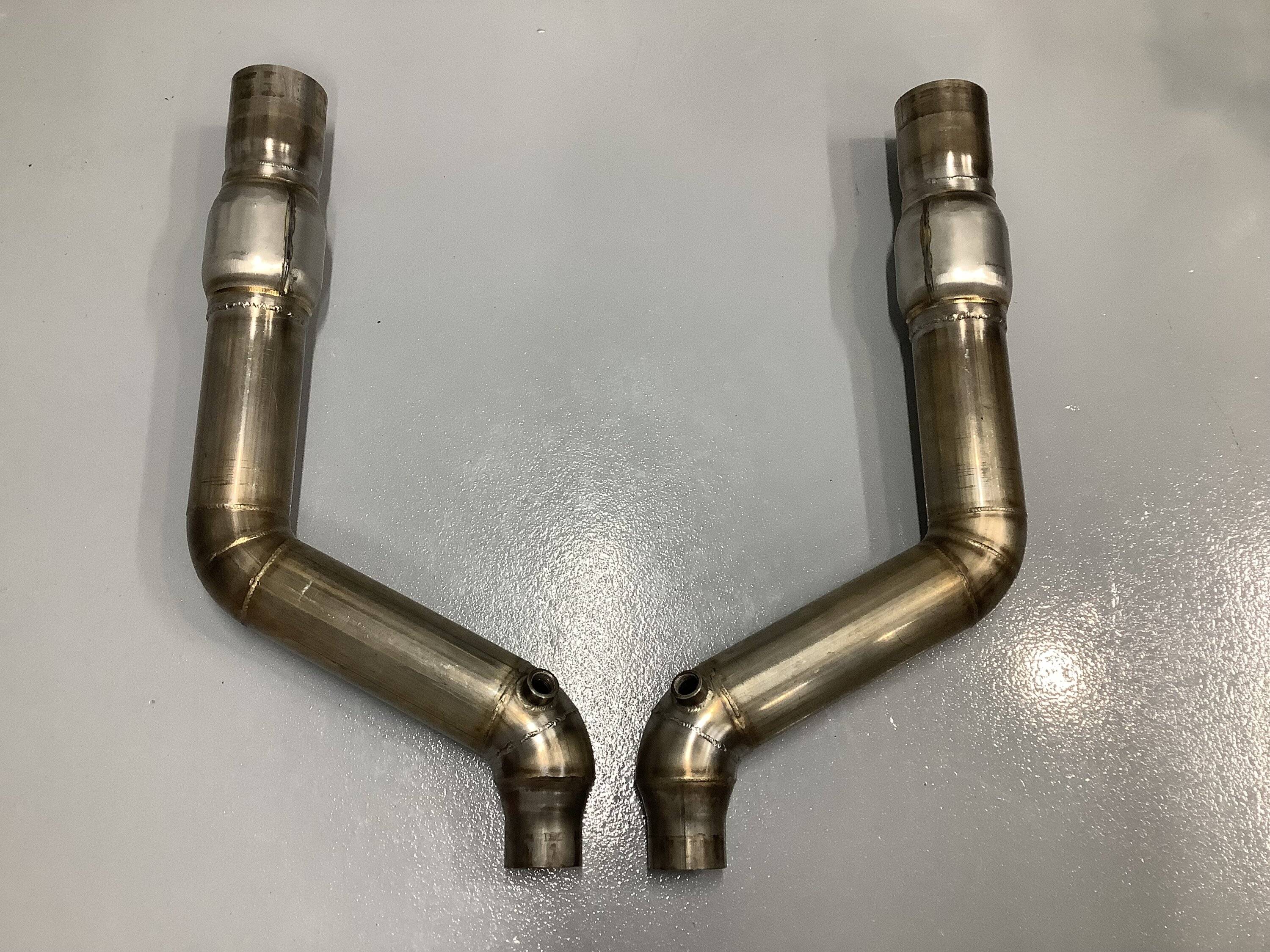

I had the Vibrant mini race mufflers (as shown on the intro of the last YT video that @djcodeman posted), welded into my mid pipes, when I blew out my cats. My car is definitely a little louder now. I honestly don’t know of much else to do to quiet mine down, other than maybe installing something like Dynomax street mufflers and perhaps cutting open a factory resonator and filling it with high temp exhaust packing and welding it back up. Problem with that is, packing wears out over time, so the process would need to be repeated to maintain the desired level of quietness once achieved.
Mine with Ultimate Headers LTHs, Vibrant mini race mufflers welded into mid pipes, Steeda x-pipe and Steeda axle back.
