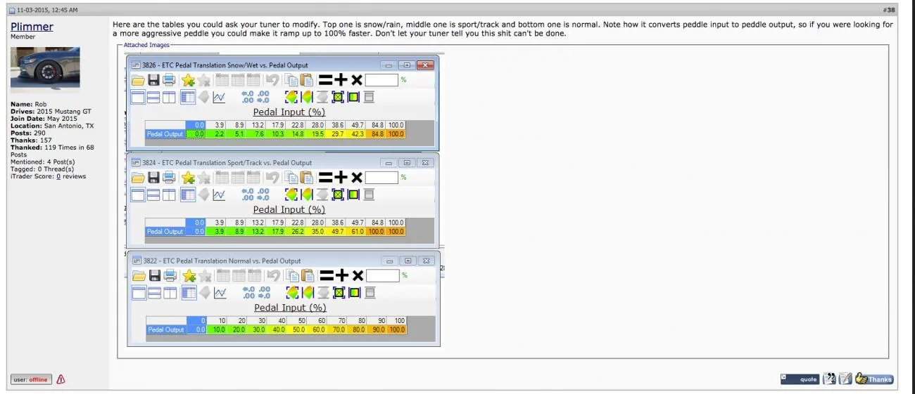

Since you know soo much, explain to me how Sport mode and Track mode work vs how the Pedalmax works and what the difference is. On the manual trans that is.
As you can see from the image above the only thing that switching drive modes does to the pedal is change the inut vs output. In track mode at 85 percent pedal press you get an output of 100 percent giving you a deadspot at the end of the pedal just like the pedalmax. Normal mode gives you a 1to1 ratio just like throttle by cable. Whether the ecu eases up on torque management after it receives the pedal signal in track mode I dont know. But we do know the pedalmax doesnt alter the ecu so it still does what it wants to after the signal gets there.
Personally if I had drive modes I would ask my tuner to give me me 1to1 ratio in all modes and disable all torque management at the software level.

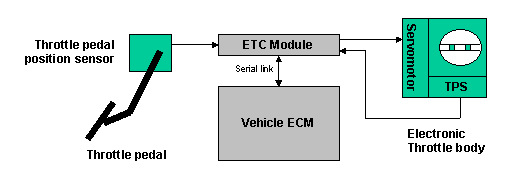

The pedal does not connect to the throttle body. It connects to the ecu which then connects to the throttle body. Sprintpedalboostermax has no effect on throttle body response.

And this is where the false assumption lies. Once you understand that pedal itself causes zero lag you can understand how the pedalmax works.
So youre telling me that if you install this pedalmax between the pedal and ecu, it will take the pedal signal and get it to the ecu faster? Can you please explain how this works?
If you are going to quote me atleast stay on the subject line I posted and address that. In a drive by wire system with a brush resistor contact patch that then sends the signal to a solenoid yes it does have a delay. Anytime a signal has to be sent anywhere and make communication with something else that then has to relate that to another point creates a delay. You stated once you push the pedal on our factory drive by wire system it is an instant response. False! The only "instant" response you will get is drive by cable throttle system.
