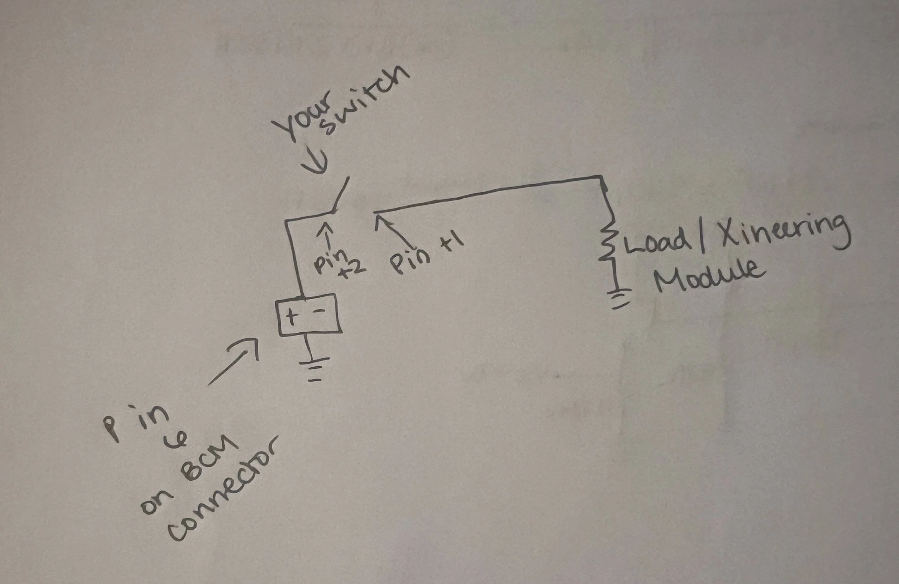

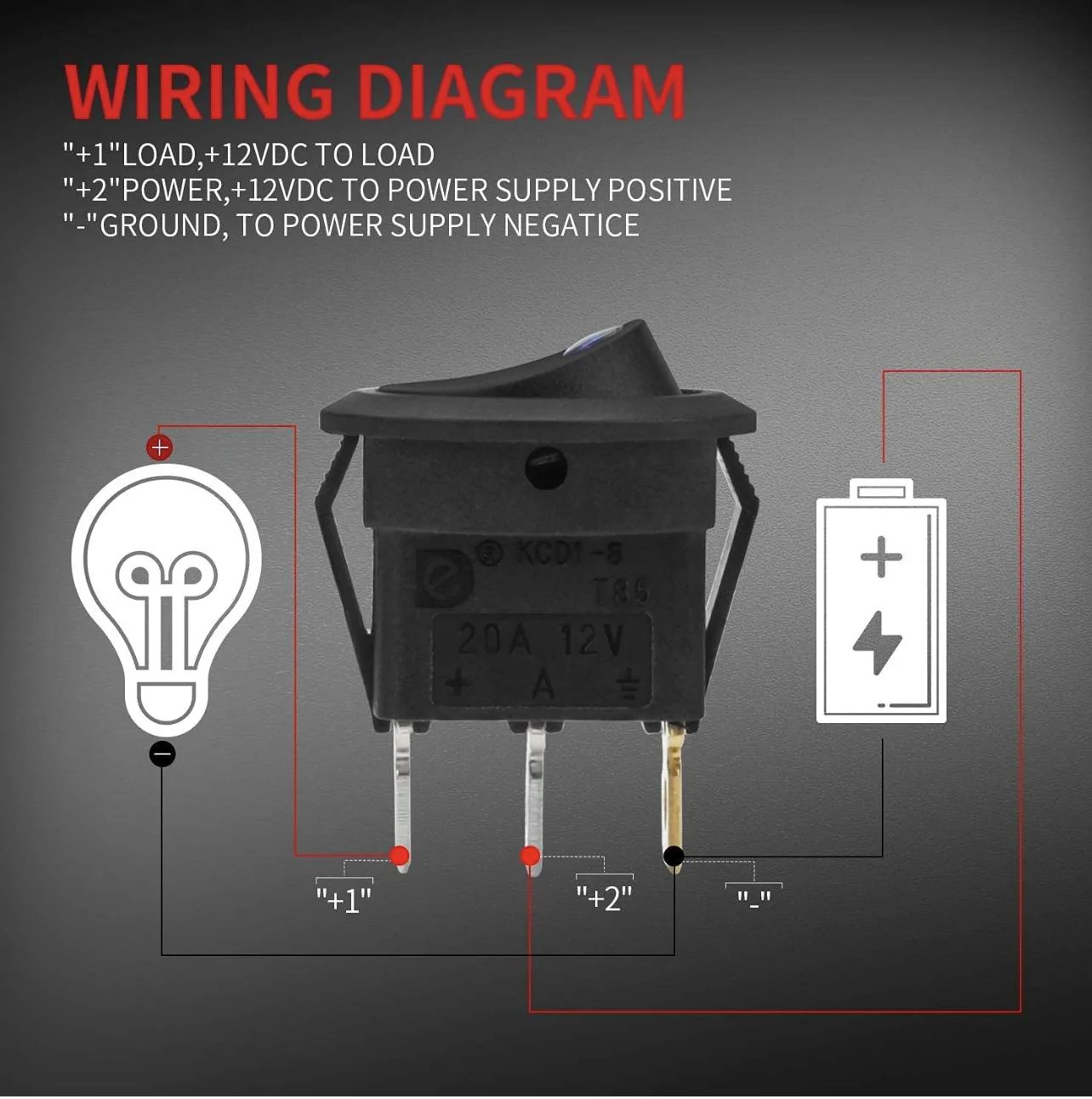

So the “+1” pin goes to the orange wire which as you know it connected to the module already
“+2” pin is connected to the power source. You can choose where you want to grab it from. You mentioned the temp sensor before. I routed mine back to the BCM which is the harness in the instructions. Also as some mentioned in this thread that they did a fuse tap to that fuse box at the presenter footwell. You can choose where you feel best.
The third pin “-“ is the ground which again you can choose where you want to wire it to. I again went back to the fuse panel and found a bolt. I ran the wire with a ring terminal to the bolt there. You may be able to pick up the ground from the temp sensor.
I really hope that helps. Just want to move the current from the car power source to the module.

Thank you that makes total sense now... I will need a length of wire to run all the way back to the BCM if I want to draw power from there.. otherwise I might just tap the Temp Sensor wire and see if that is sufficient.. it's right there behind the panel, so I think I would rather just get that connected without having to remove kick panels and access the BCM.
Exactly. You got it.

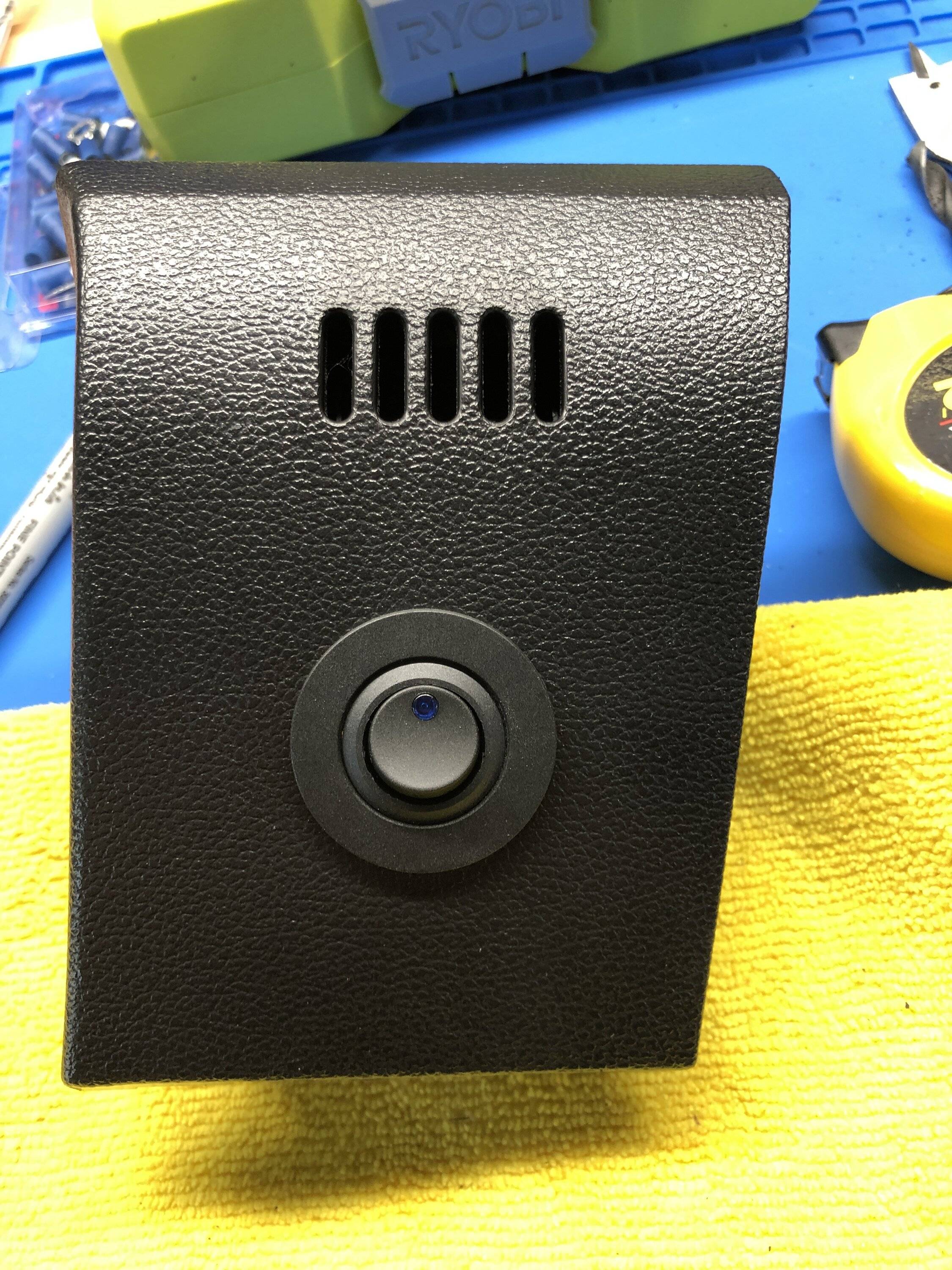

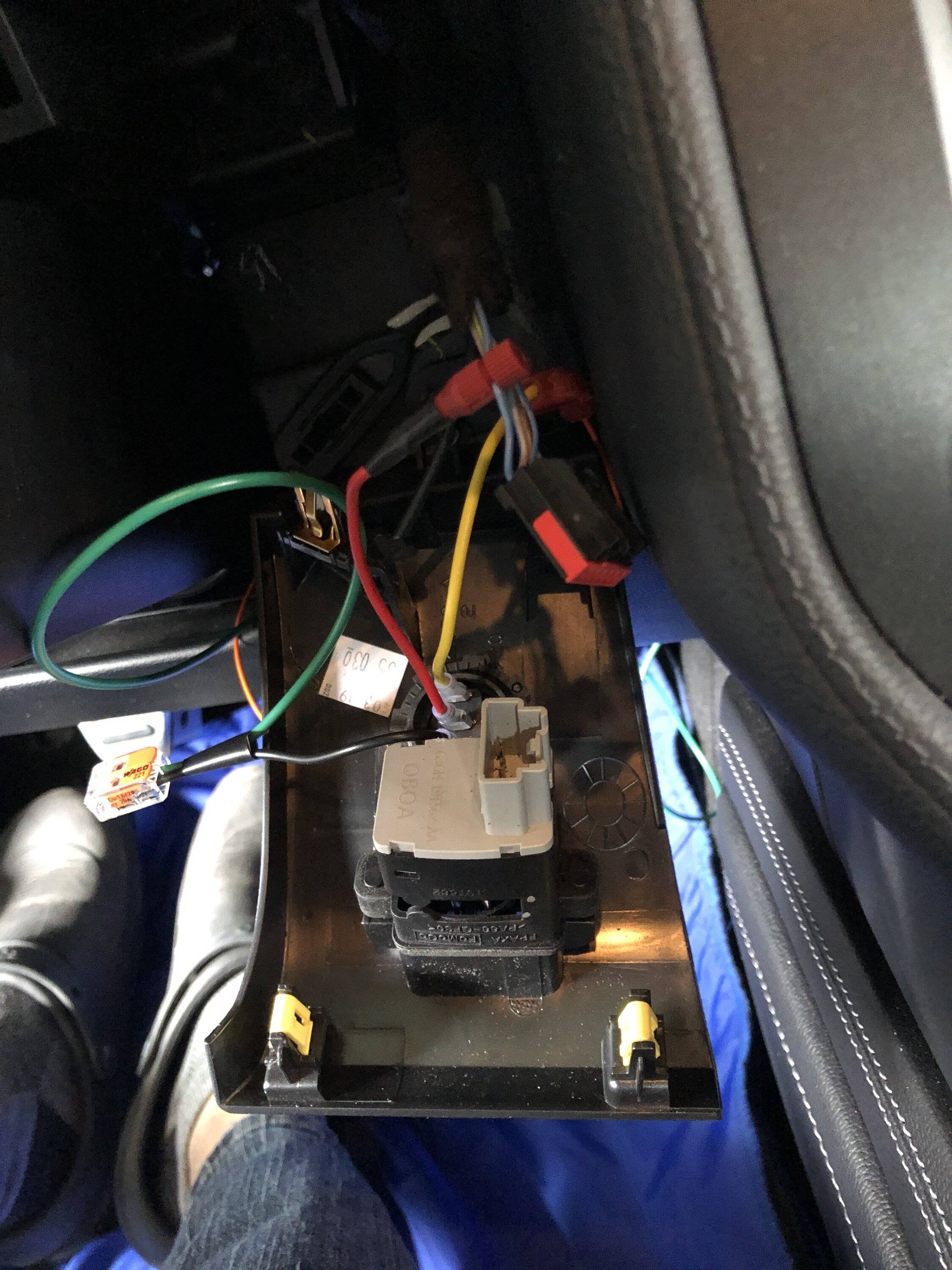

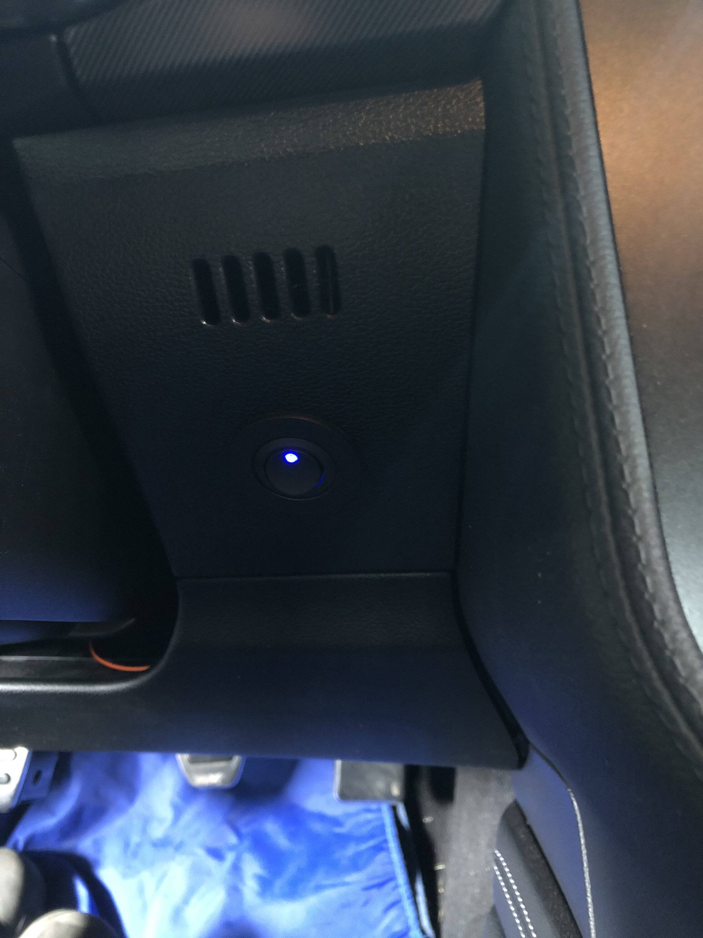

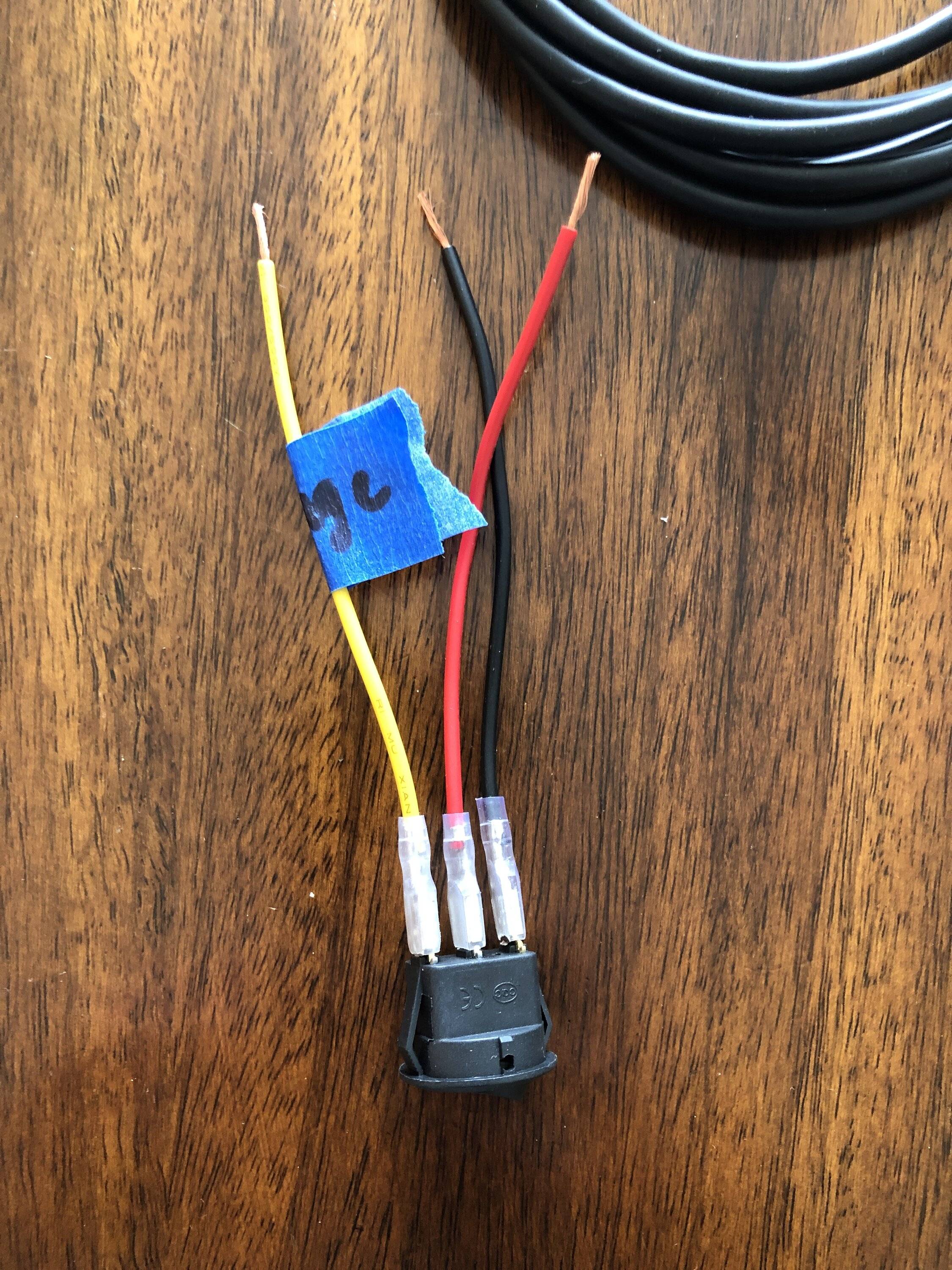

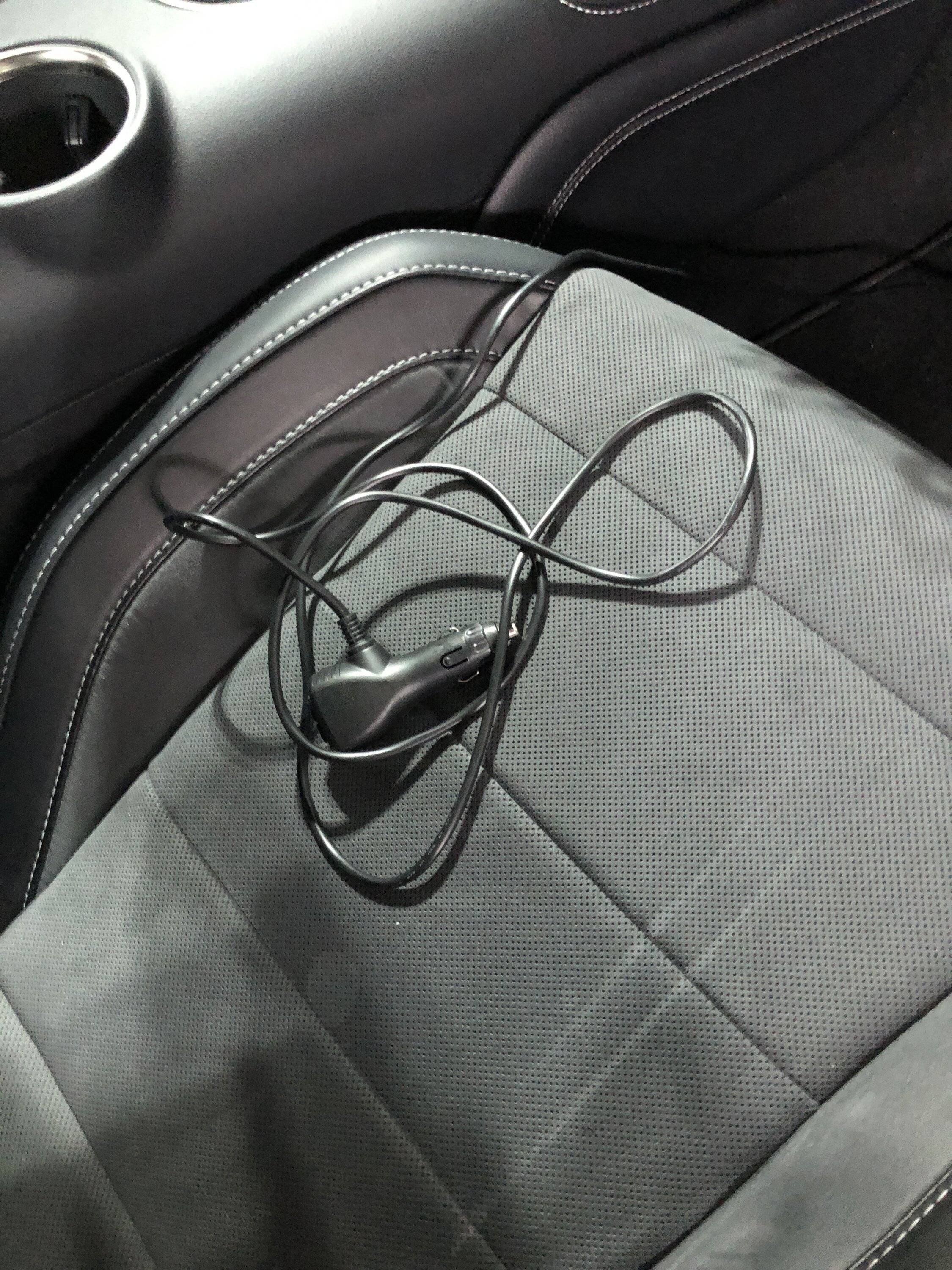

I finally completed the installation of an in dash switch for my Xeneering Auto Blip module for the Shelby. I wish they would have included an out of the box switch to turn the unit on/off, but after many conversations and a lot of help from guys on this forum I was able to get the switch installed. I previously had a cigarette lighter toggle switch plugged into the port in the center console. This was klunky as I didn't remove the center console to thread the wiring, but just had it running along side of the seat. Really love the clean (oemish) look of the toggle switch on the air temp sensor panel.
Tapped into the air sensor wire for 12v power for the switch. (thanks Biggsy and ChipG)
ignore the hint of orange wire peeking out to the left of the switch... that's been cleaned up :cool:

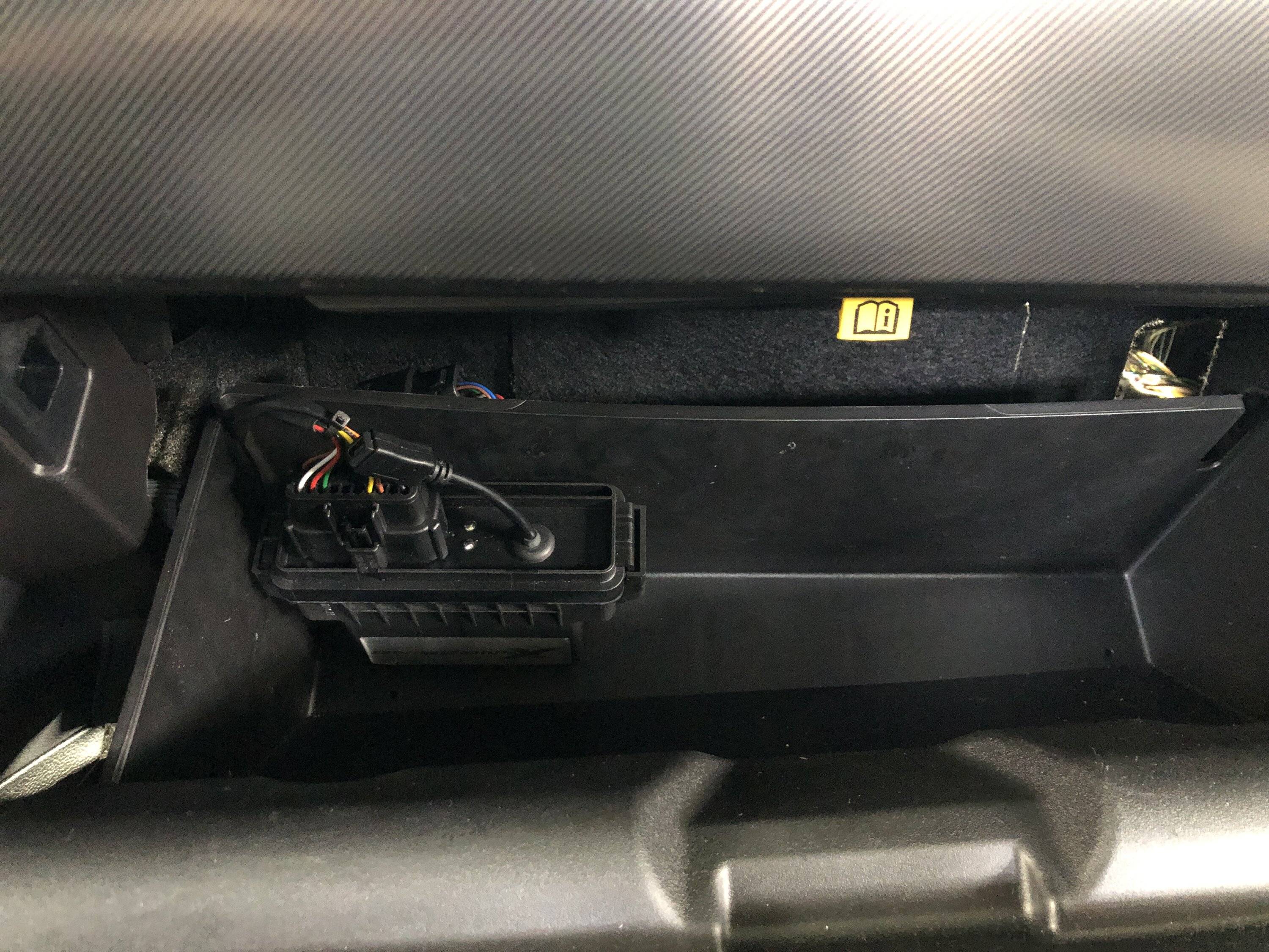

Also cleaned up and secured the master module in the glove box, so I had room for actual glove box things.

Where did you mount the module?
It's in the glove box. I mounted the on/off switch near the OBD2 connector so it was out of the way. Didn't feel like drilling a hole lol. The clutch connector can be a bear. I'm kinda lucky in that I can visualize stuff in my head so I looked at the connector on the plug and play harness, felt around for the plug on the clutch switch and figured out how it was positioned. Off and on in a minute or so. If I couldn't do that I'd say taking the dash apart to see is absolutely what I'd have done. I have plenty of cuts/scrapes on my hands from jamming them into every sharp edge under there lol.

You guys are giving me PTSD with all the talk about the clutch module. That was the most difficult part and I ended up scraping my hand up pretty bad. I finally ended up getting my 30 year old daughter who is a whiz at the visualization thing and has small hands. She had it plugged in after about 5 minutes.
Sucks that they didn't provide the switch and brake harnesses when I purchased mine.
Had to buy and wire my own on/off switch and positap into the BCU unit.
BUt even with all of that it was that stupid clutch module that slowed me down.
