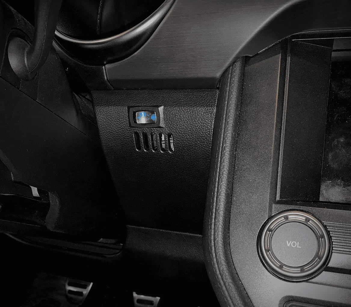

I've installed mine but I haven't had a dry track day yet to try it out for real. I did a wet day, and it was great, but the real difference will show up when it's dry.
Here's the switch I installed to control it:

A couple of things that I did that helped:
1. I am big and I have big hands (thumb and little finger in different zip codes) and decades of working in an office have left me less than limber. Turns out that working on the clutch switch gets a lot easier if you just pop the dash cover panels off to the lower left of the steering column. Pop off the outer panel, remove the screws you can see, fold the headlight switch up and park it on top of the steering column (don't disconnect it or the headlights will come on and the BCM will throw a code) and slide the sunglass tray out and you can now get both hands on the clutch switch when you're lying on the floor.
2. The switch in the picture above draws power from the cabin temperatures sensor wiring - that's the louvered holes just below the switch. The wire I tapped into there is literally the other end of the wire at the fuse box. I wanted the switch to be accessible easily when I'm returning to the pits, and that switch is a perfect fit and quite unobtrusive. I love Carling switches - used them in electronic products for years. Super reliable and stunningly well priced.

I wish I would have realized how difficult it is to get to the switch in the console to turn it off when strapped into a 6 point harness. I want to move it to a spot like you installed it. Did you just pop off that panel and cutt the hole?
The panel just pops straight out, and there's a tether that I suppose is there to keep it from flying around if the airbag goes off - you rotate the tether end piece until it passes through a slot to release it, then unplug the plug and it's in your hands. Two tabs release the sensor from the panel. That said, I also bought a new panel from my friendly Ford parts counter so I'd have an uncut one if I want to go back to stock.
The switch I used was a Carling LRA511-CB-B/012V that has a blue LED light in it. They're about six bucks each. It goes in a hole 28mm x 13mm, and I just masked it up with masking tape, marked out the hole location, drilled two half-inch holes (with a flat blade bit) and filed it out square. If you don't care about the LED, there are other Carling switches in the same series that don't have them, and it'll save you from running a ground wire up to the switch location. You pick the power off the sensor wiring which is about an inch from the switch, run it through the switch contacts and that's it.
And, yes, I already knew how hard it would be to get into the console when strapped in - I have had more than one occasion where I had to and it's just not happening. I can reach this switch easily, and if I move my head I can see it around the steering wheel.
