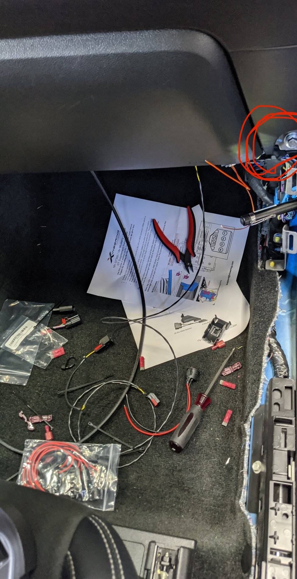

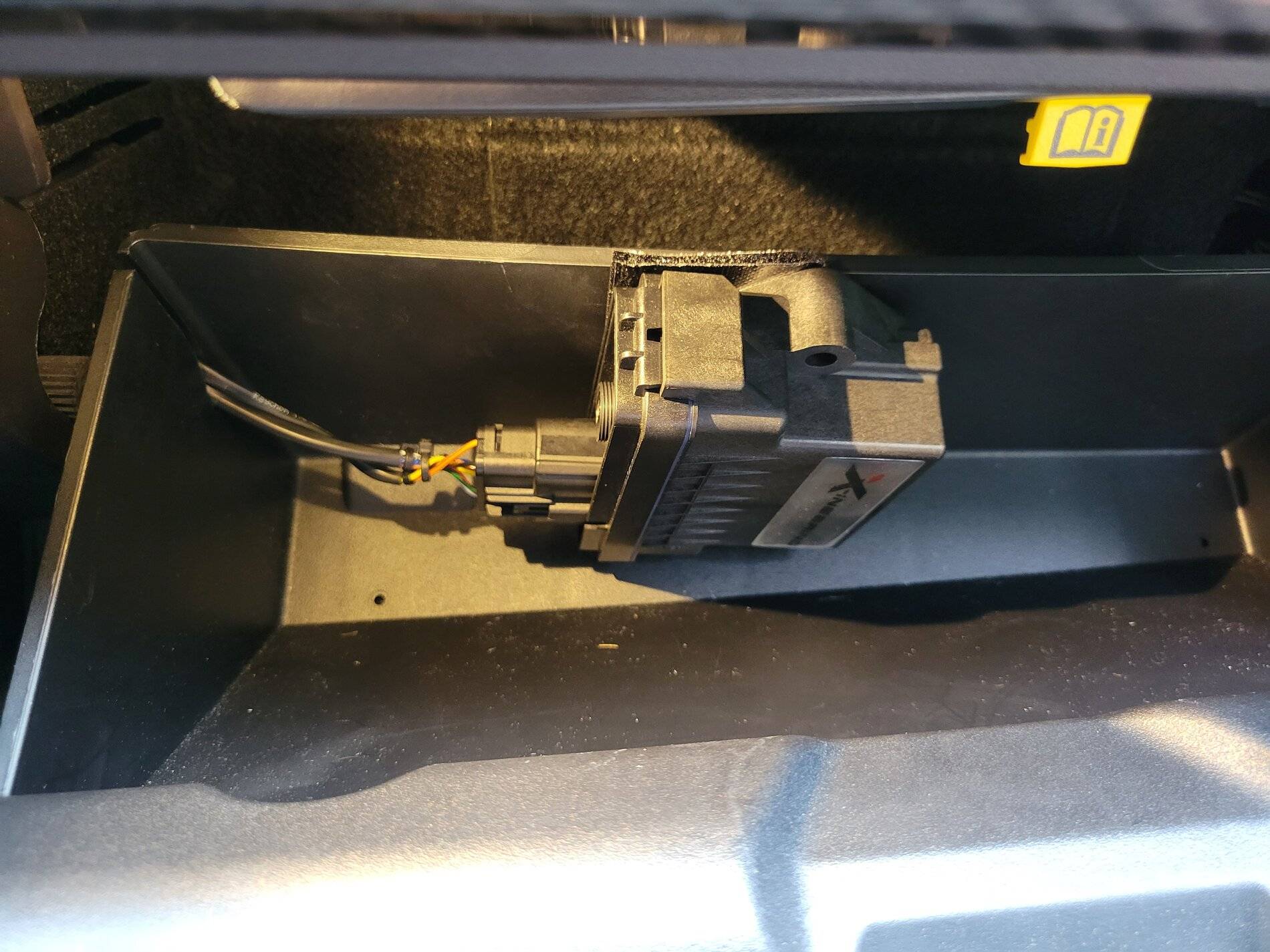

I did the install on this as well. Overall not bad, but as noted by many, the clutch switch part is a :curse:! I'll give the spoiler alert up front, though - I went to Road Atlanta, used the module for the first two sessions, then at the urging of my instructor, I turned it off and went to heel and toe and never looked back. I think it would have taken just as much effort to tune the module and my driving for good rev matches as it did to heel and toe. I went the rest of the weekend without using it and this past weekend drove at Barber all weekend without using it as well. I'll be uninstalling the box and putting it up for sale if anybody is interested. Not looking forward to doing that clutch switch again 😡. All that said, for those who are interested in using the module, a couple of install notes and photos follow:
I mounted the Xineering module in the glovebox like so using velcro:
Running the wires to the fuse box and across behind the center stack were straightforward.

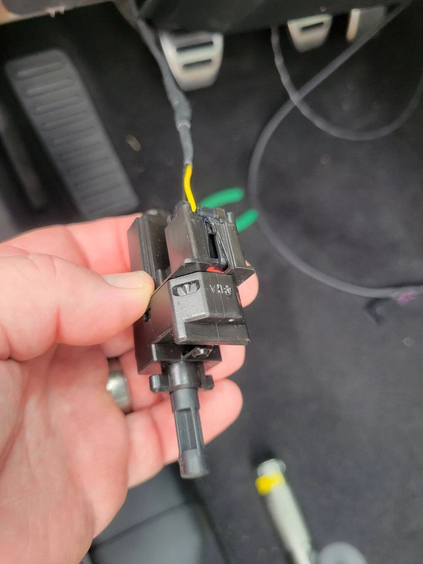

But this switch is the PITA:

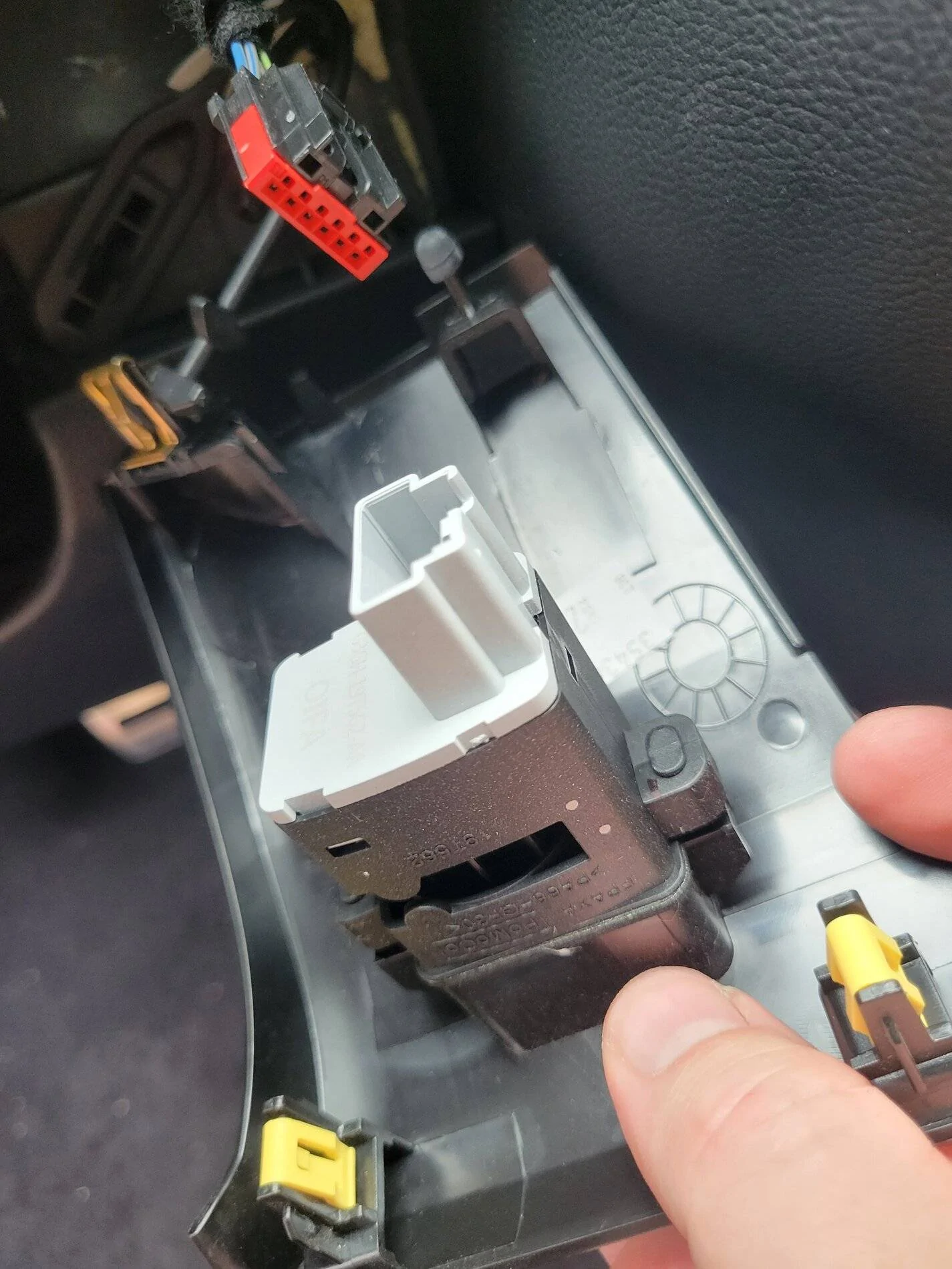

I pulled the left side panels from the dash:
and it did help get better access, but still, a royal pain.

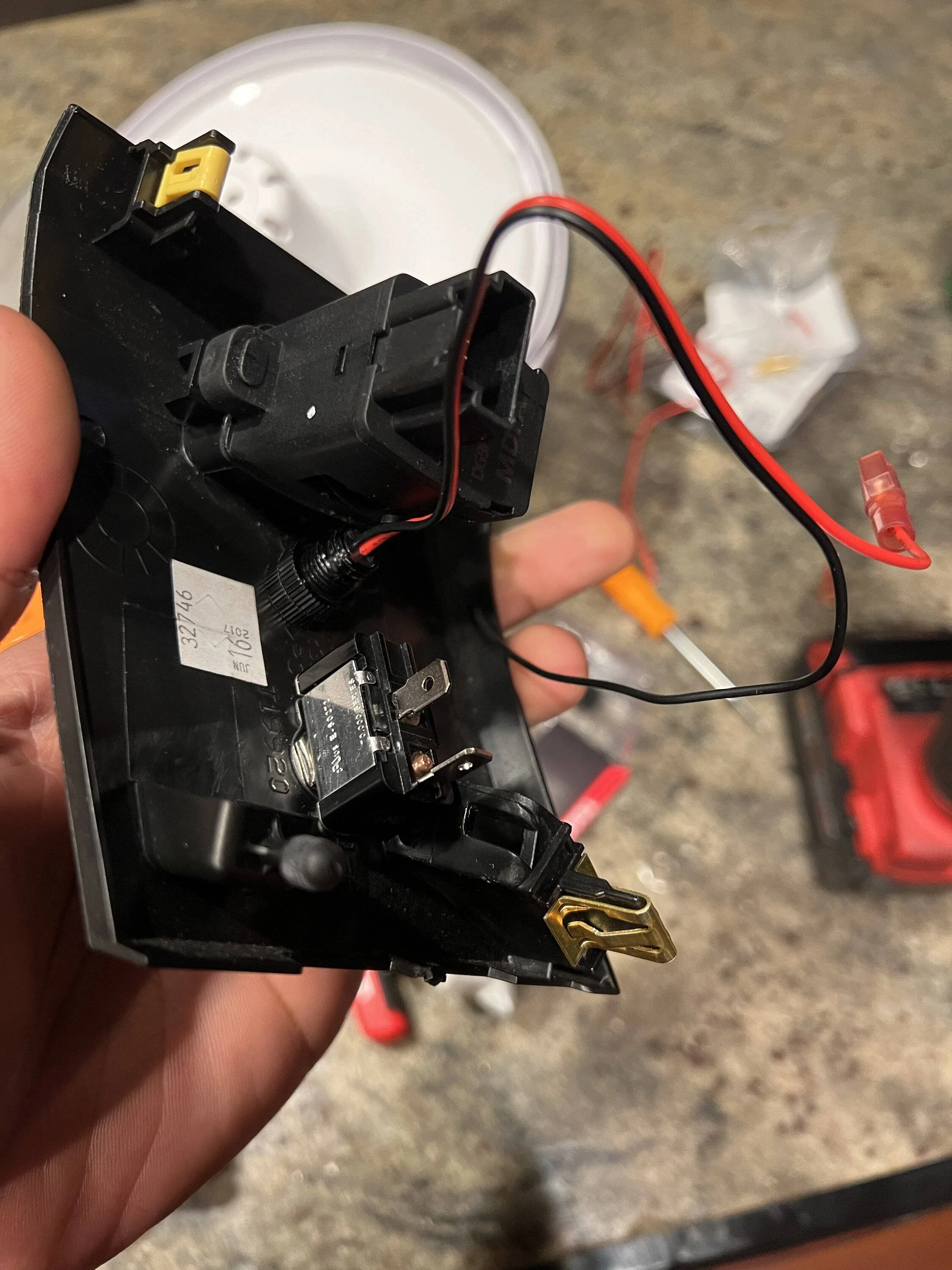

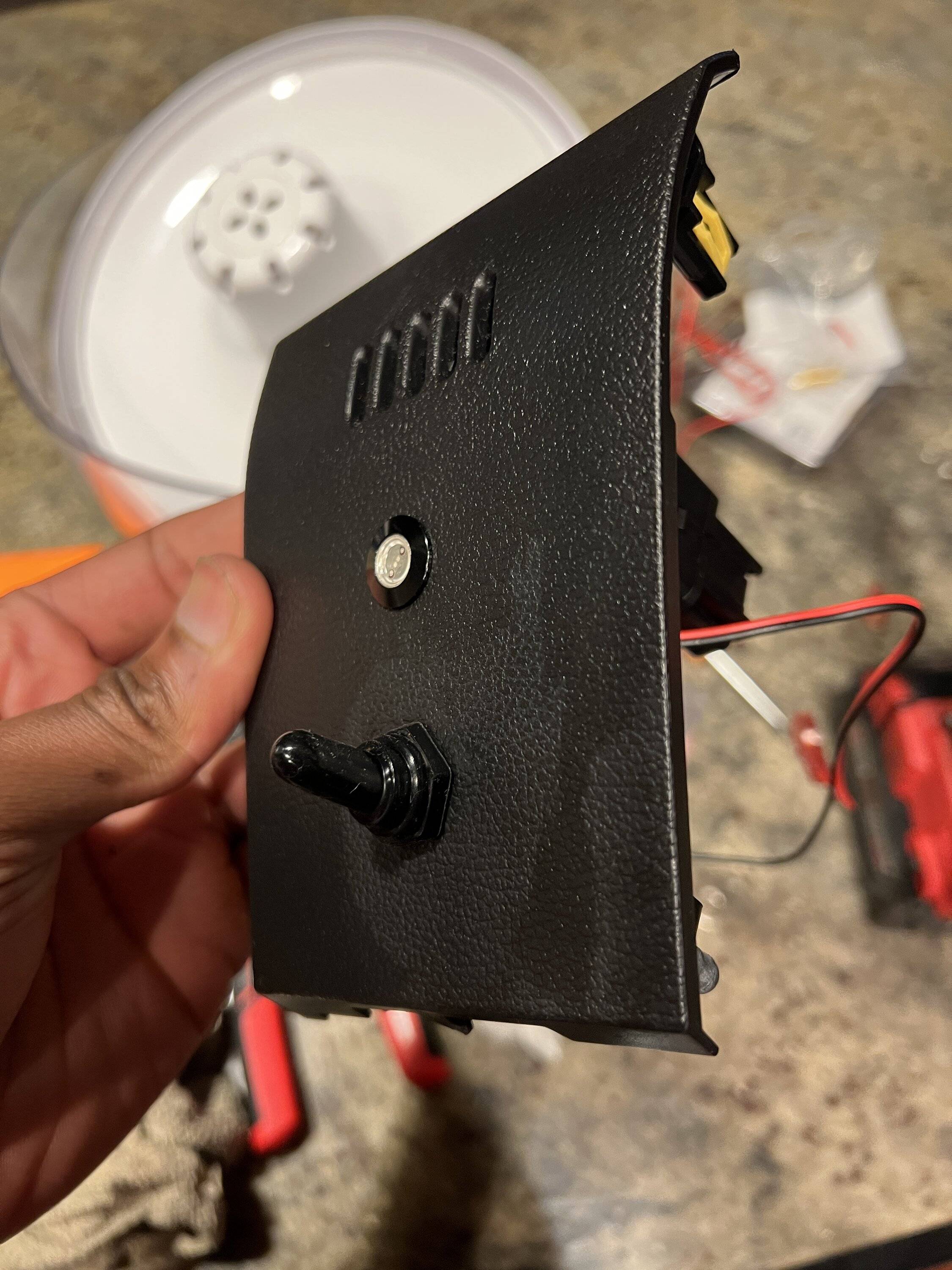

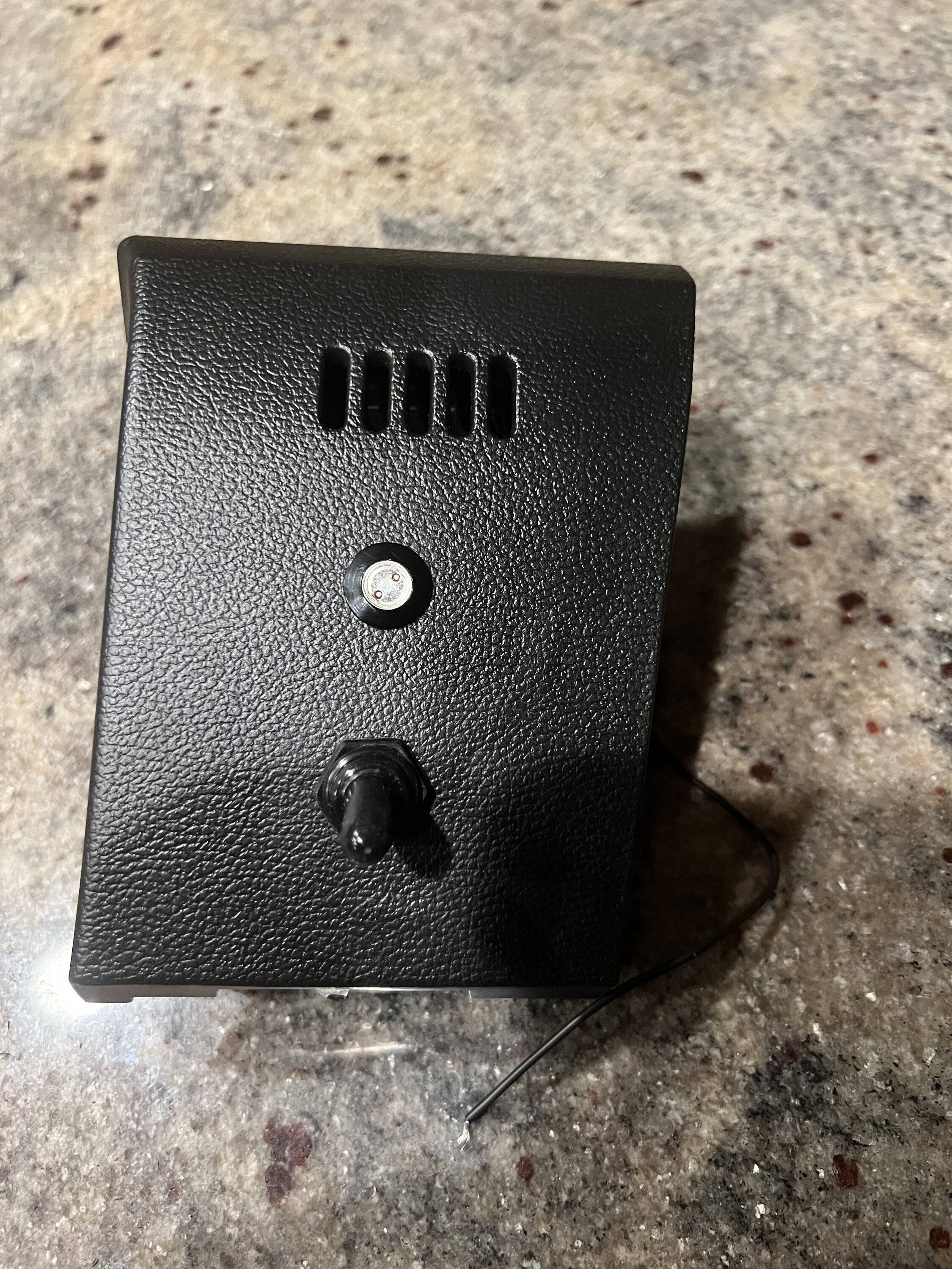

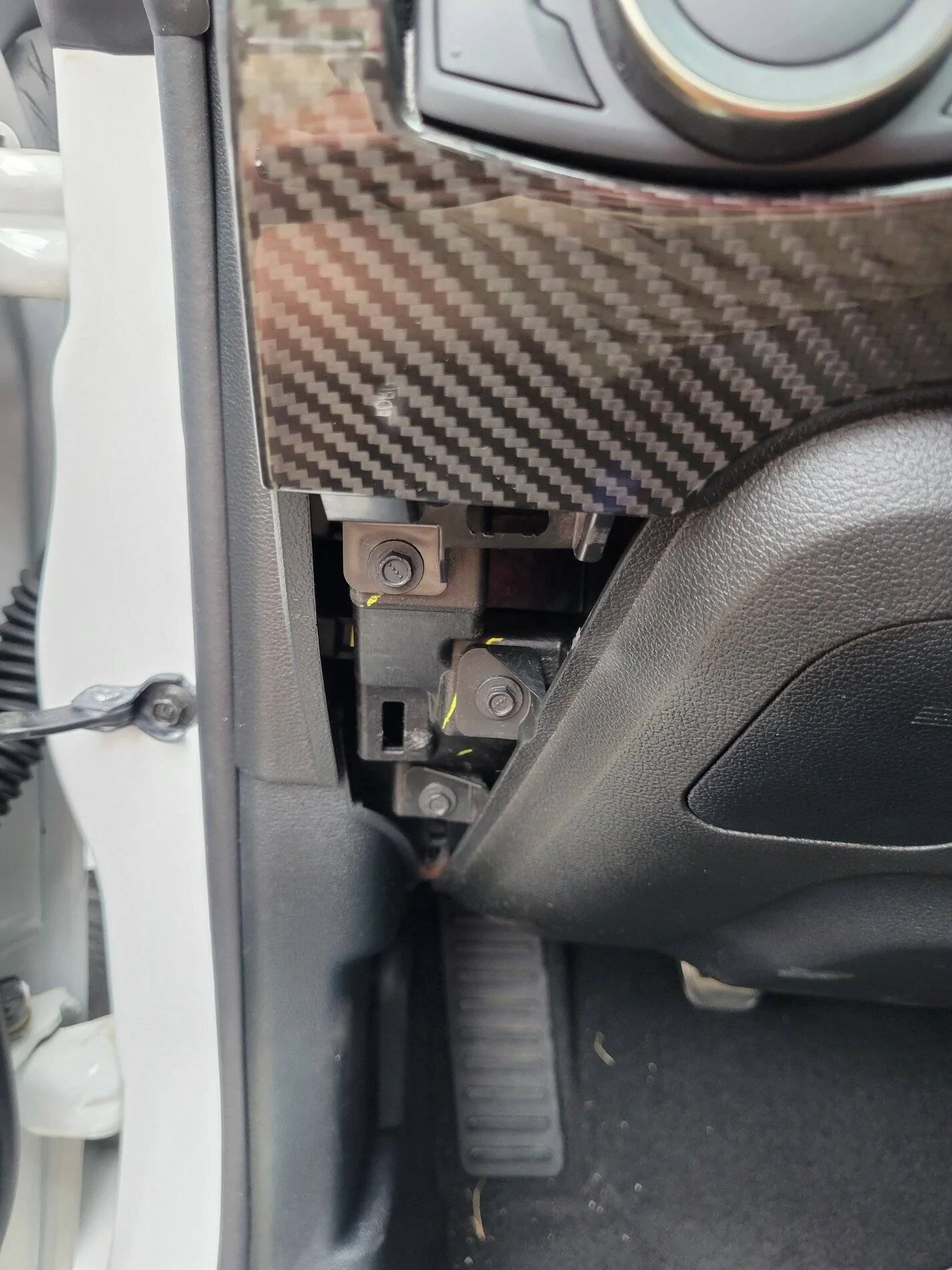

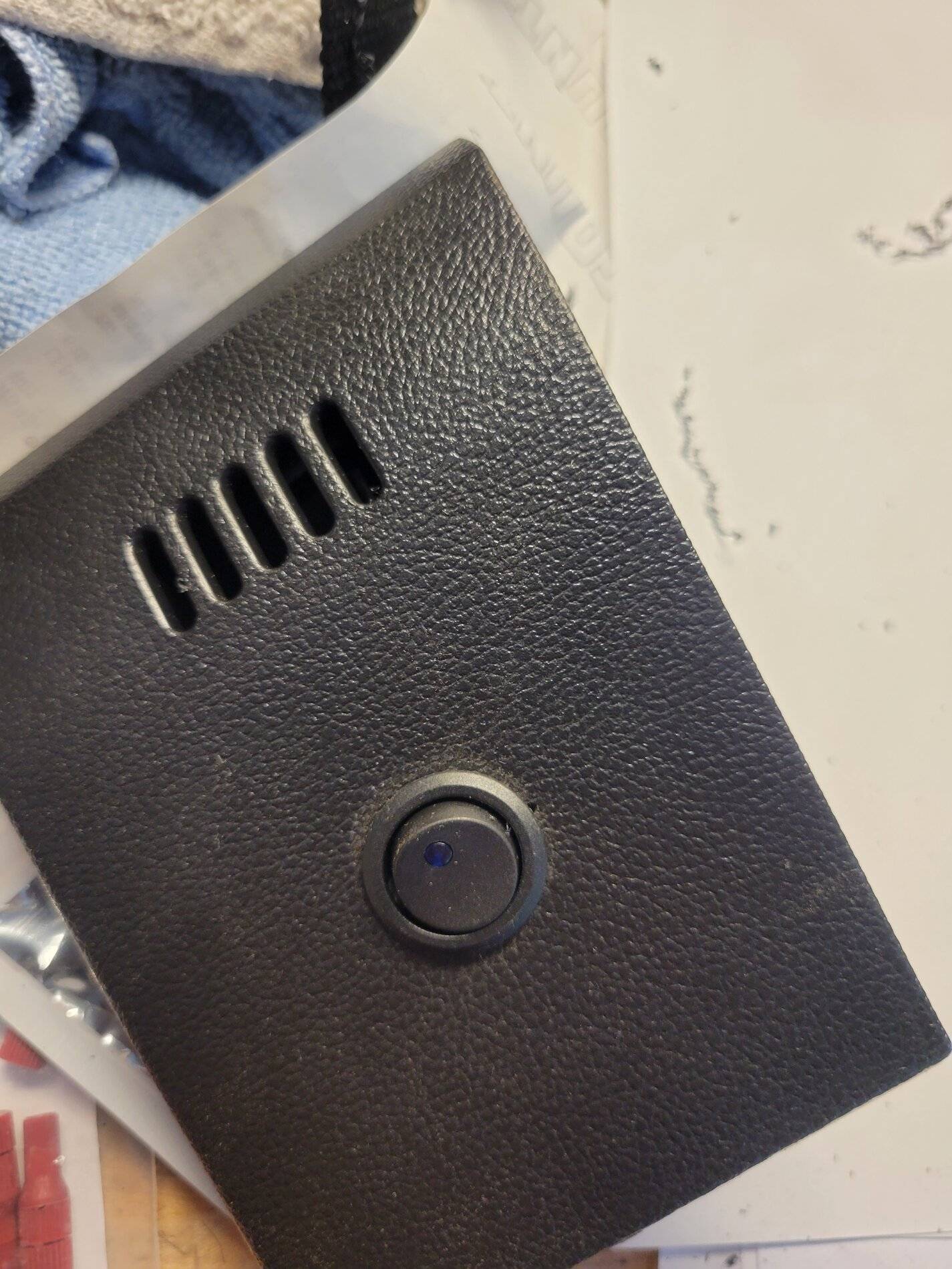

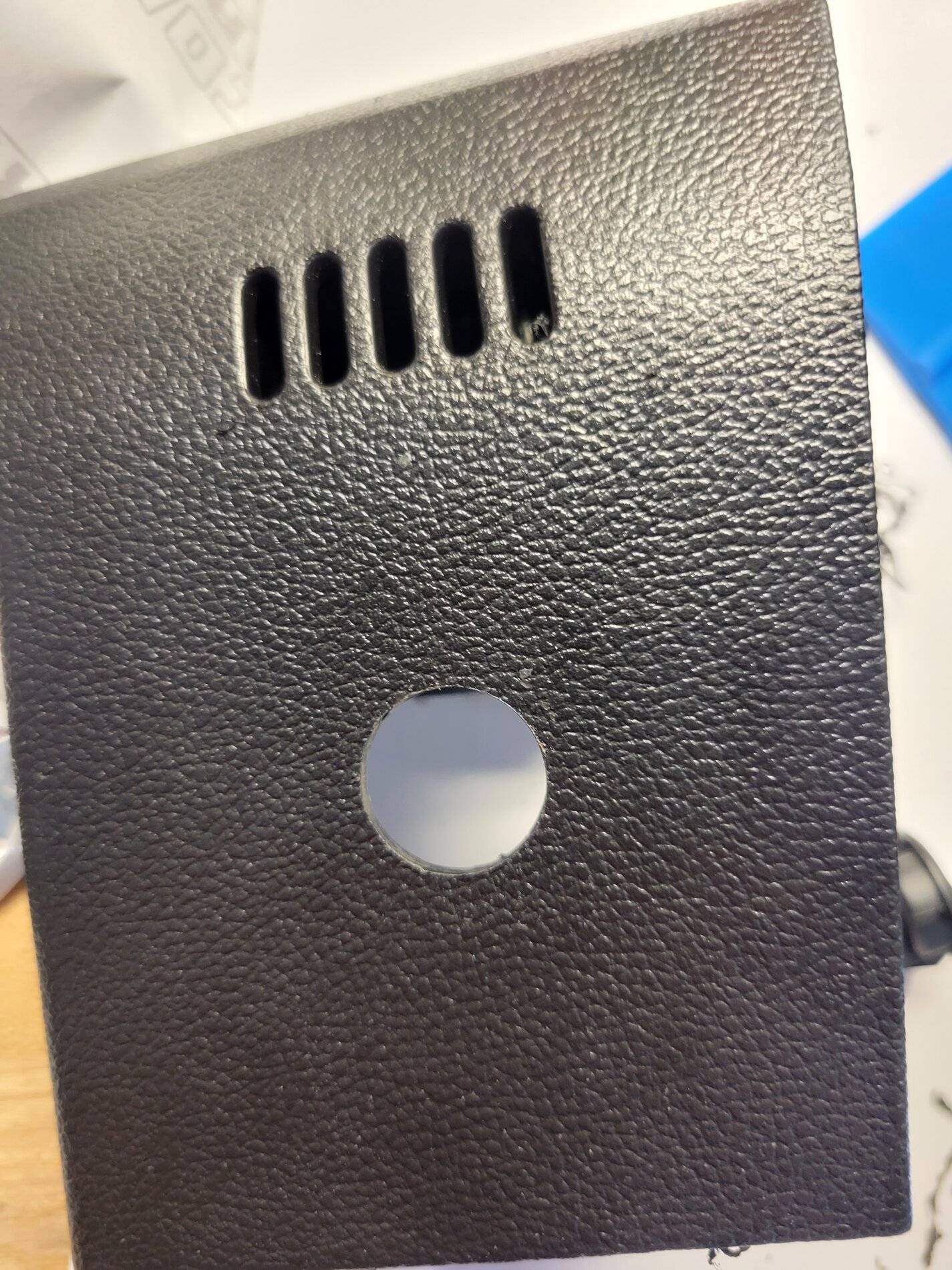

Other note is that I installed a switch by the interior air temp sensor to the right of the steering wheel:
Tapping into the wires was easy, I ran a ground to a nut behind the dash, and the lighted switch works perfectly.

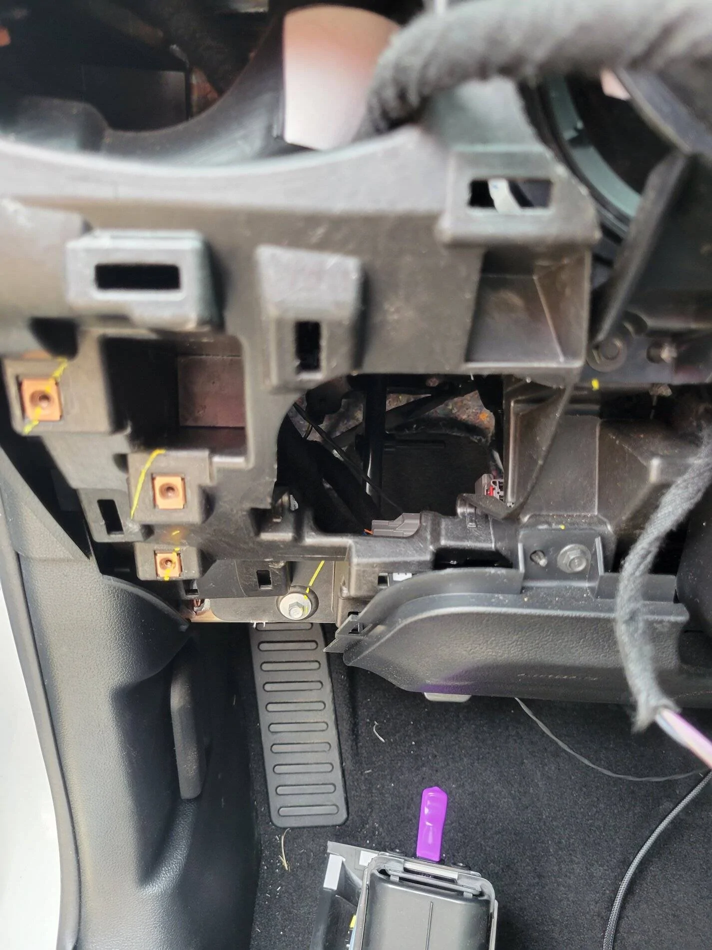

I know you didn’t ask me but I did the same and ran a separate wire from the switch to the bolt on the passenger side kick panel near the fuse box. I got a ring terminal and used the bolt there.

See circled in the picture

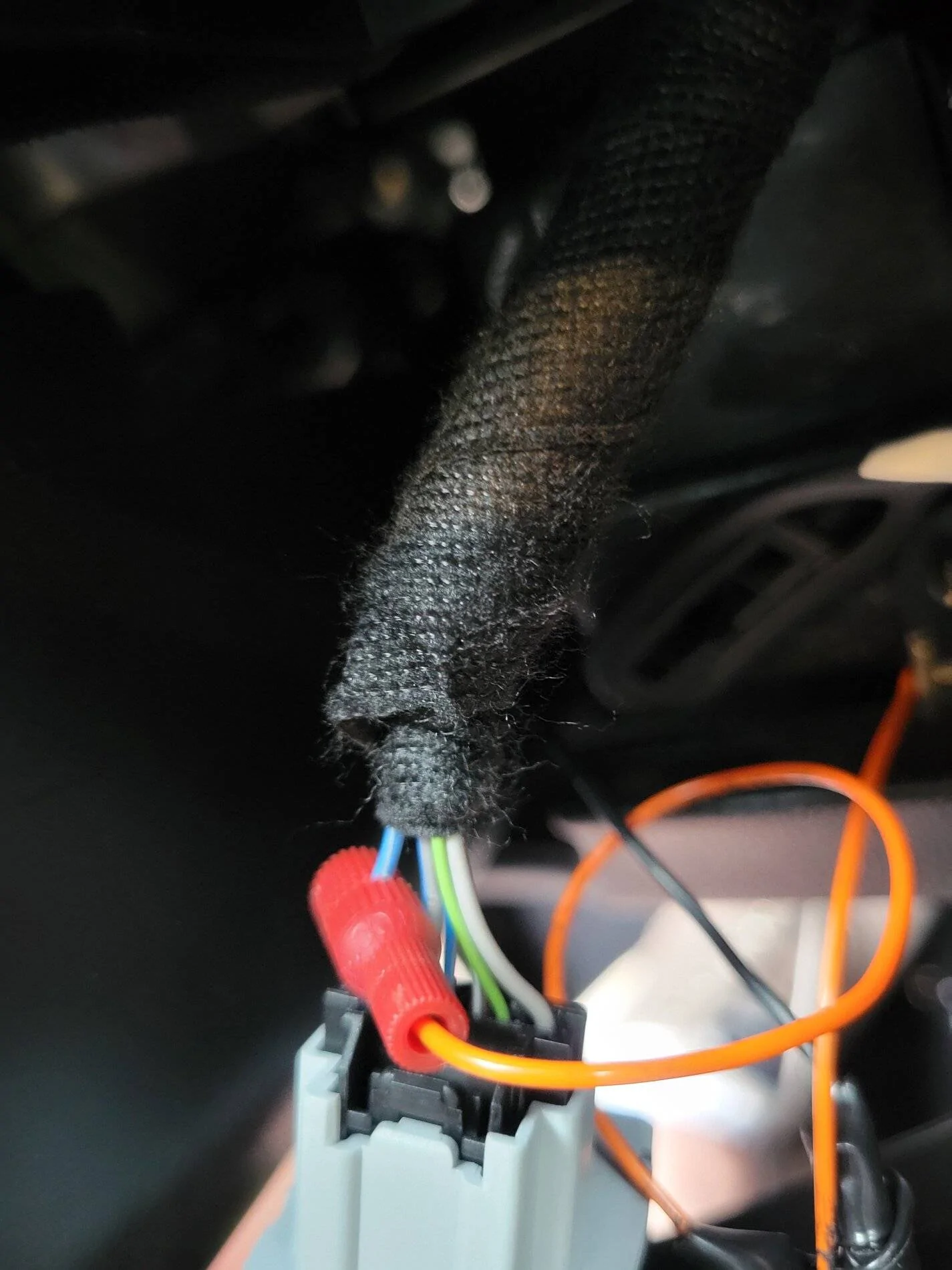

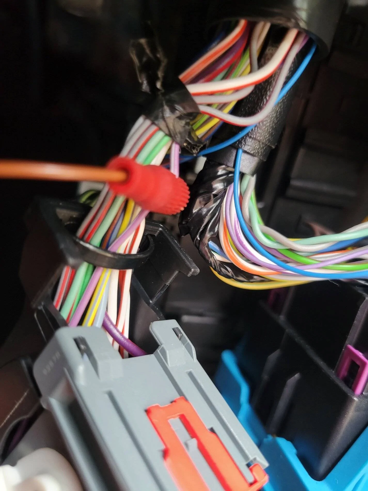

When I hooked mine up, I used one of those little tiny taps to lift the switched power off the temp sensor on that panel. Since there was already an orange wire running from the switch to the wiring bundle, I just ran a second black wire along with it and used a second tap to connect it into the common wire on the Xineering harness.

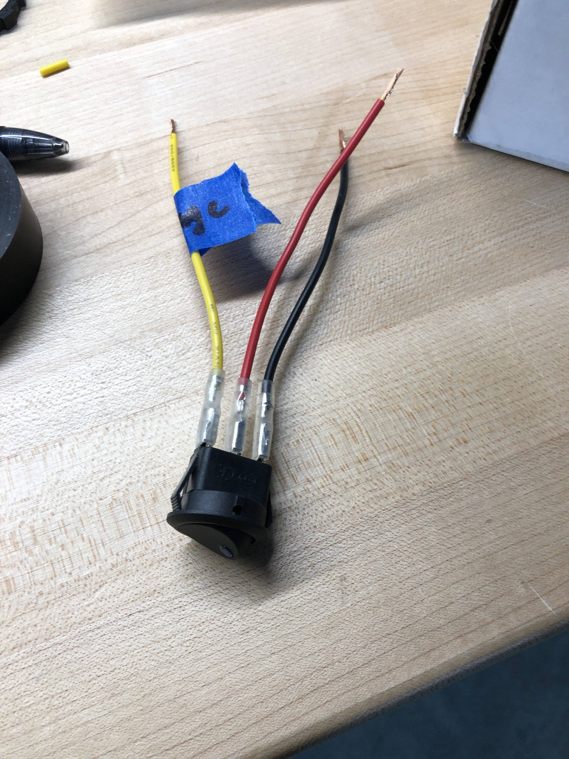

So you have 3 pins. One is load like you said that goes to the module. Then the battery pin goes to the power source which according to the instructions is in the harness which you tap into for the brake signal or you could run it to the fuse box by the passenger foot area. The third should be ground which I ran to the bolt on the passenger side foot panel. The one I sent a picture of circled

Thanks.. sorry it's just not computing for me. I really wish xeneering would have offered the unit with an on/off switch and been more intentional with their instructions and video as to where the power source goes when installing a switch. I'm going to try the temp sensor wire that is connected to the panel where I am putting the round switch vs going all the way back to the BCM.

Do you have a link to where you bought the switch? Just wanna see how the pins are so I can map it out for you
But you can try the temp sensor.
