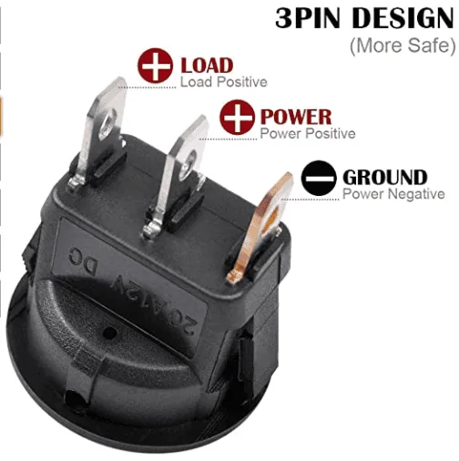

If someone can tell me how the heck you wire the 3 prong, please do, I'd love to swap to a lit rocker switch.
Thanks! @JAJ suggested F21 (in-vehicle temp and humidity sensor) as long as 5A is sufficient for that and the box.
I ordered 3-prong rocker with LED, should just be power (orange from fuse), ground (from any ground), and load (switched - orange to box) I believe. Are you just missing the ground wire?

And thanks for the tip on the switch! So, if it has 3 prongs, the center just runs to ground and the other two can hook up any which way along the orange wire? All I need to do in that case is swap in a new LED switch and run a wire to a ground.

For the switch, it does matter which wire goes where:
Power and ground power the LED, then "Load" is the signal out to the box that is switched, if I'm not mistaken. So fuse box would tie to power, load would tie to the module.

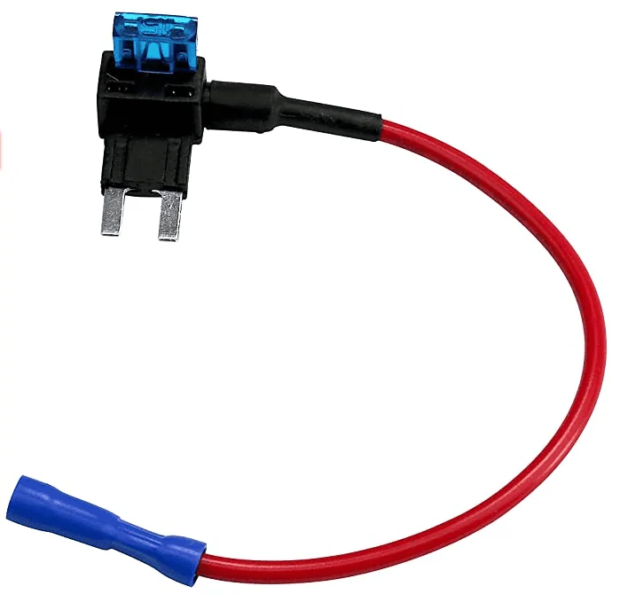

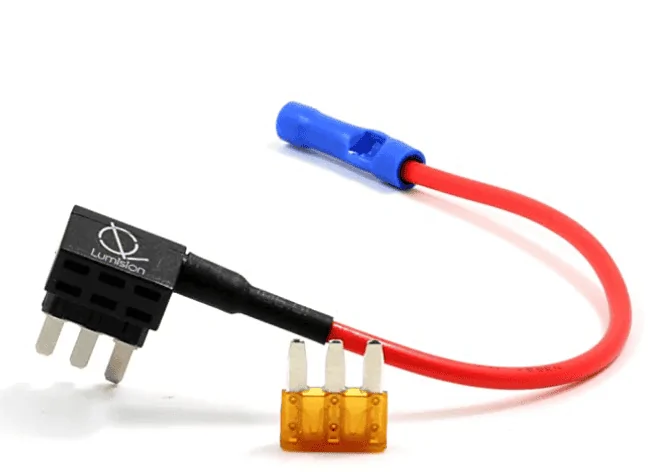

For fuse F21, does that mean this kind of fuse tap won't fit?
and I need this one instead?

Thanks a ton for the switch info!
And yes, that bottom one is correct (top one won't work). But I'm a bit confused by it. It seems that it must be fused off of one side, in which case you'll need to make sure it is flipped appropriately. The only other possibility is that the wire isn't protected by the fuse and is running directly to the center prong.
EDIT: Chip, why not just positap the orange in as well while you're in the harness doing the brown?

You can see where the fuse goes in the side, though it's a little hard to see in that photo. I brightened it up here. I'm not sure what that will mean for directionality with F12/F22.
I am trying to minimize posi-taps, but will have extras of those as well and will play it by ear once I'm under the dash if that's easier or this doesn't fit in the fuse box in the correct orientation.
