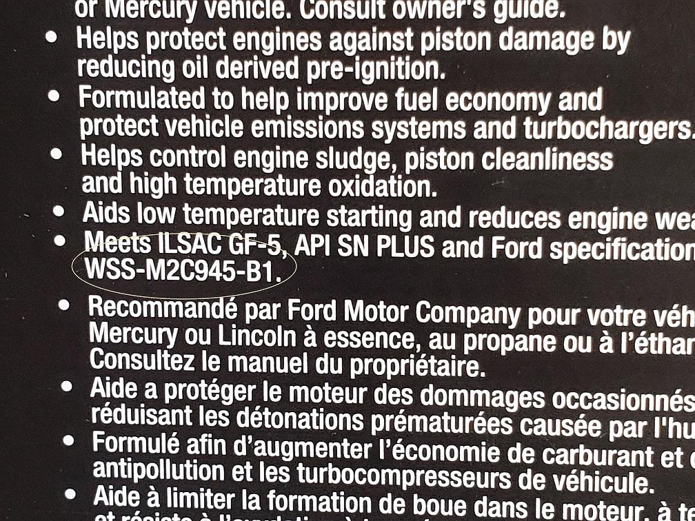

Thanks for both of the replies. Manual says oil spec is Ford WSS-M2C945-B1 & any of the Synthetic Oils say they conform to Ford WSS-M2C945-A I think it said. So I don't know if that is better or worse? But I'm not going to add anything at this point I was just thinking I should have some around if it gets low enough that it could need some as I know engines can use some when they are brand new sometimes. I was planning on doing my first oil change around 3500 miles so it may stay up enough anyways before I get there.

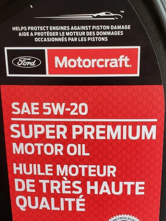

Okay so I answered my own question the only oil that meets the new Ford oil spec for 2019 on the GT is Motorcraft oil. Nothing else here in Canada does technically only the old Ford -A requirement. including Mobil 1 Full Synthetic which is crazy. See the info in the specs. Essentially this new formula is to prevent LSPI. So read you oil containers you may not be using oil "good enough" it seems which seems ludicrous to me honestly. So I bought the Motorcraft stuff exactly as the car came with. I may be going with dealer oil changes if this winds up being the only option to follow the spec.

LSPI prevention is moreso aimed at turbo engines such as the eco boost cars. There’s nothing about the CAN version Mustangs that differs in oil requirement. There’s many off the shelf full synthetics that are plenty suitable for the 5.0.
