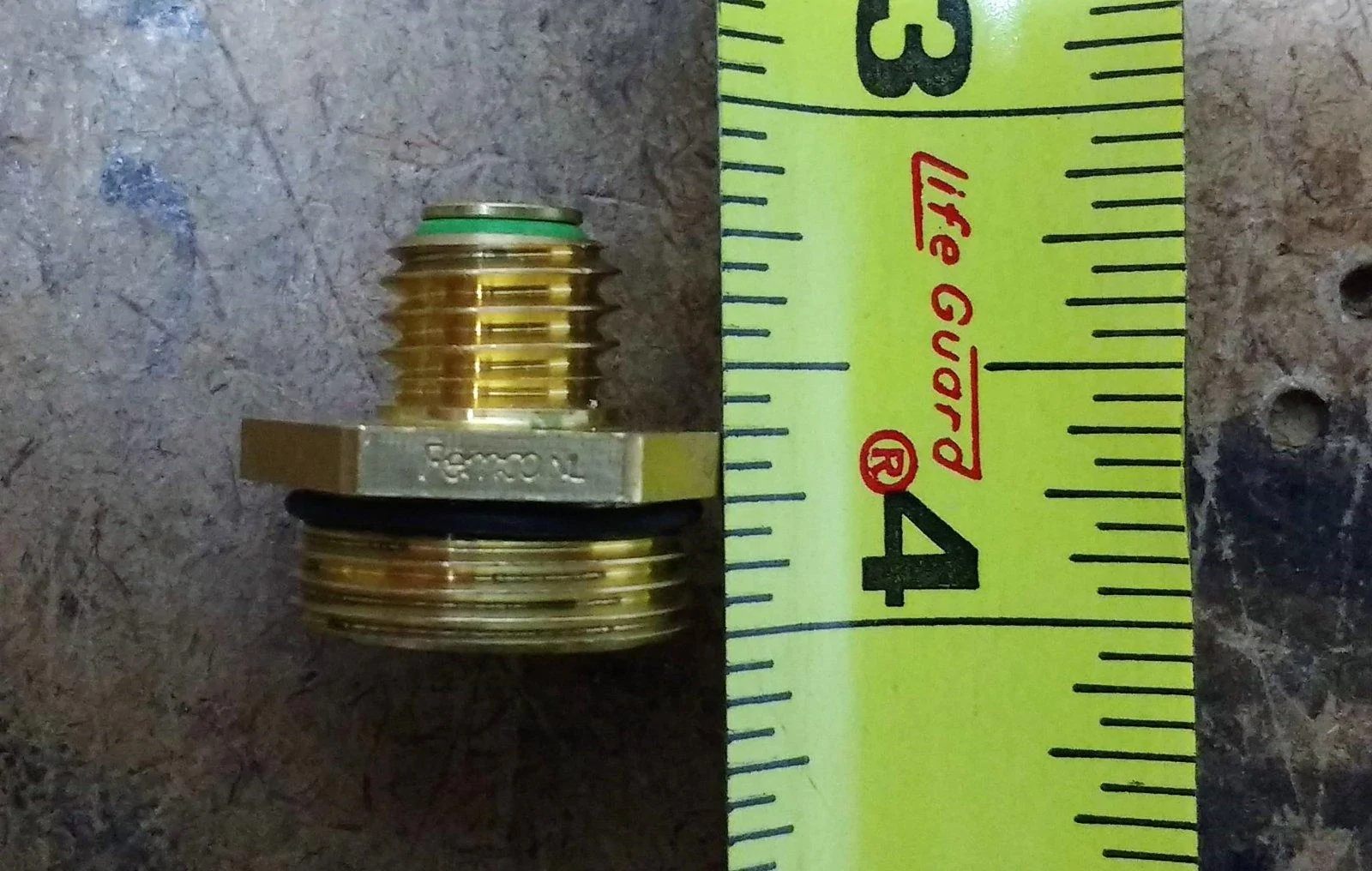

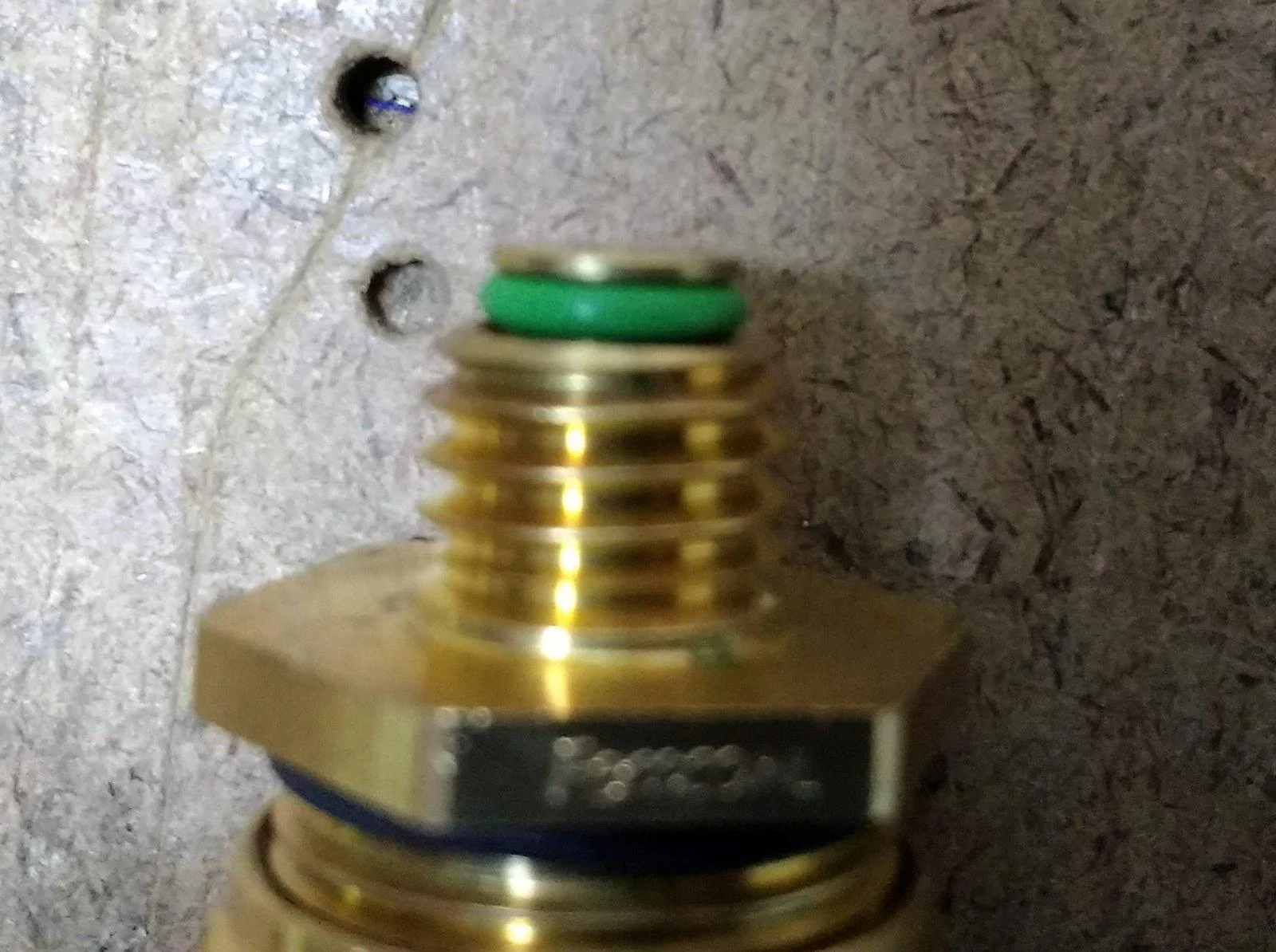

Your reply makes perfect sense. There are only a few threads for the opener to thread onto, therefore the plunger isn't pushed open much at all. I bought two of these: Compact SB 7090010153 M12 x 1.75-T9

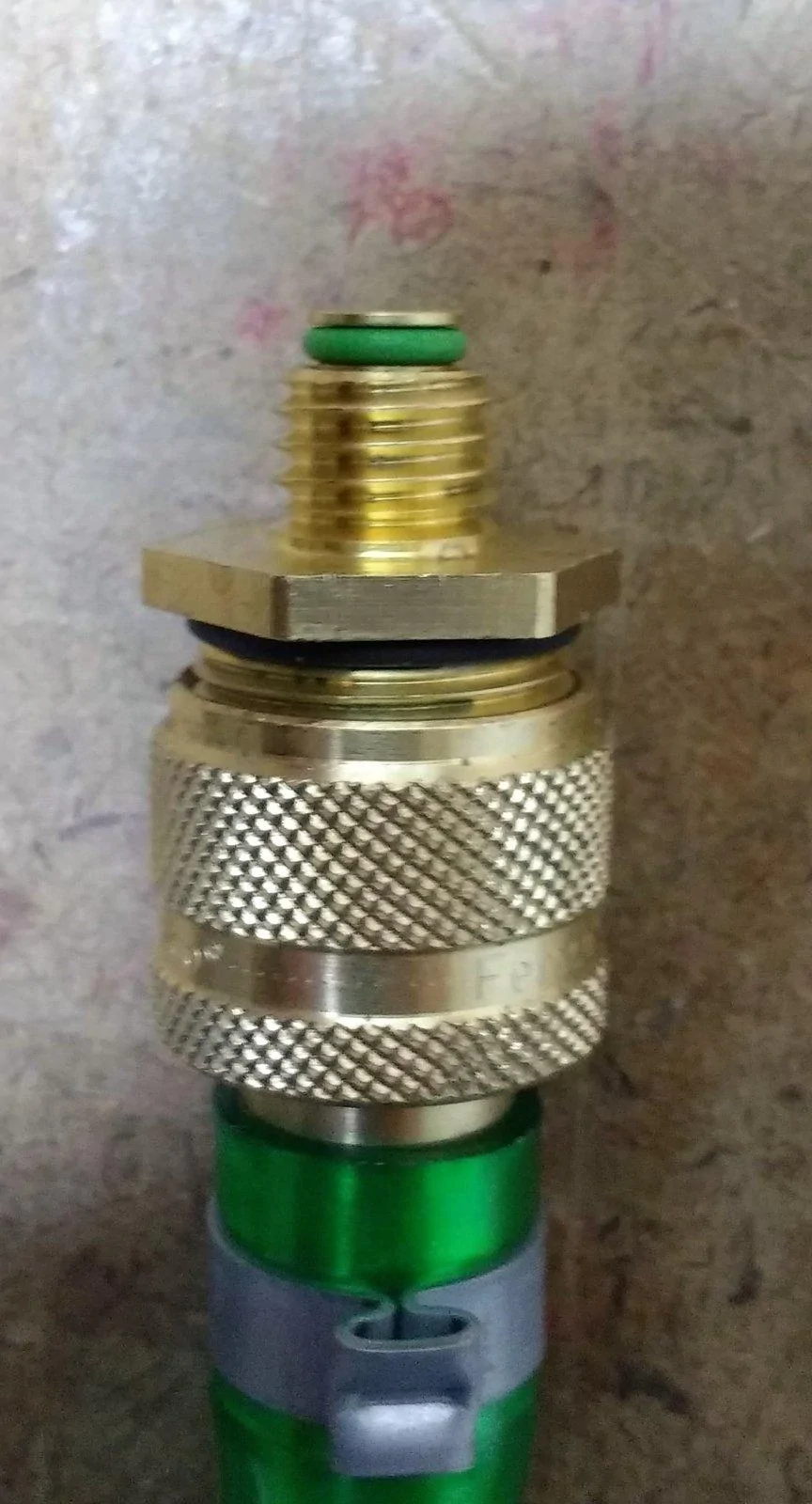

Here's the valve in it's closed state.
And open. The drainer is screwed on tight.
I may contact Femco and see if they'll exchange/credit me back for the full size valves. That opening is ridiculous. It will take an hour to drain 2 gallons of oil. :(
*edit*
If I really crank the drainer on there tight, I can get it maybe another 1/32" open...literally just a hair more. I tried manually pushing up the drainer into the valve bottom (not screwing it on) and the drainer literally only goes "so far"into the valve body. I don't think it's physically possible to get these compact valves to open any more than what you see here. That said, I have no idea how long it will actually take to drain 2 gallons of oil. I usually let the oil drip out until only a drop or two a second comes out of the drain pan...with this thing it may be hard to tell how empty exactly the drain pan is. Now, with the very short thread body that goes up into the pan, I'm pretty the opening of the valve will sit flush with the bottom of the pan, so that's not an issue...just how little it actually opens concerns me. Not sure what I"m going to do at this point; keep them and see what happens or return both for the full size valves.

Something may be wrong with the drainer. If I am seeing your picture right, it looks like the drainer is not screwed on all the way to the black o-ring. I never paid close attention to the compact valves like you and I have but the full size system drainer screws down to the black o-ring and can't imagine why the compact would not do the same.
I can't understand what's keeping the drainer from screwing completely onto the valve. I think you said it was the same for both valves you bought so more likely something happening with the drainer.
Your part number is right for the valve. I don't know the drainer part number but there are only 4 families of screw on valves, and I don't think any of them have the same thread size/pitch, so if it screws on at all, should be the right one.

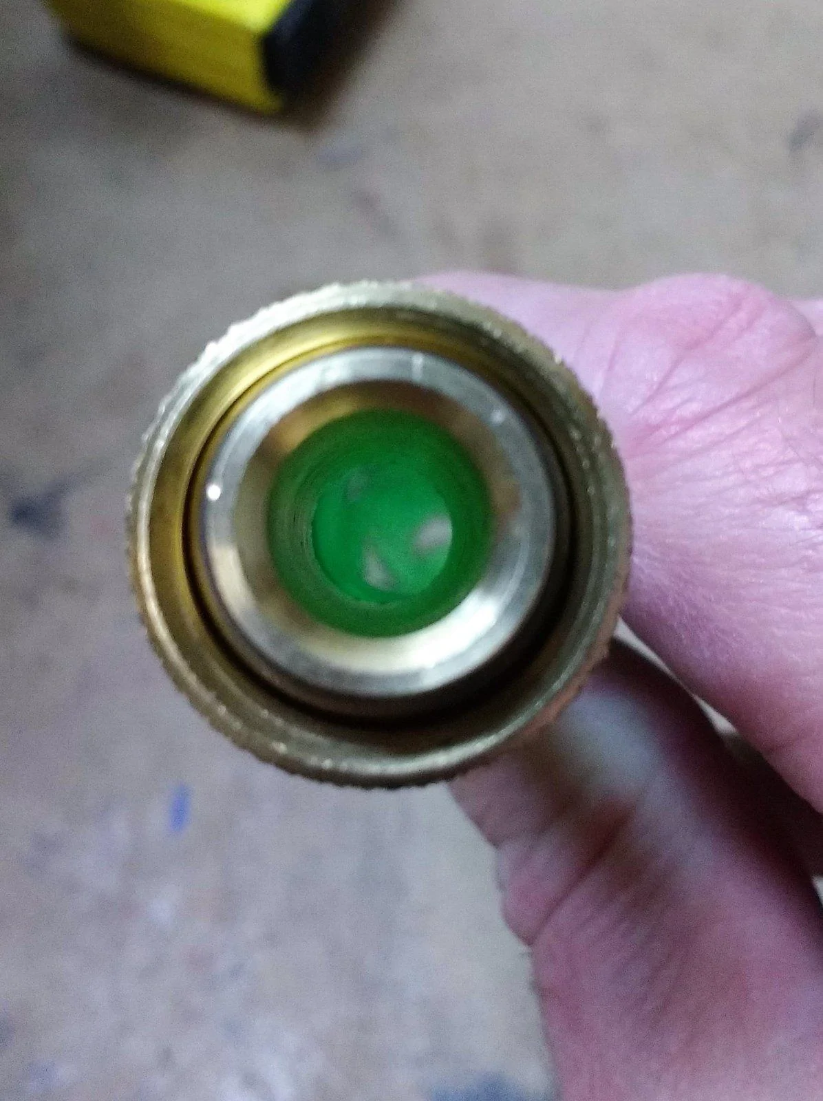

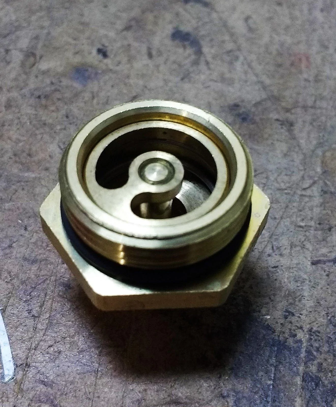

Can you get a pic looking down the barrel of the drainer and also of the valve with the drainer off it? Something is keeping the drainer from screwing all the way onto the valve which means it won't open all the way. Look at my pic of the full size valve. The drainer is screwed all the way down to the valve body black o-ring. Should be the same for any family of the valves. Your picture looks like the drainer is barely half way screwed on (if that).

I agree with you that something is off. Obviously, the valve isn't attached to an oil pan, but I got the drainer on there as tightly as I could. Turned it until my fingers holding the valve hurt from the edges of the hex nut.
Here's the pics you asked for. I'm stumped. I'm going to email these to FEMCO (if I can attach pics) and ask them if this is normal. The valve does push up farther than this when you push up with your finger.
Drain tube
valve
Drain attached and on there tight

How embarrassing. The fix was simple, but I didn't think of it initially. I received a very nice reply back from FEMCO in less than 24 hours. Here's what it said:
The valve and the drainer hose connector should be higher. Normal application should push the valve to its max height, see attached picture. I don’t think the one you received is defective, it may need a little bit of oil on the thread, plug and inside the connector. If you have some WD-40 or other lubricate, apply it and it should work smooth. If it doesn’t, I will mail you another set and include a return envelope for the one you have now. Also, please share with me the year, make, model and engine type of your equipment.
I liberally sprayed the drain tube threads and the plug threads with WD40 and it popped right on and threads all the way up. The valve opening is now approx 1/3" and I'm good with that. Very good customer service that they offered to exchange them right off the bat, but that won't be necessary. Thanks, FEMCO. :)

The o-ring on the drainer is a really tight fit into the bottom of the valve body. That's what was keeping the drainer from threading on. Seems kind of overkill to me to ensure the drainer doesn't leak...it's supposed to leak when attached. LOL!
