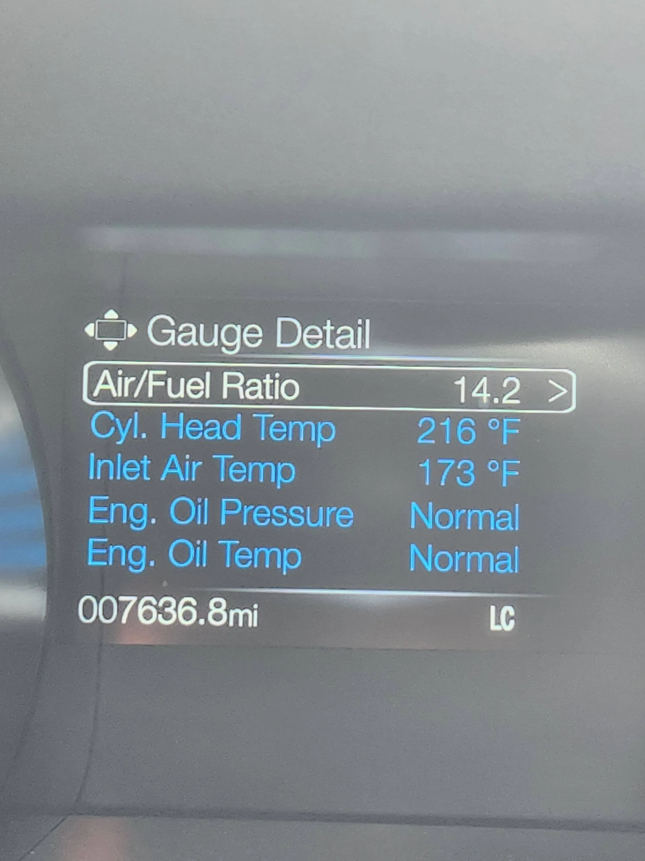

So after doing some pulls/datalogging today, I noticed that my IAT's would skyrocket after sitting the car for 2-3 minutes (which is expected, but I was kind of suprised to see the IATs around 173 degrees on a 82 degree day). Once the car started moving the temperatures would obviously drop back down within 10 degrees of ambient temperature, but I was wondering if this number looks high to anyone? At what temperature can heak soak begin to degrade the paint on your hood?
Also the cylinder head temperature--is this high, or within a normal range?
I also live in Florida, so the heat and humidity is definitely a factor in these numbers

Yeah not good at all! I don’t think I ever saw iat or iat2’s that high when I had my double oven (Roush SCer) on the car during the hottest parts of summer here in FL even after back to back pulls.

My gt350 Cai will go into the 150s idling at a drive through, even now at 80 ish ambient, then goes back down to with 8 degrees of ambient

Remember that it’s not just the 80*. The asphalt will radiate about 140*s. When you’re sitting still after a pull you’ll have the engine heat radiating and you’ll also have the heat coming off the asphalt radiating up and through your engine. So there might be your reason for the high IATs.

Idle I don't worry much, if I were moving and it stayed there, yeah.

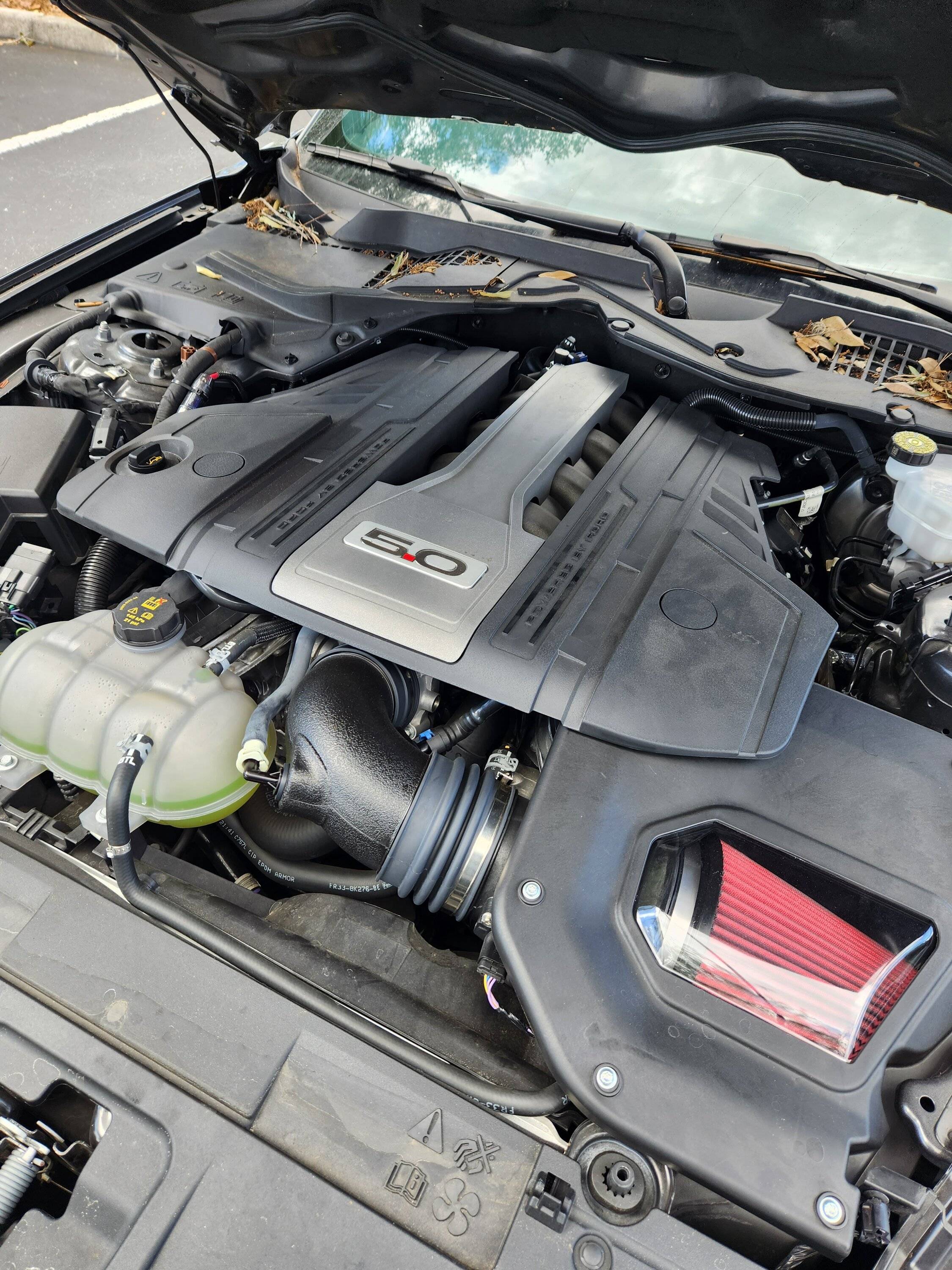

I have a closed box intake, which makes it even more confusing why the IATs are so ridiculously high
I'll probably look into some heat shields.

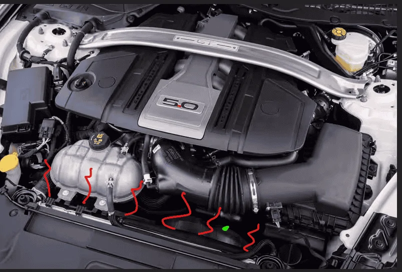

ya think it might have something to do with your MAF sensor (which contains your IAT sensor) being like 2 inches from your radiator now with a whole bunch of plastic surrounding it now?
yours is where the green dot is. this is stock, the blue dot.
red lines are radiant heat.

The transition point from the box to the inlet tube isn't sealed. It's not as bad as the 13/14 Shelby's but hot idle air will get in, plus the heat from under the hood and the IATs will skyrocket. The IAT1 will come down to ambient when you move. The IAT2s will usually be 20 to 30 hotter. Under long periods of boost the IAT2s will get hottest than that and timing will get pulled.
