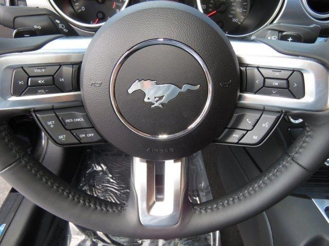

Cncl button on the wheel does the same thing plus you don't have to move yer leg..
