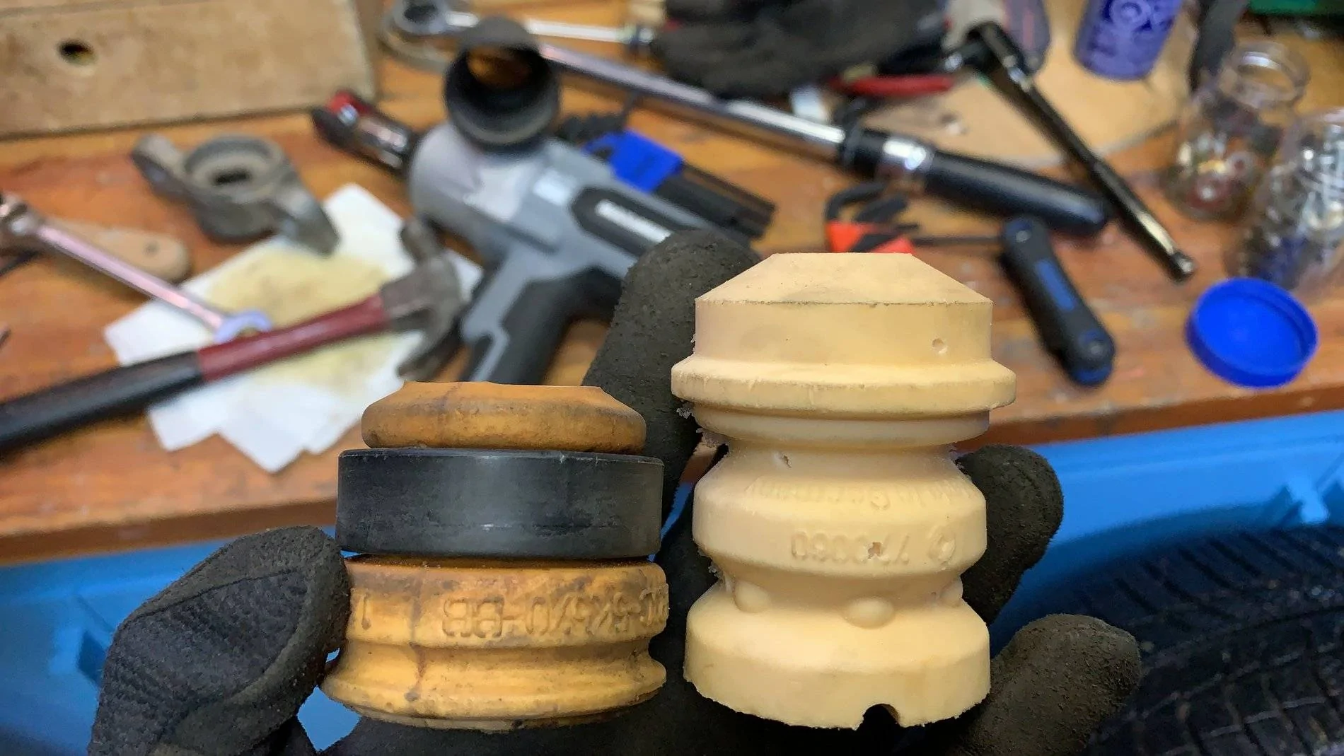

Just to be sure - should these still be trimmed down to the same height as recommended by lowering spring installation instructions? I have seen that they’re more compliant than stock and do not include the collar, and that folks are drilling them rather than cutting them. What has your experience been with them?
I am installing the sp763 springs, FRPP dampers, and a CB005 on a 2018 GT, non-PP. I also have the lower front K-brace and PP cowl extension (no strut tower yet). 19x10 wheels with 285/35 going on later this spring.

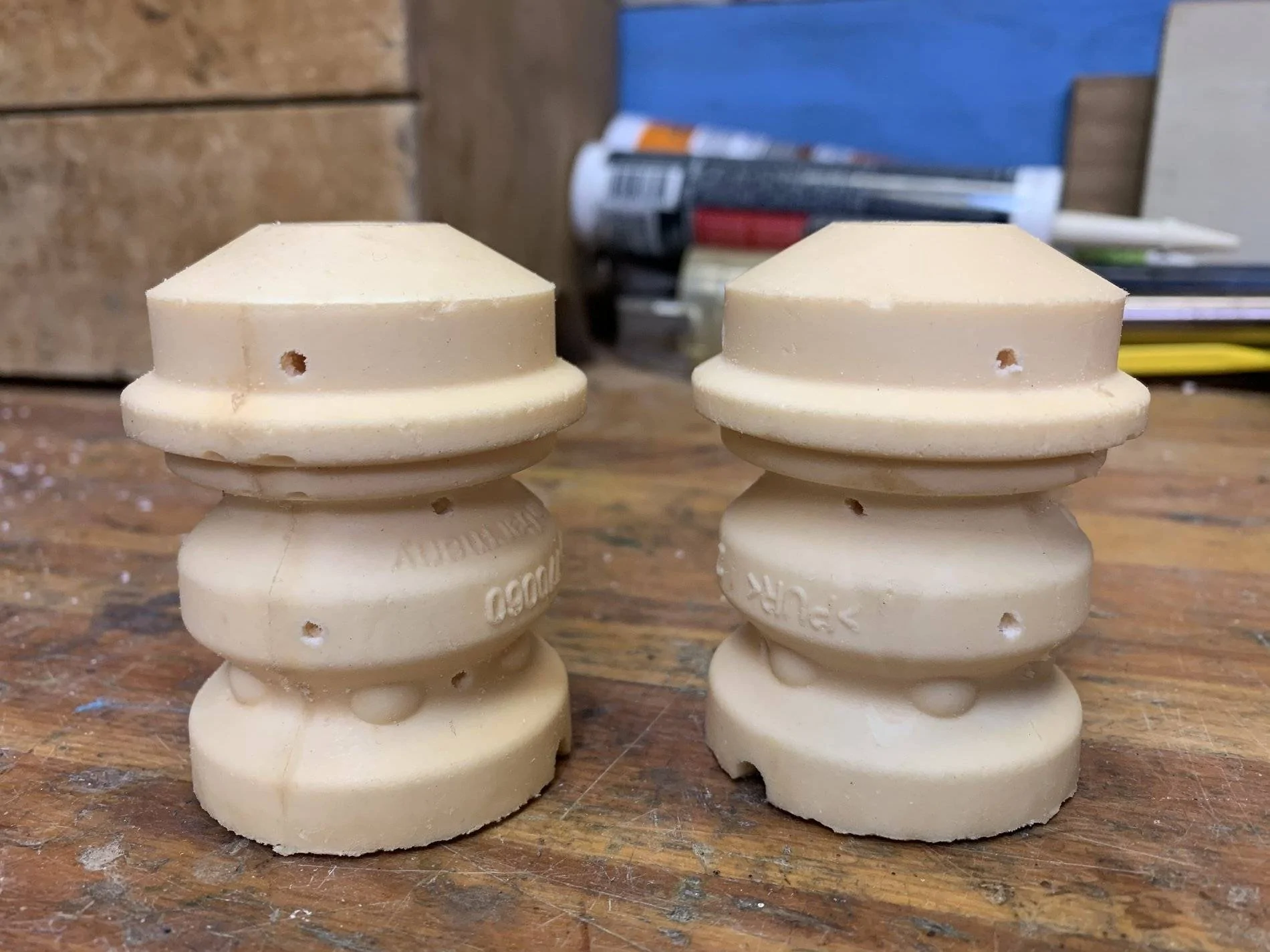

I didn’t trim them because they’re .24” shorter than the stock ones, a lot more compliant; I drilled some 4mm holes (I’m Canadian so we do metric and imperial haha) in each section to allow for more compression. While I’m still dealing with a noise and feel issue that I believe is attributed to failed factory rear shock mounts, these bump stops have been solid so far.

Thanks for the feedback. Did you create a single hole in each section or do you have multiple per section at some degree of spacing between?

I thought that would be the case. I chose to drill 3 holes equally spaced apart. It was a bit of an experiment and I think it worked well enough. I figured it would give them additional compression that would help me in winter. Biggest issue is the freezing temps making your bump stops harder and less compliant over even rougher snow and ice covered roads.
