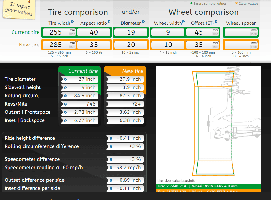

I put your data into tire-size-calculator.info. I assumed you have a base GT with 255/40R19 ET 45 OEM and that your new wheels are 20 x 10 up front.
Compared to the 255, your setup is 0.41" greater in radius and sits deeper into the wheel well by 0.11". You could do measurements to see if things will rub.

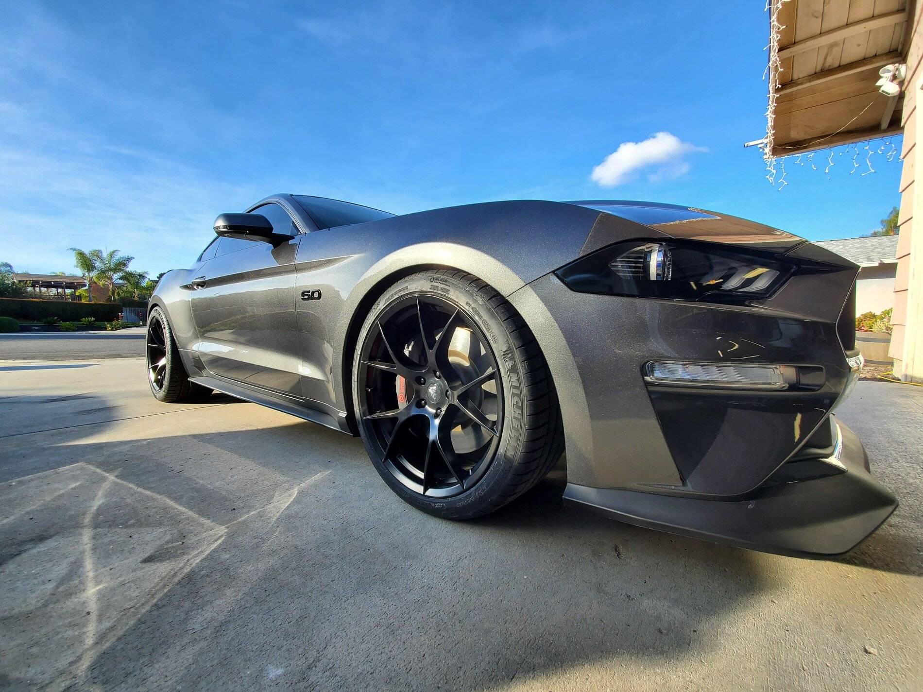

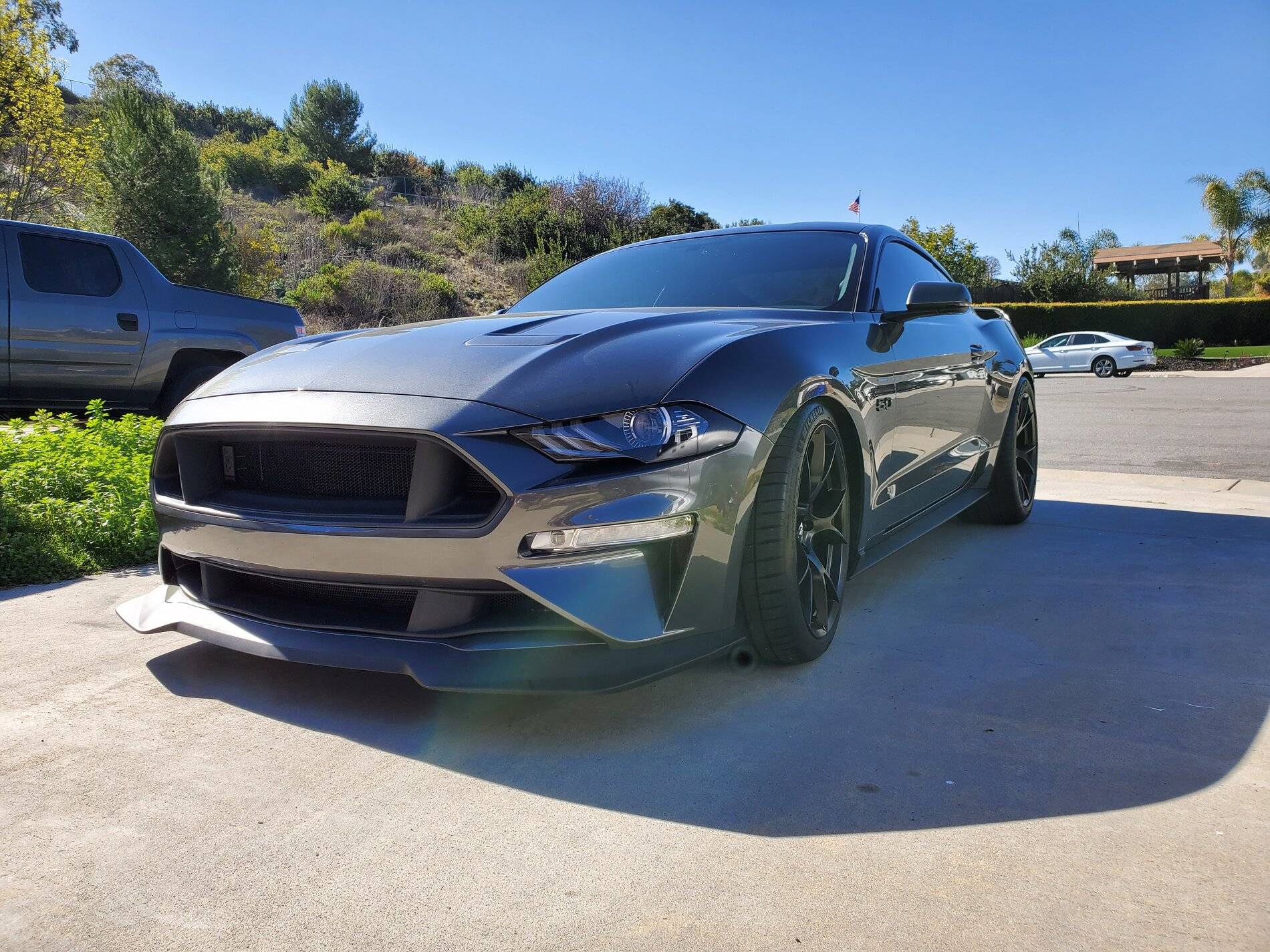

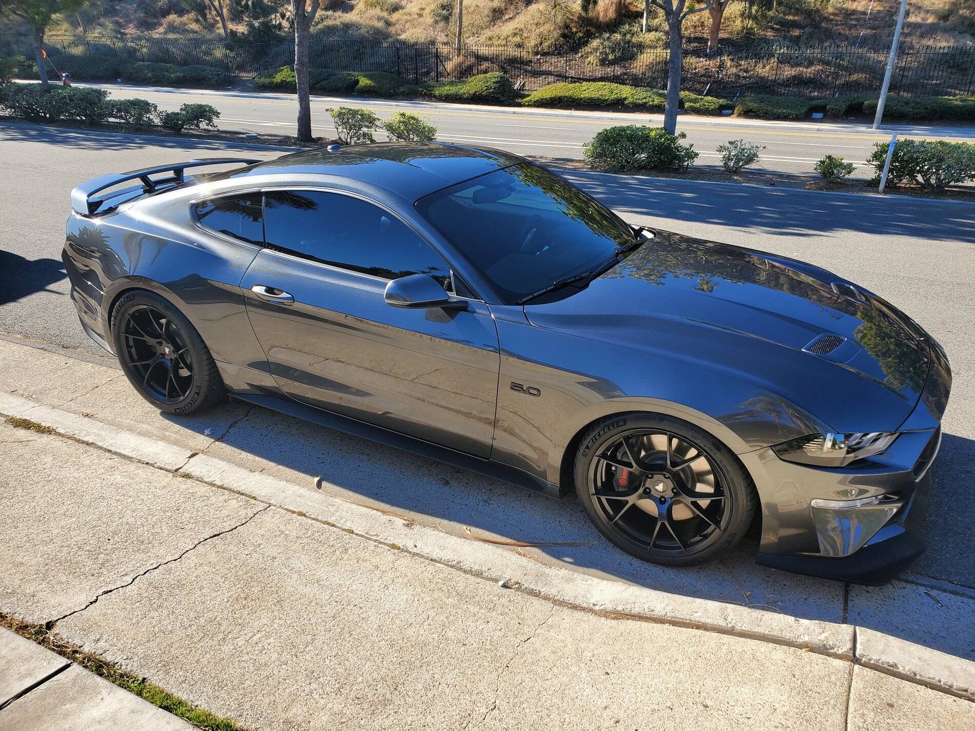

I'm on that exact setup (Ford Performance springs, but still the same 1" drop). Zero rubbing issues.

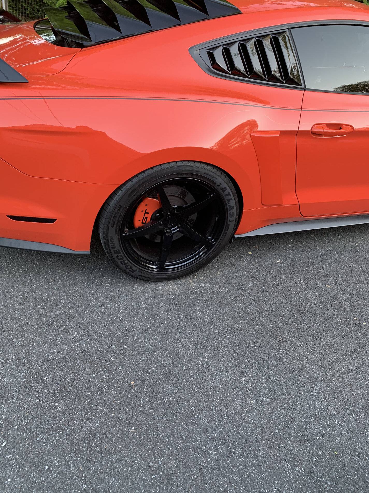

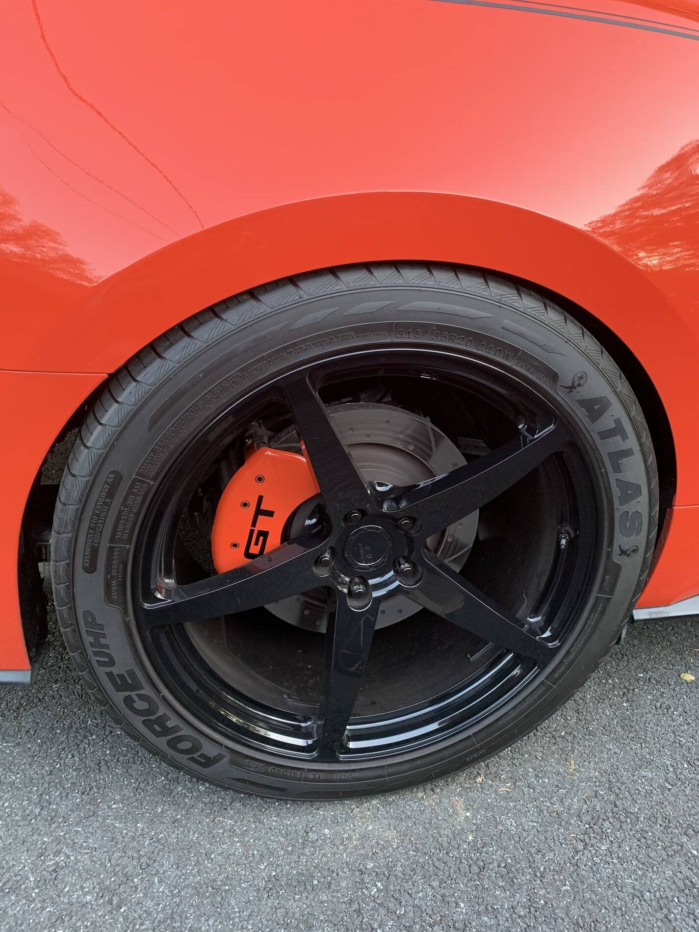

Front will be absolutely fine. Rear set up will be extremely tight and may rub very slightly depending on which tire you run and your camber. I’m running a 1” drop with 20x11 +50 wheels and 315/35/20’s with factory stock camber settings. I get a very slight rub every once in a while over certain dips in the road.

The spacing between tire and fender might come down to your drop springs. I went back and looked at pics I took after getting my springs installed and I definitely had more of a gap then. Looks like my springs settled quite a bit since then.
