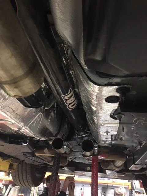

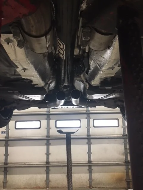

wanted to thank you for your awesome post, you convinced me this was a must have mod. I installed it today, along with the resonator delete, and BMR Jacking rails
Like you said mo vibrations, it is smoother, especially when banging gears, I am a happy camper
