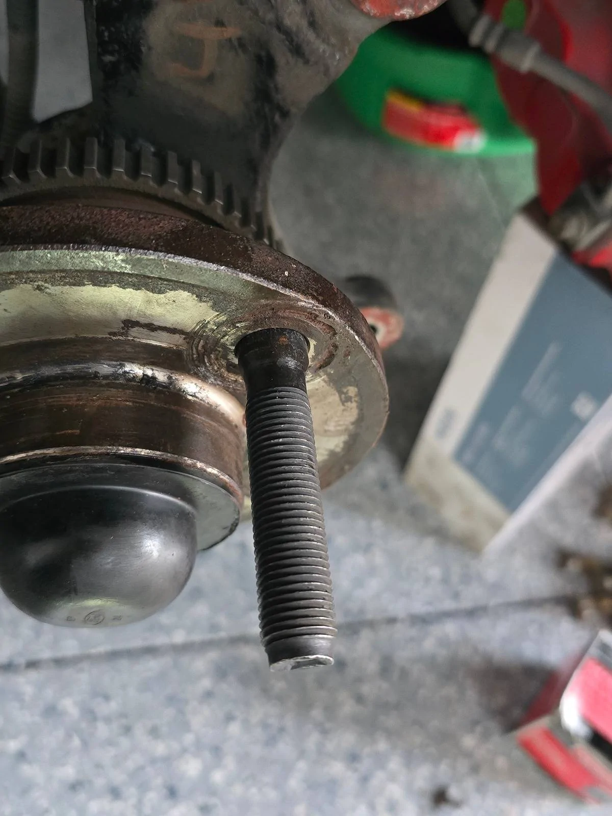

I've been researching this off and on and I ran across a thread where someone had used F250/350 lug bolts as a direct (but longer) replacement for the Mustang 14mm 1.5 lug bolts. Anyone know the part number? I can't find the thread. May have been on a different site...

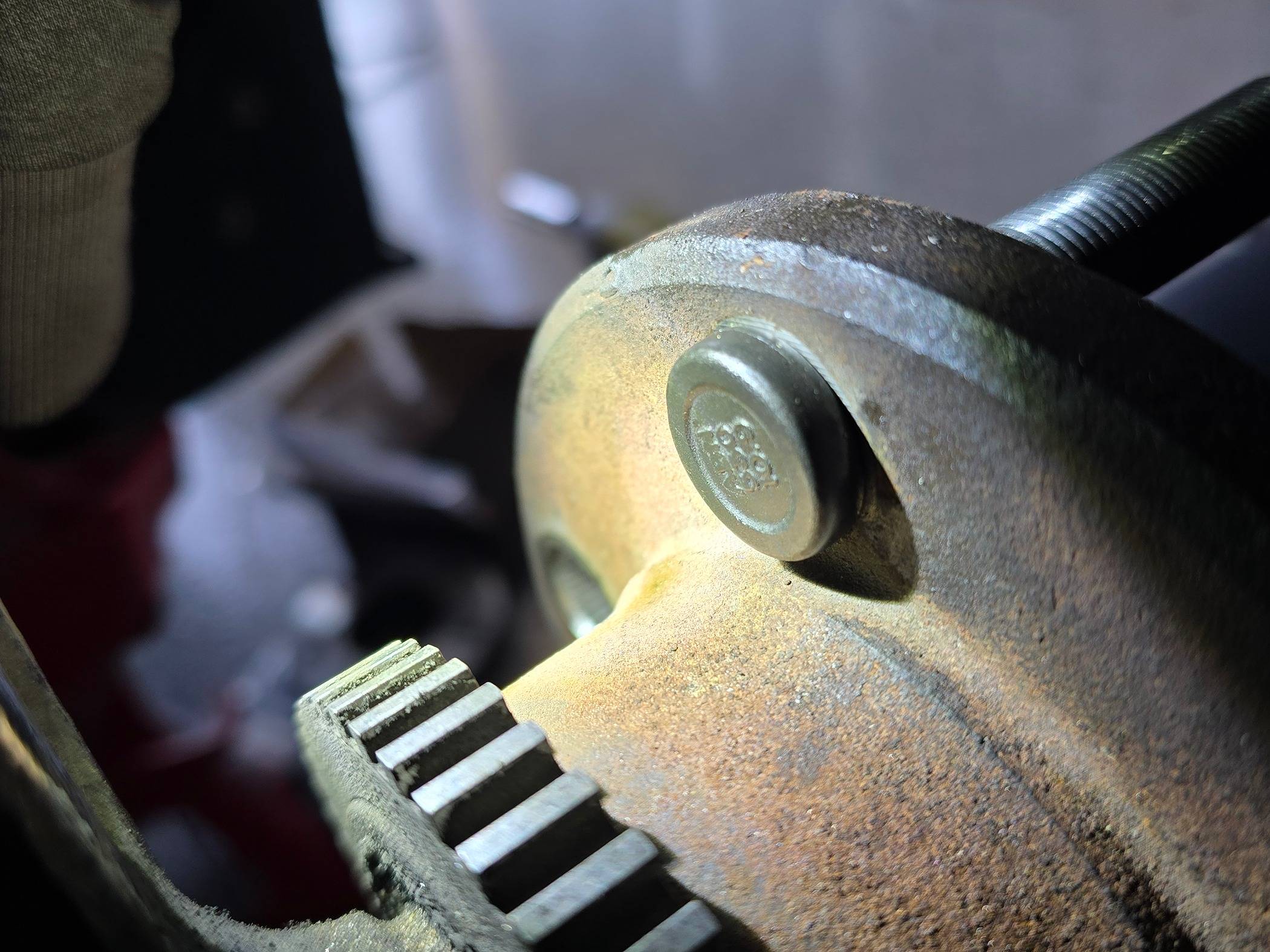

It was on this forum as that's what I use. Mine are the Dorman 610-530. They ship with a round head that's a little too big to clear the center hub, but you can just grind a little off the one edge to allow them to install and fit the hub properly.
Had a hell of a time with Amazon trying to only ship me 1 stud when it was a box of 10, or their packaging letting some slip out, or just losing the order altogether.
https://www.amazon.com/Dorman-610-5...keywords=dorman+610+530&qid=1713366784&sr=8-1

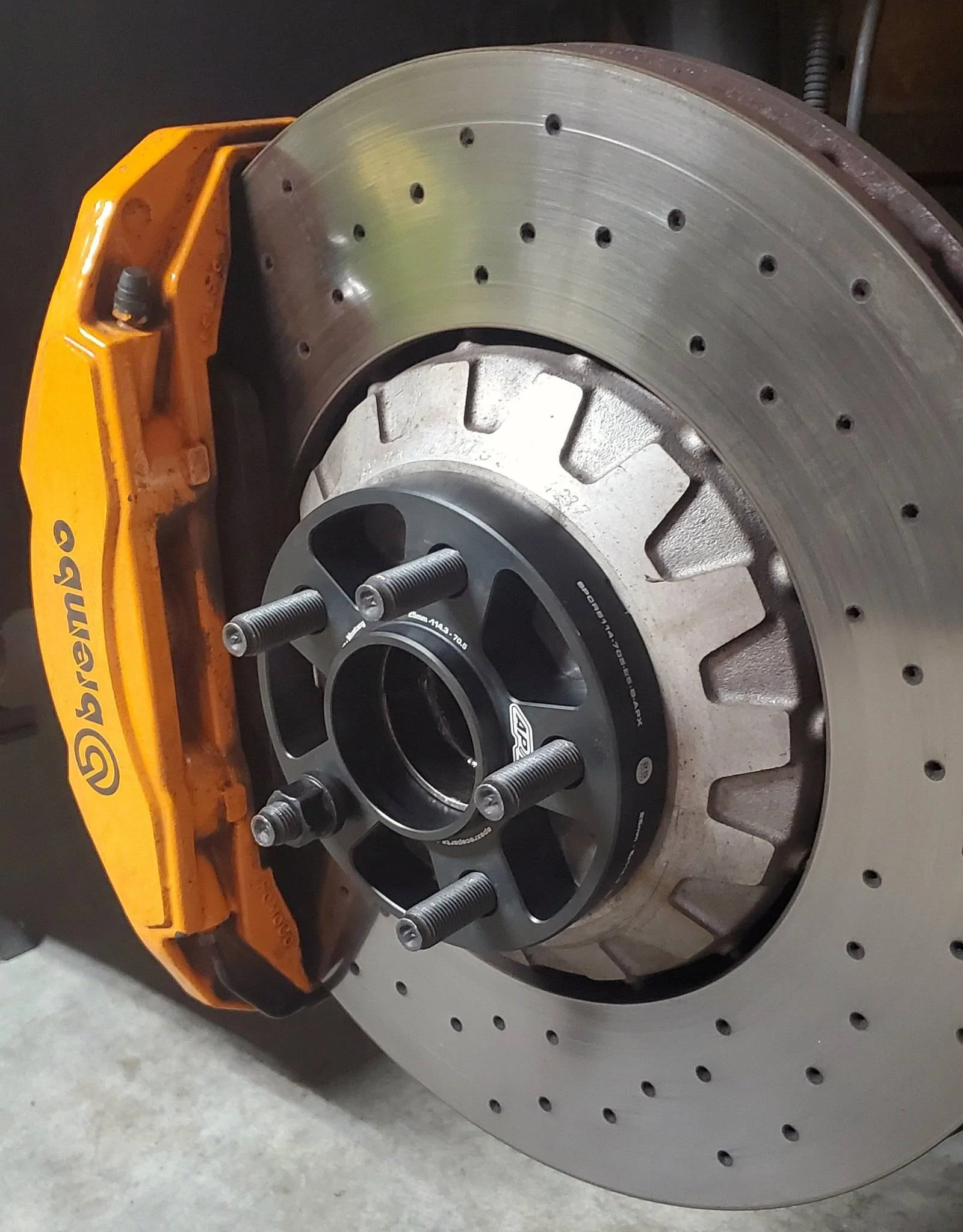

This is them with a 25mm slip on spacer.

We put on $98 APR 3.5” extended studs, $120 25mm APEX wheels hubcentric spacers, and it was a $40 tool with 20 minutes a hub to put them on.
Just do this and save yourself any potential problems.
Safety trumps cost. Always.

so based on the suggestion on this forum from someone, I bought one Dorman 610-530 to experiment on my old hub and check to see if it would work. I was surprised I didn't have to clip the head contrary to what people mentioned about head needing to be clipped. The thick shoulder means these studs can only be used with some kind of spacer. I tried a 8mm, 25mm spacer and both worked. I wish I knew about these studs before buying the ARP one and FP hubs, would've saved some money.

So you can tell me the difference in length between the Mustang lug bolt and the Dorman?
The Dorman bolt is considerably longer. I'm running a 25mm spacer on a 19x11 wheel here with a +52mm offset and you can still see the stud poking out through my open ended lug nuts.
I wonder if thats a difference in the GT vs GT350 hubs that causes that. Good to hear that things may be even easier for OP if he goes that route. The shoulder is kind of thick, but even on my street wheels I have no issues running them with open ended lug nuts.

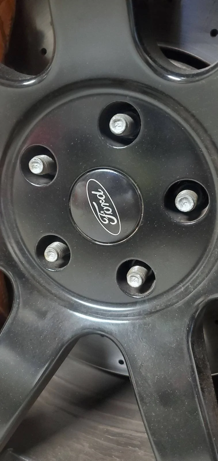

you're running your street setup on the Dorman studs without any spacer ?
mavisky
Nov 17, 2018
2,385
3,291
Cumming, GA
Kyle
2018 GT350
Yep. Excuse the filthy state of things, but you can see how far the open ended lugs are down inside these Project 6GR wheels and still the Dorman studs extend past the surface.
