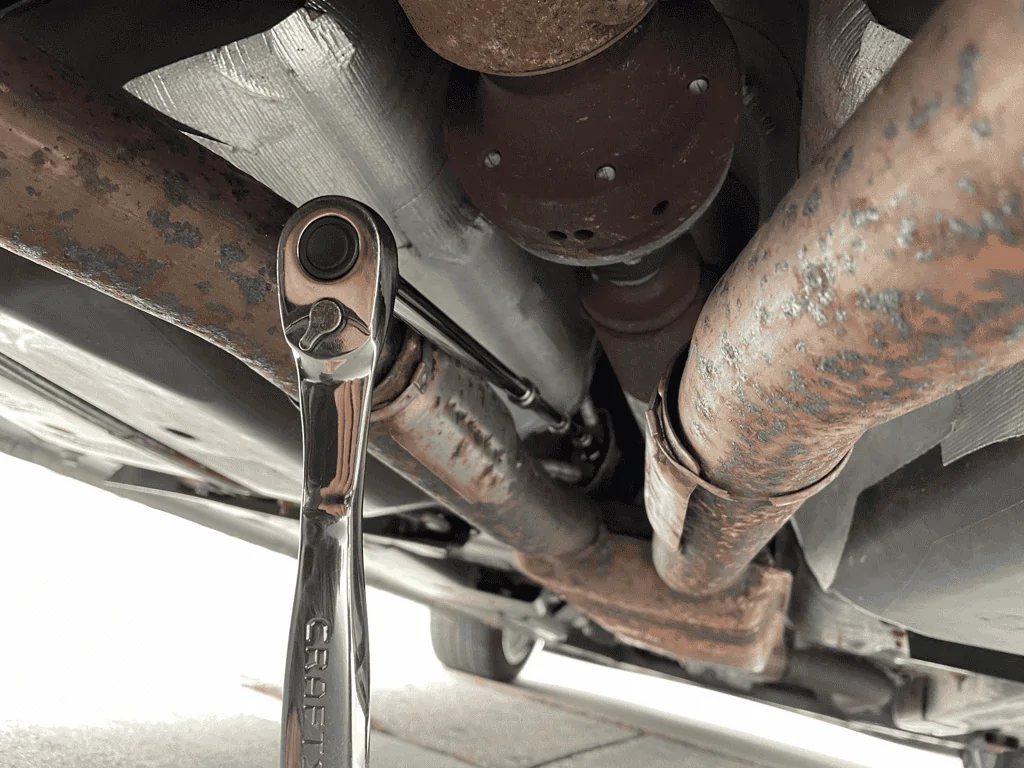

It can be adjusted. See this thread for details. I really should get under there myself, as mine's become uncomfortably high/loose over the past couple years. There's a good bit of talk in that thread and service manual pages detailing the procedure, but unfortunately, to give you an idea of what to expect in reality (without a lift)...
...yeah. It'll be a fun one for us. 🤣

Appreciate the emergency situation, hope everybody is OK. To recap everyone's feedback:
  • Tighten up your brake cable (every extension you have on your ratchet)
  • Always always always leave the car in gear
