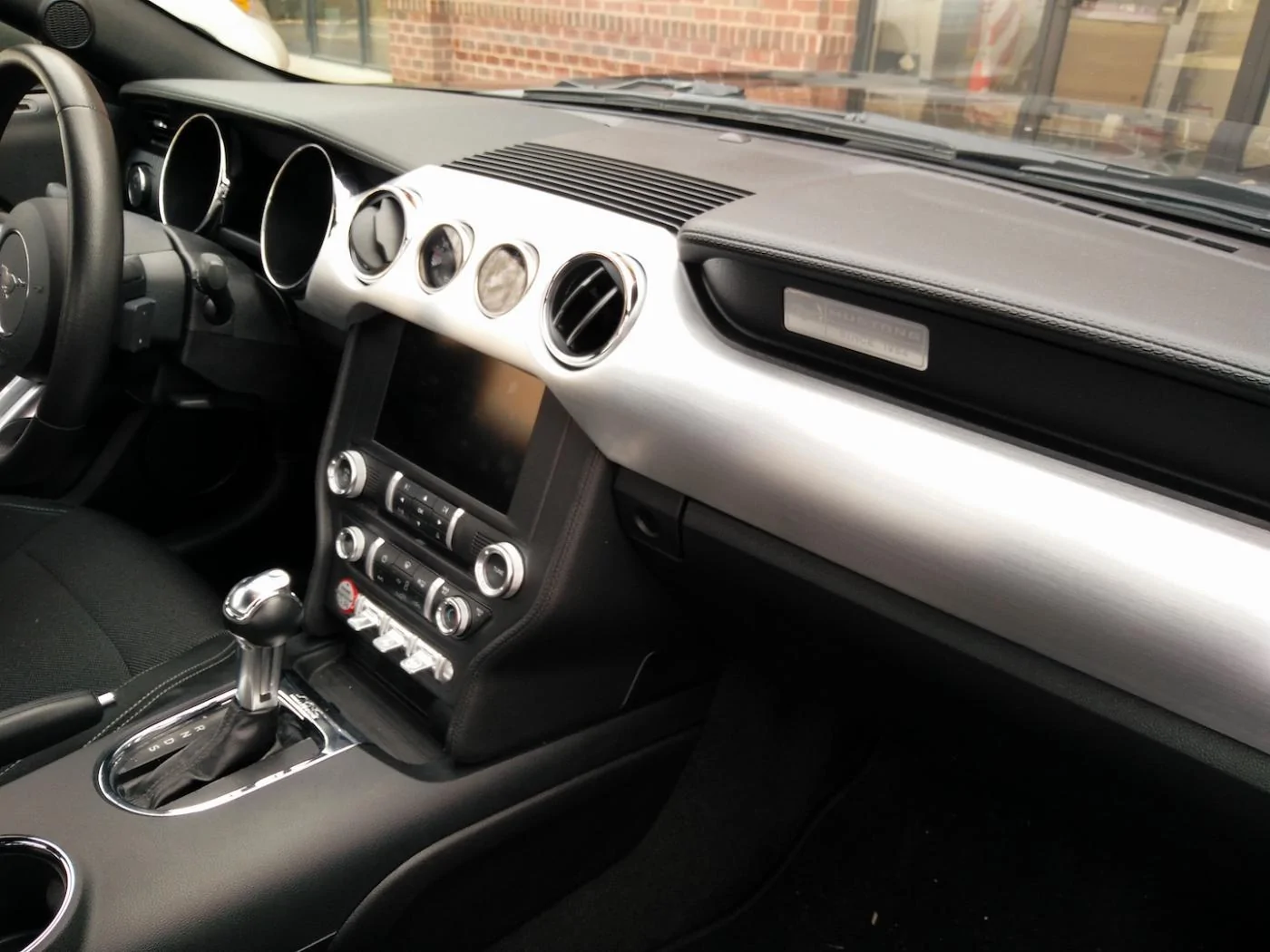

Daylight pics!!
(I know my passenger side is dirty....)
pumxee
Dec 10, 2015
42
452
57
Calgary
Hamza
2016 Mustang v6 DIB
Daylight pics!!
Zack what kind of bezel is that around the infotainment unit?
Is that whole thing the base v6 panel with your printed toggles?
zackmd1
zackmd1
Oct 1, 2013
140
5,283
3,451
Maryland
Zack
1970 Mustang, 1965 AC Cobra, 2023 Ford Bronco 2Dr
It is a prototype bezel that I made before I decided to go with the OEM MFT bezel.
Those are my toggles yes. They are the higher end set that have been finished in an aluminum paint.

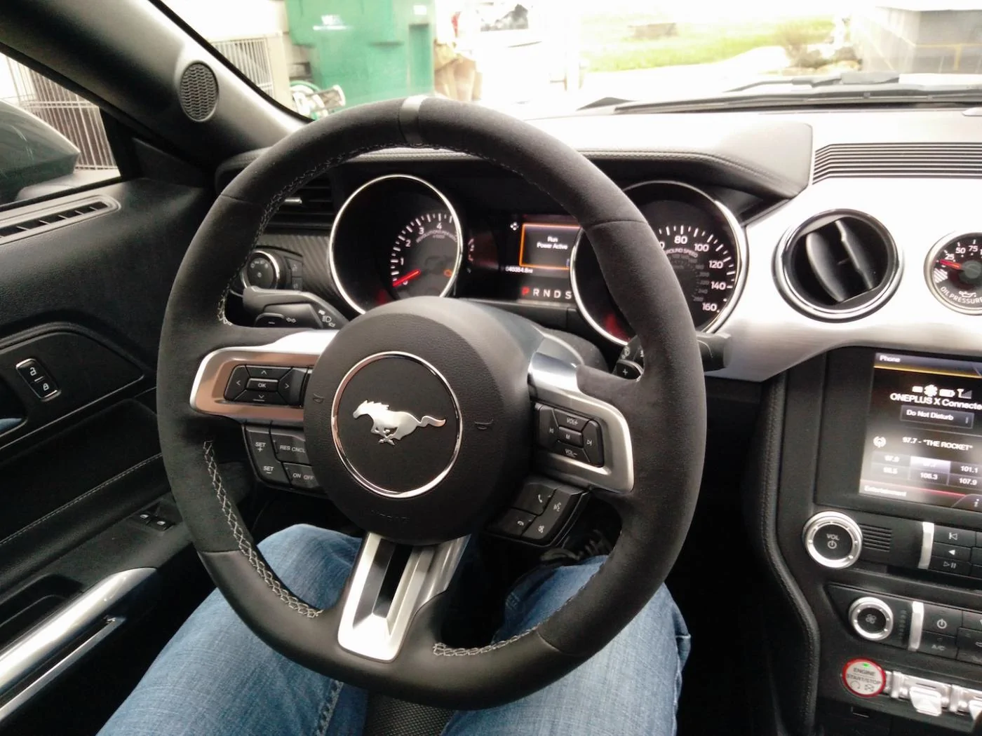

GT350 Steering wheel installed!
