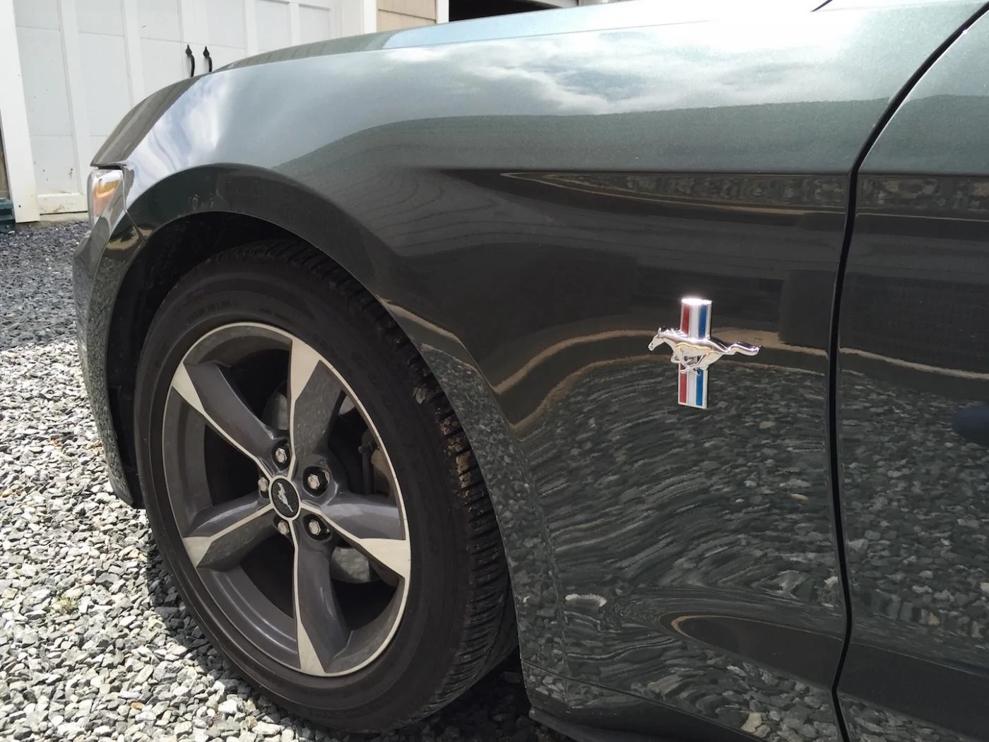

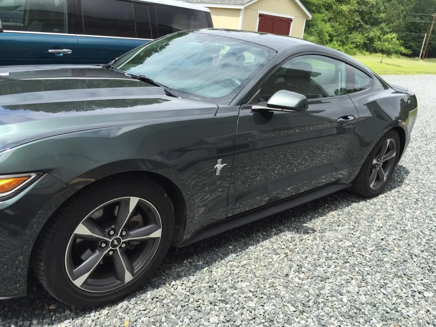

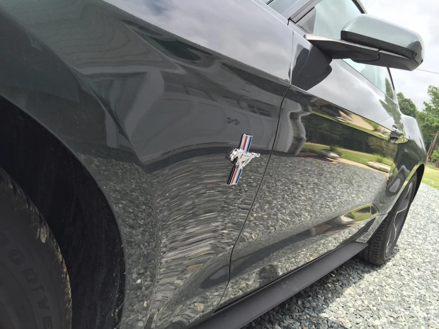

Emblems installed!
Got these on today before the party started!

^^^^ very cool! They stick on? How firm are they affixed?
They have automotive grade adhesive tape on the back! Very well attached! The only way you will be getting these off is with a heat gun.

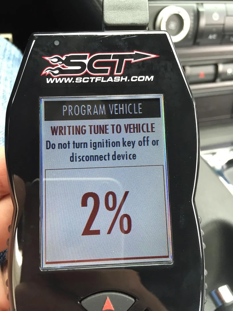

The car is now officially tuned by Torrie from Unleashed! 93 octane tune for the time being! He is also working on a 87 tune for me for when I head back to school and want to keep costs down. :cool:
We went through 4 revisions and many datalogging sessions before the 3k hesitation was cured. He needed to add more fuel then expected sooner in the rpm band to compensate for the increased airflow. I guess thats a good thing right? Haha! :D
