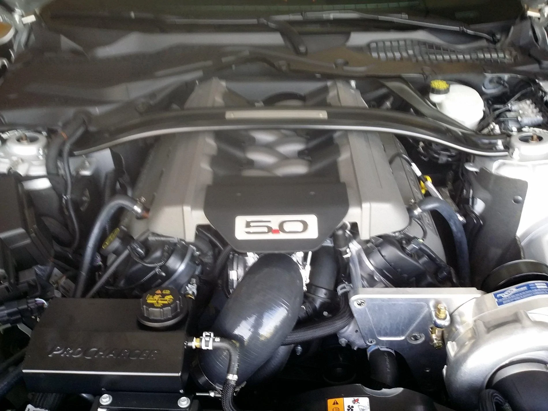

I went with a 18 mani ,.ported a locked . And I still have cover . Lol

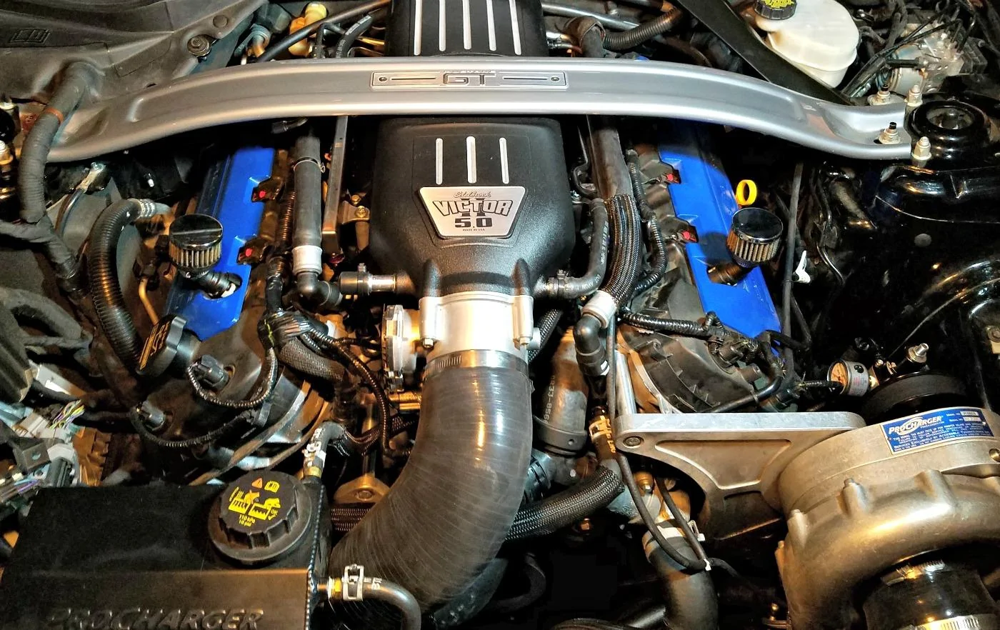

2015 with D1x. I went with the pricey Edelbrock Victor ll. Liked the looks, can run strut brace, has great options for hobbs switch
