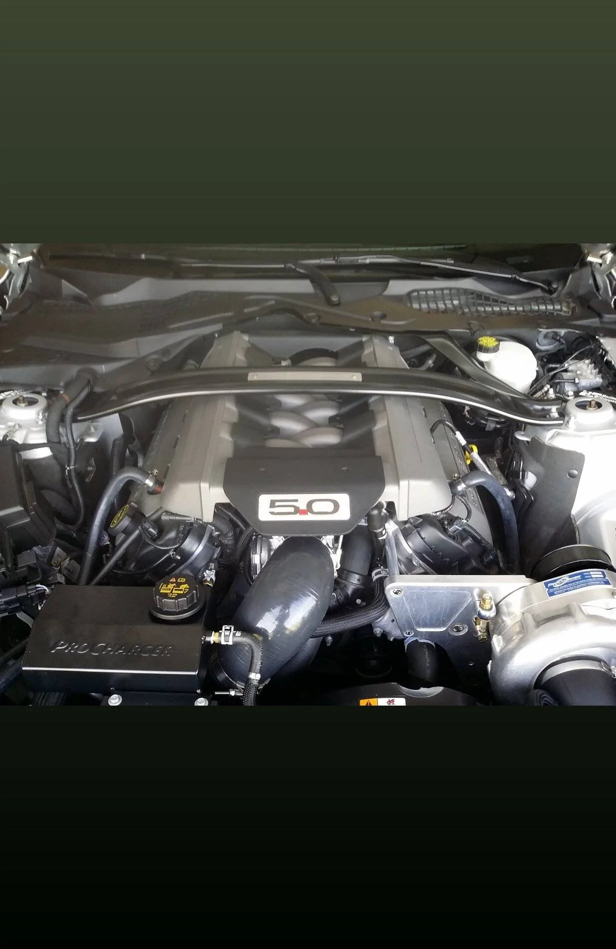

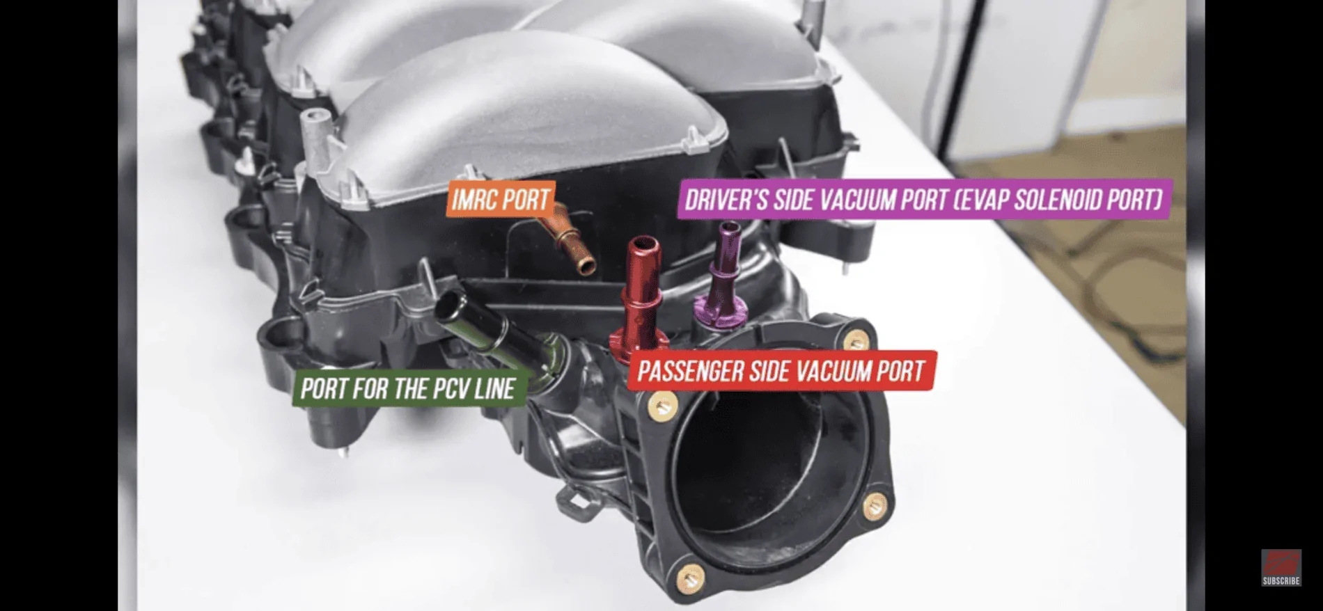

Would anyone be kind enough to share some images or insight on how to properly set up the vacuum lines with the ProCharger. My car is a 2016 with the ported ‘18 manifold from 1320 junkie with IMRC’s deleted.

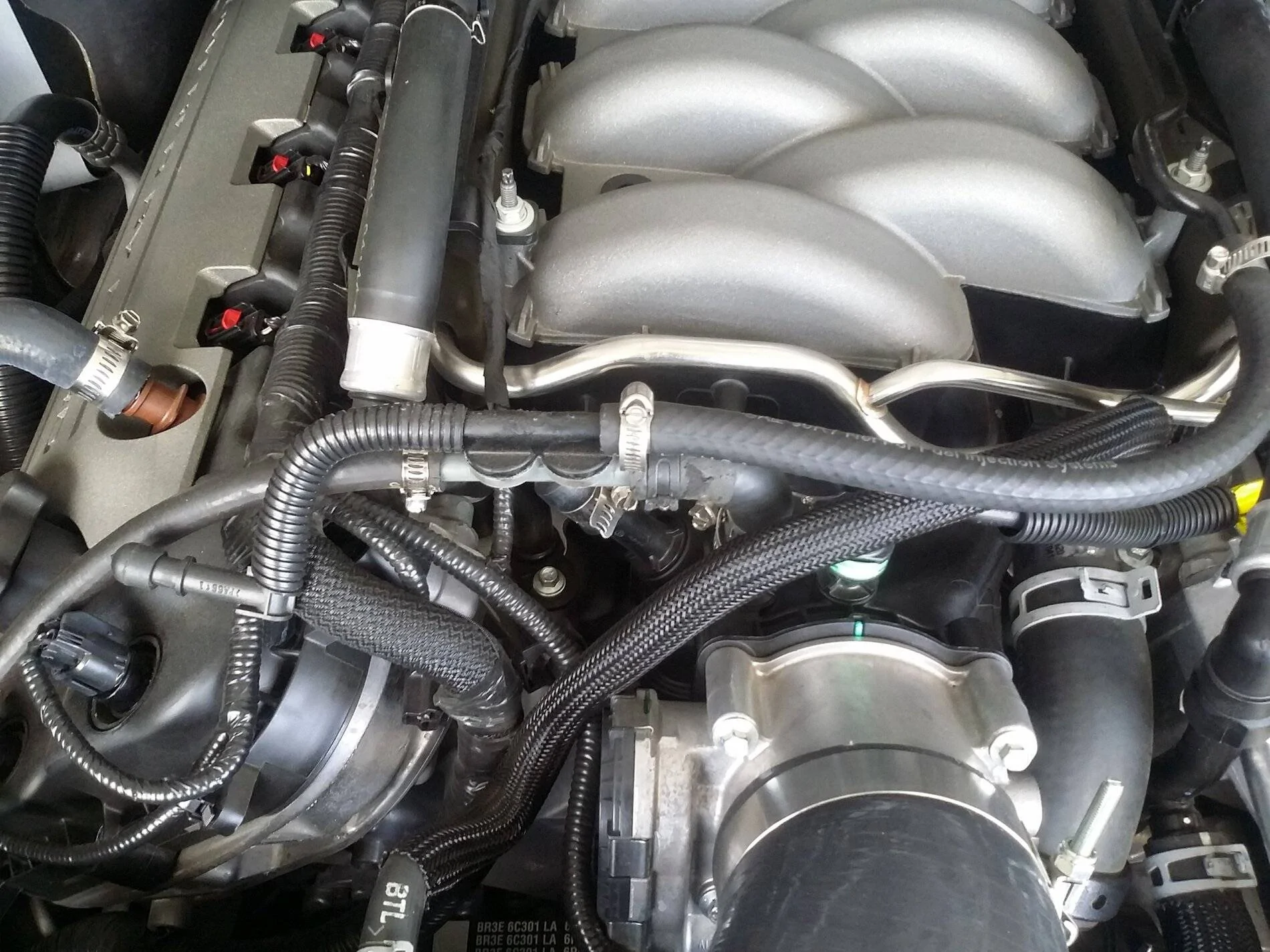

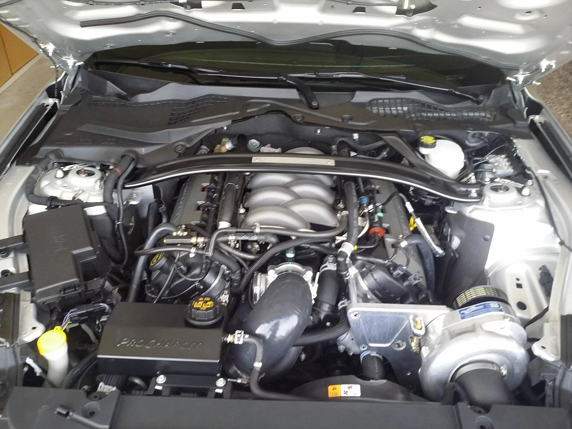

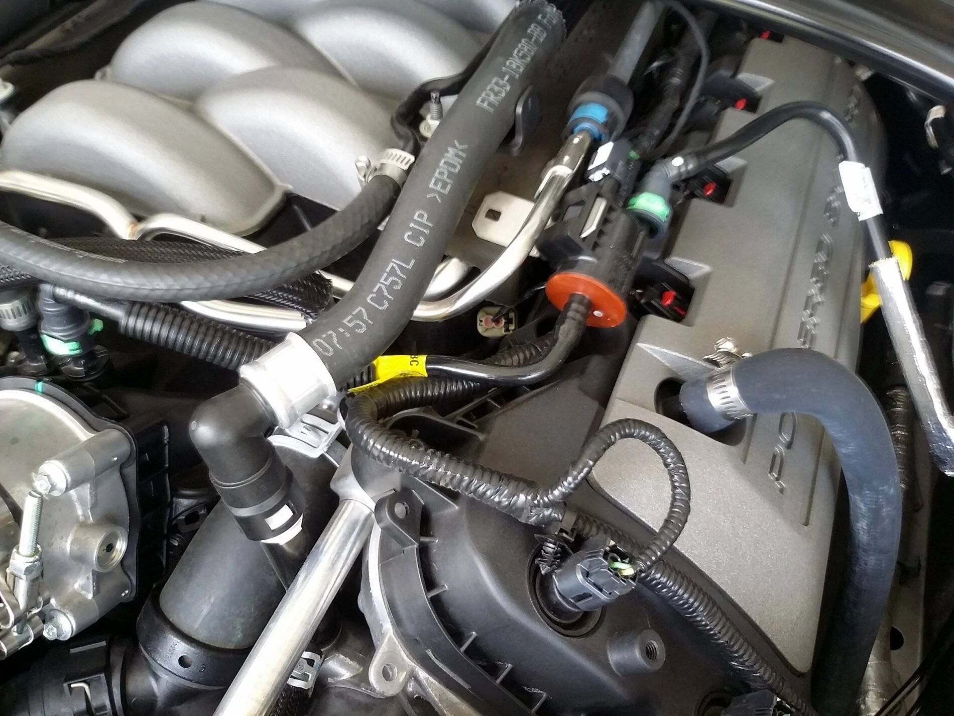

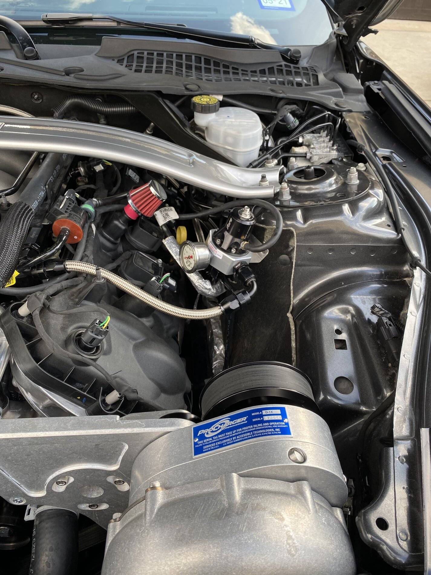

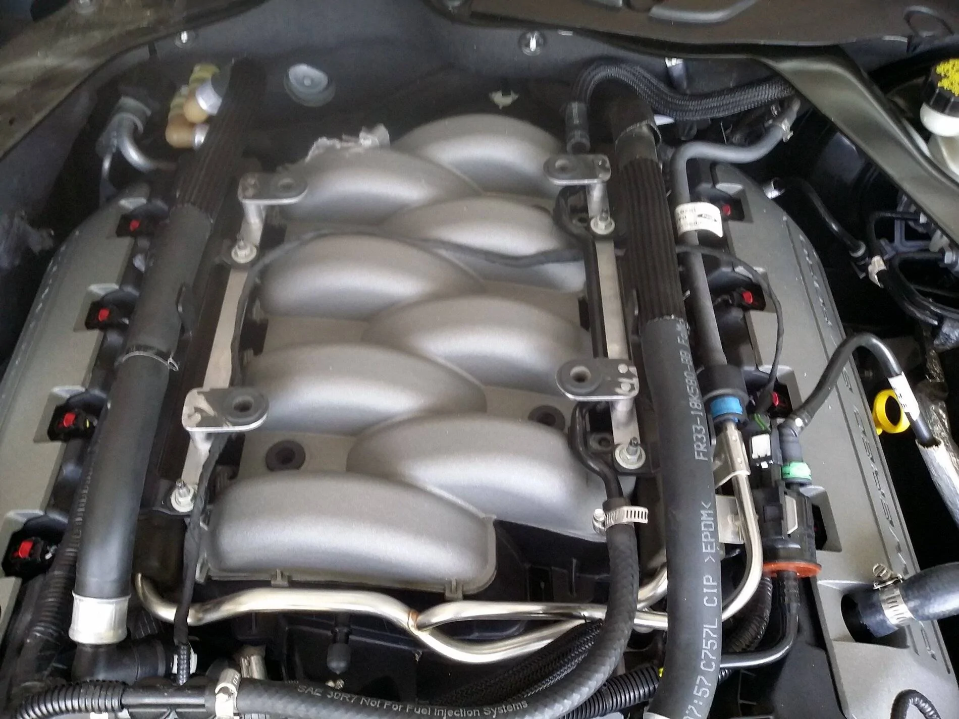

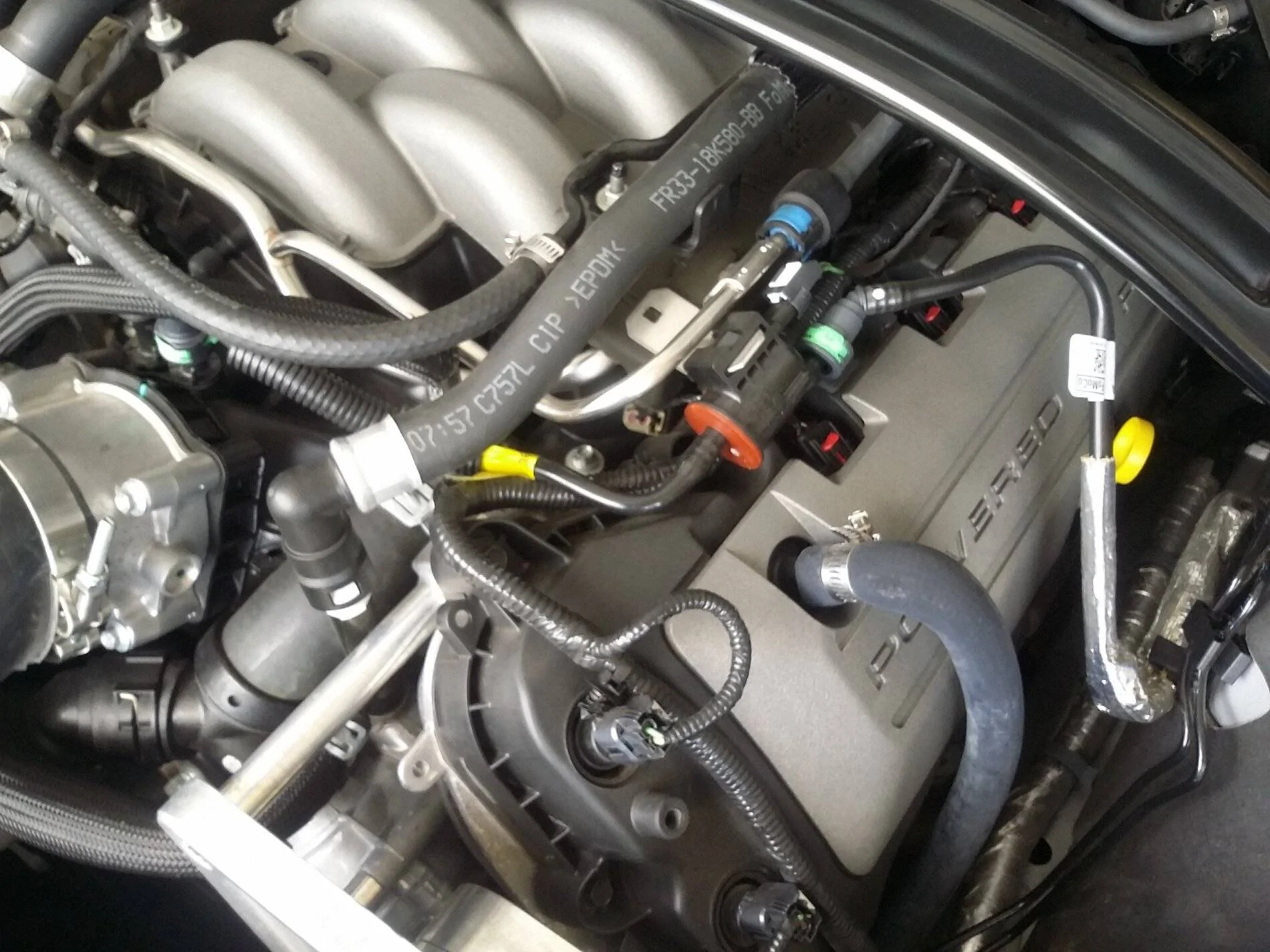

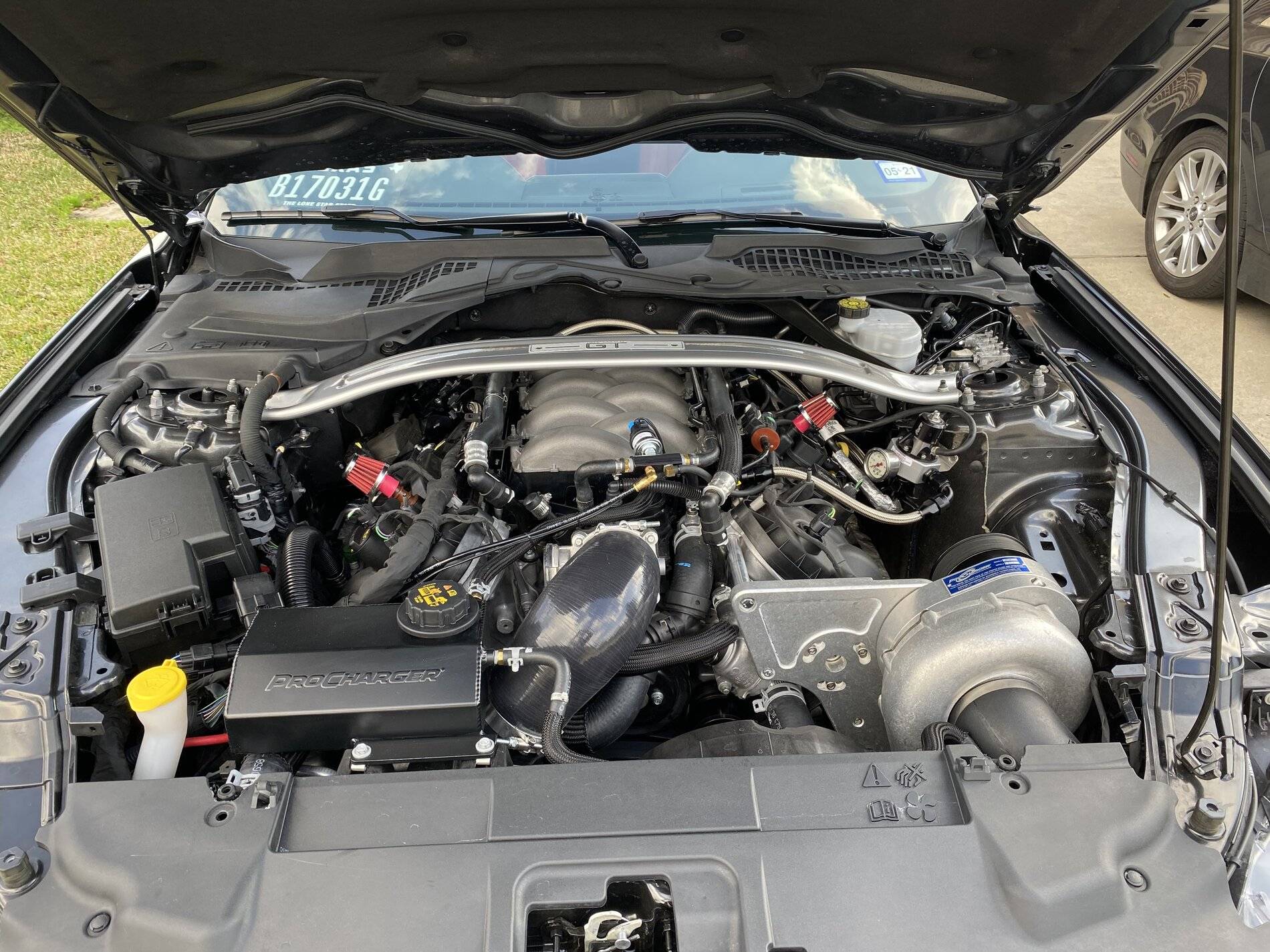

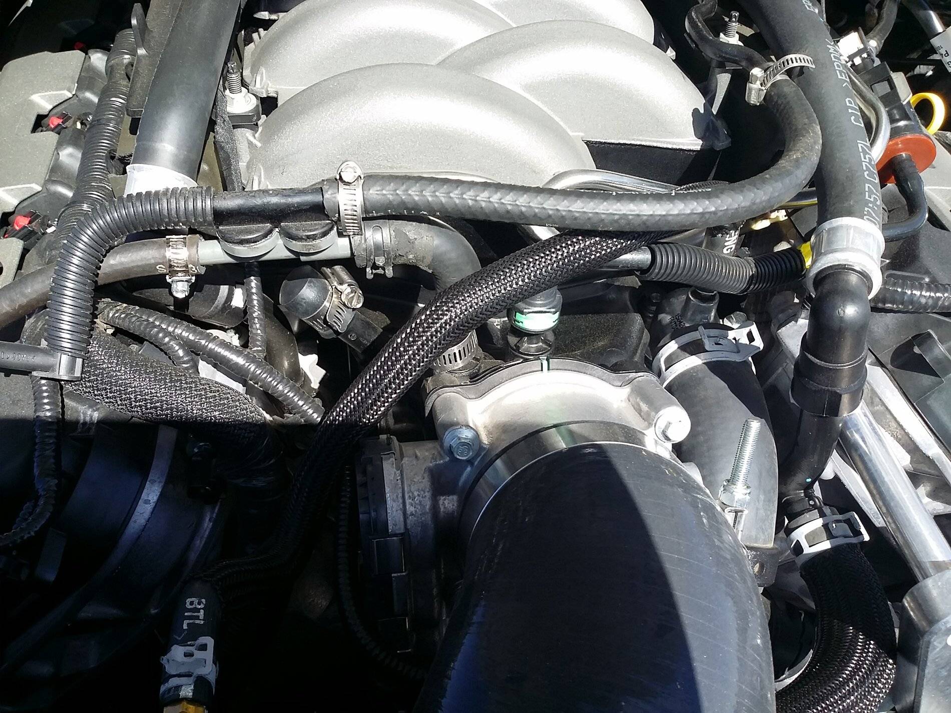

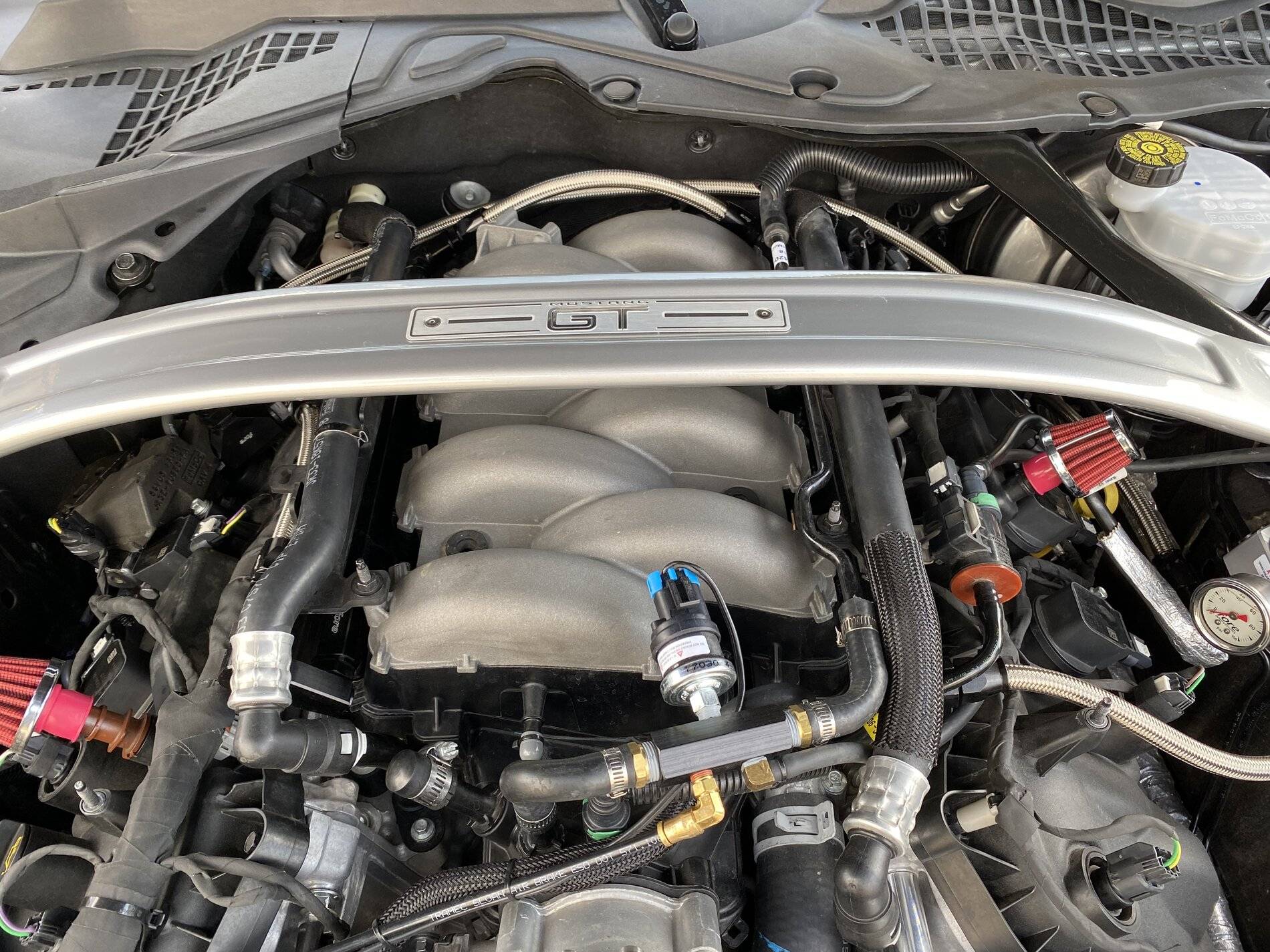

My setup on my 2018 D1x Stage 2

I appreciate it guys, thanks for the images. Just curious, what is that orange and black solenoid lookin thing by the right side of the fuel rails
fmc_smt
Jun 4, 2018
39
1,295
2,634
Cottonwood , Arizona
2015 gt , 2015 Escape , 2015 F250
That would be a 18 purge valve instead of using the 15 to 17 valve .

Two parts might have to do some digging, have them somewhere
