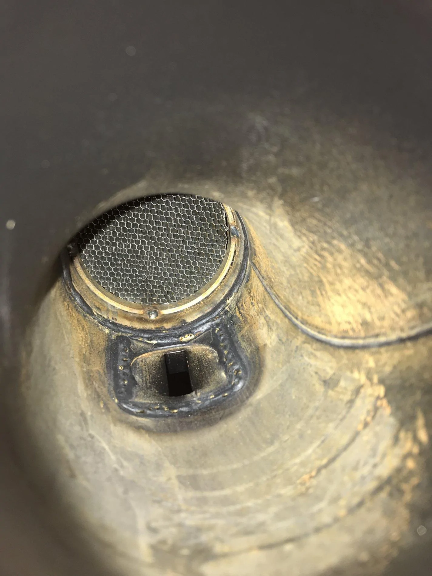

PS: The new tube isn't just a tube.... it actually got a special honeycomb structure built into it, to try make the MAF signal as stable as it was in the intercooler. The tube isn't fun to make, and it isn't cheap either lol.

Curious if the honeycomb thing inside the pipe you speak of interferes with airflow/boost at all? I'm guessing an immeasurable amount though.

Any pics of the new tube and location?

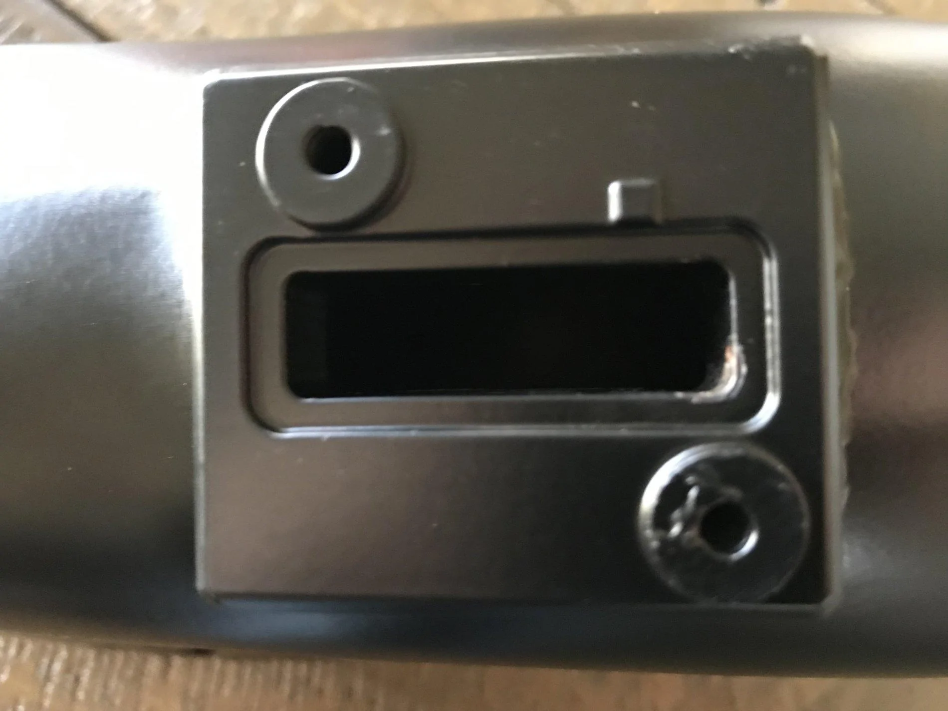

No pic but it goes in the same spot as the current cold pipe, Between the 90 exiting the IC and the 90 on the TB. MAF is connected on the bottom of tube pointed down. Install the Maf in the tube before putting the tube on. The MAF extension that comes in the original kit is plenty long. The only thing I didn't like was the supplied block-off for the IC where the MAF is relocated from. It just didn't feel like it fit good. I compare it the MMR oil squinter block-offs. Those you actually have to press or tap into place , the block-off just kinda covers it up and is held on with two screws, didn't feel like a tight press fit.

What did you do to address that? I know what I did, curious to hear :)

This is the MAF in the tube. It made a vast improvement in drivability on my car once I changed to a larger bov. I have recommended it to everyone buying a new kit.

If you go to the GT350 tube, we include it.
Also, it doesn't need to be a 1000% seal. Theres only like .0000000001 cfm that could sneak by that.
Heck even if you forgot to install the block off, it wouldn't even make a .25 psi of boost difference.
