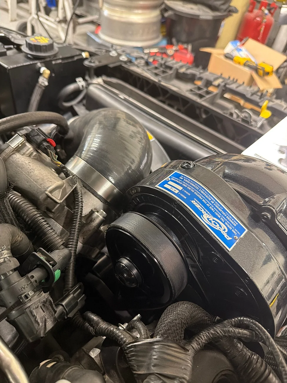

Helping someone install the passenger side style mounted procharger on a 2015 Mustang GT that he purchased from someone we knew. I believe the supercharger kit is 1FW411-SCI. (Passenger mount unit using the oem air box) It has the P1X blower upgrade but everything else is spec as included by procharger. The pulley included measured at 3.60 with a digital caliper (which matches the invoice from procharger) and the belt included is a gates K06882.

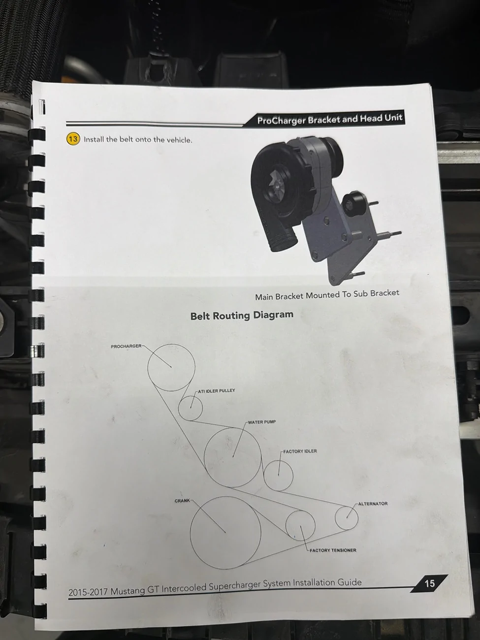

My question is, is that the right belt? we sliding the factory tensioner as far as possible and no matter what the belt seemed way too short to slide over any of the idlers while being on the grooved pulleys. The belt is routed per the included procharger official instructions as well has having the head unit clocked in the noted orientation. Nothing is bound up or linked anywhere. I’m at a loss!

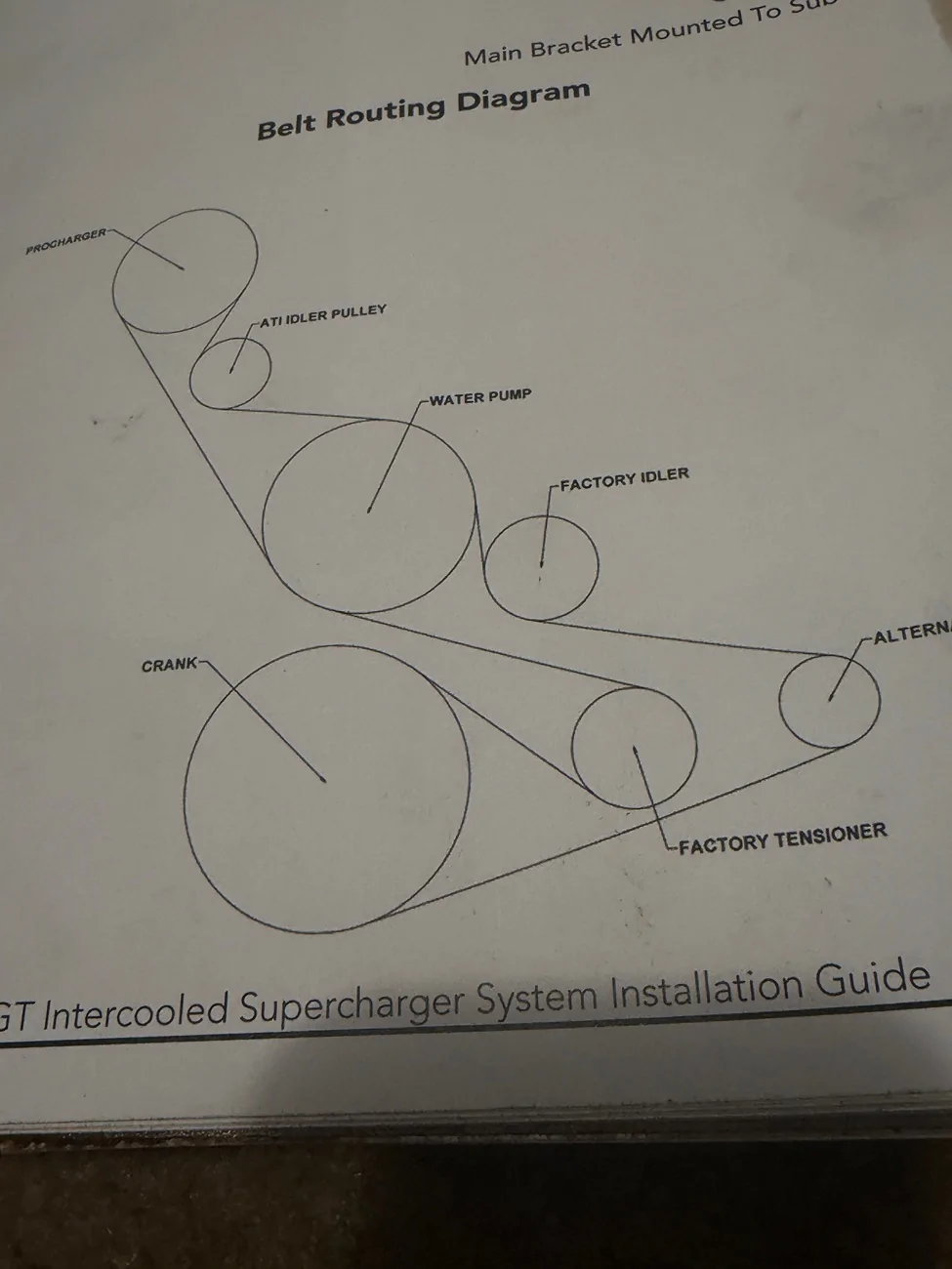

You can mount the procharger on to the mounting bracket at different angles is you could be off are you routing the belt right 100%

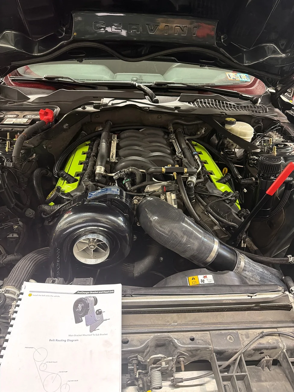

This is what he’s working with. I’ve triple checked belt routing and that’s fine, I’ve made sure it’s not caught up anywhere and it’s fully seated. I personally have an ESS car and I know the belt was tight to get on a smooth idler but this isn’t seeming to work at all. I’m starting to be confident that this is the wrong belt for this kit somehow that they sent. I’ll have to call tomorrow and verify.
