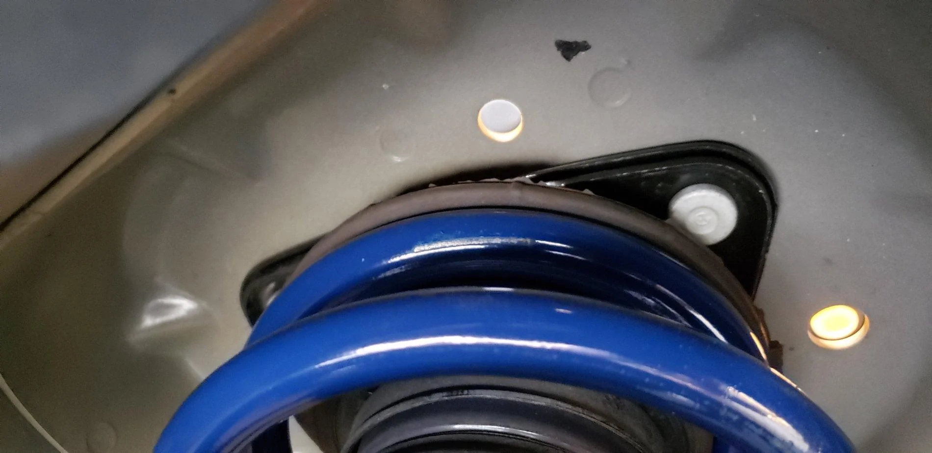

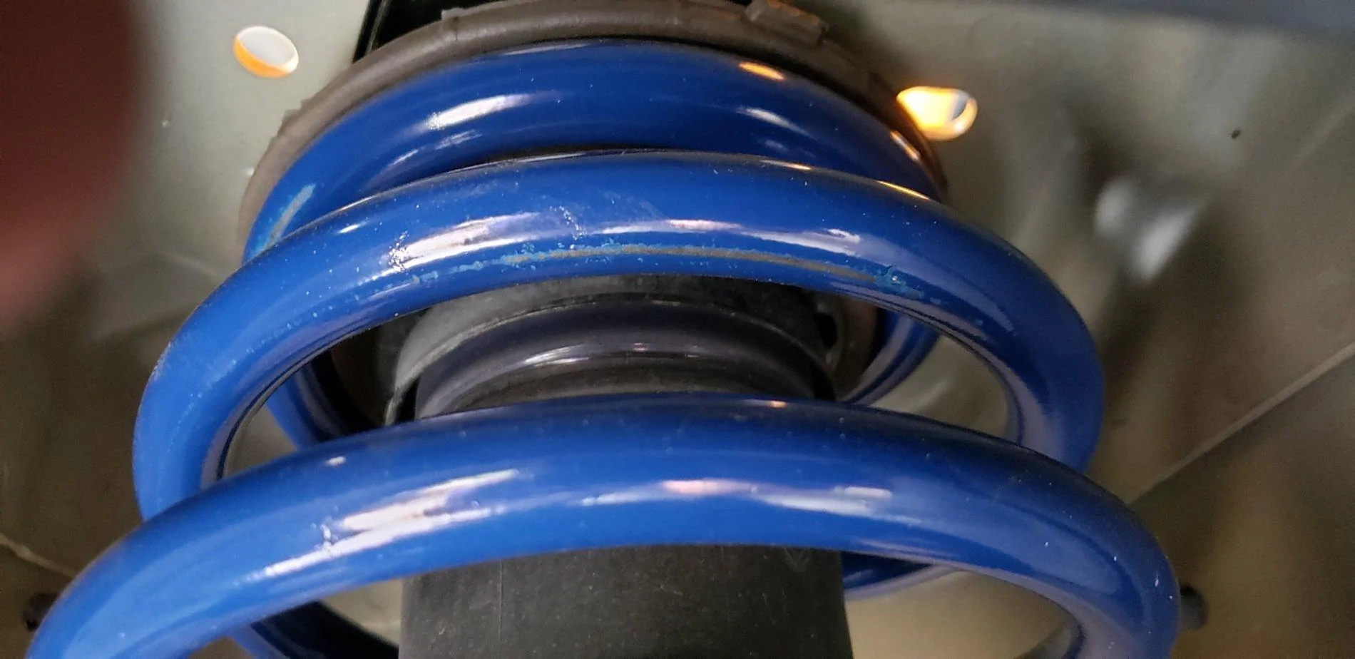

I got Steeda dual rate springs a couple of weeks ago. I keep hearing some noise in front.
I jacked the car up and tried to find the problem. It seems that the first couple of coils are sitting on each other at ride height. So that explains every time I go over some bumps or pot holes I hear these noises? I had the Eibach sportline before and this never happen.
Are these springs supposed to have sleeves with them to stop them from damaging each other and making noise?
Could some body help me to clarify on this. Thanks very much.

No, the Dual Rate Springs use no isolators. Furthermore, the first few coils are ment to touch each other. Also, the springs do not make noise. Check your torque on your strut nut and the sway bar endlinks are properly torqued. If not resolved please reach out to [email protected] on Monday.

At first I thought the nuts on the top of the struts are loose but it wasn't the case. I've tried to torque everything again but it's the same noise.
Are those springs supposed to get damaged like that?
Thanks.

The springs are not damaged. They will show contact marks as shown in your picture which is normal.How did you torque the center strut nut?

I torqued the center nut to 70ft lb and 3 mounting nuts to 46ft lb per Steeda instruction. I have Proaction adjustable. Thanks.

I have had these dual rate springs for a couple years, and I personally had trouble getting the top strut nut torqued. Work with Steeda on your issue - I had some various problems with my setup, and they were great to work with, and will take care of you. (Look up older posts by me if you want more info...)
Depends on what kind of noise you heard, it is either the strut "loose" (knock), the rubber isolator/bearing (old hinge creaking), maybe the assembly at the top is not aligned (seems OK in your pic), or something loose at the bottom of the strut. Anyway, the Steeda folks will help you!
