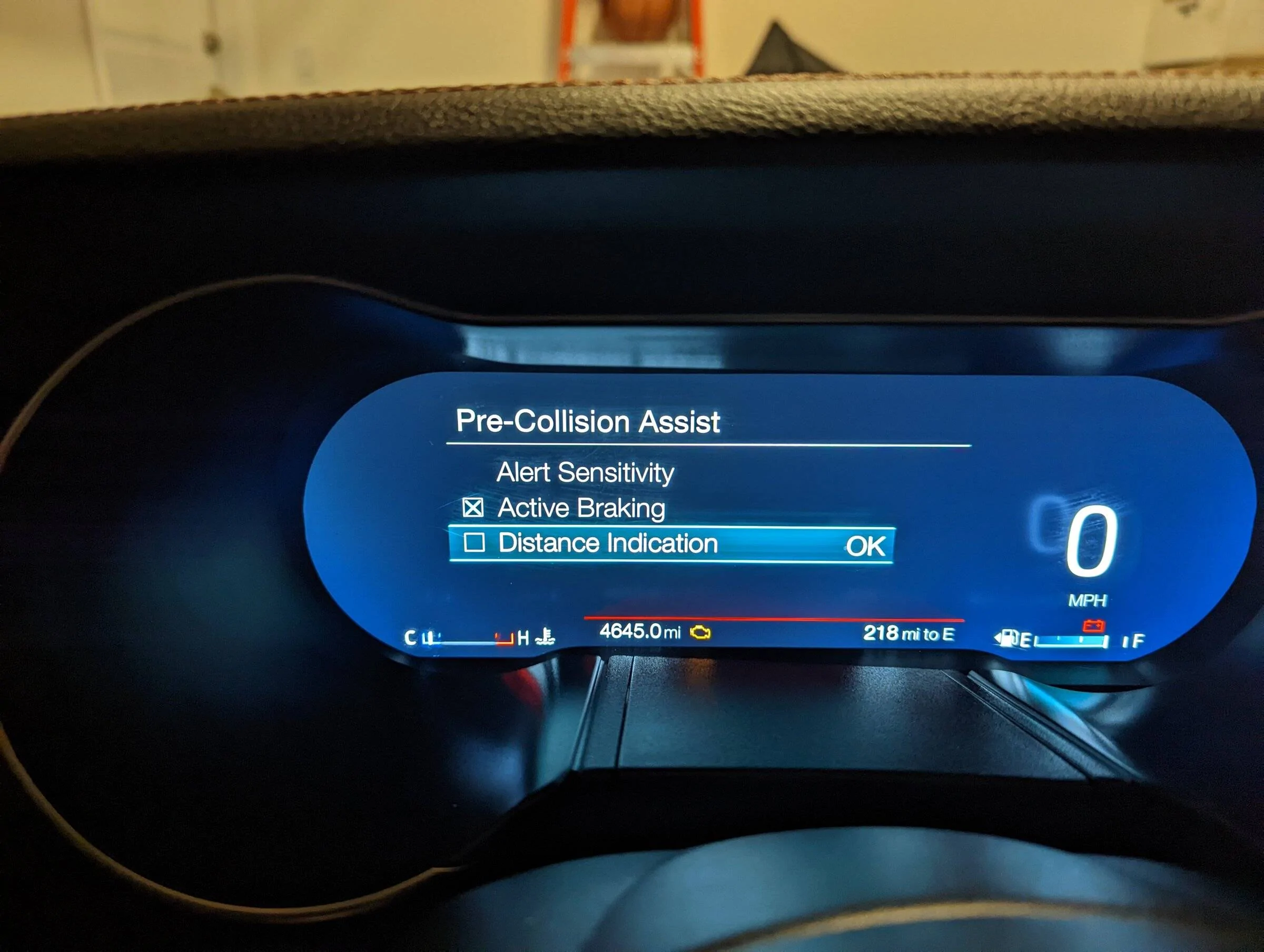

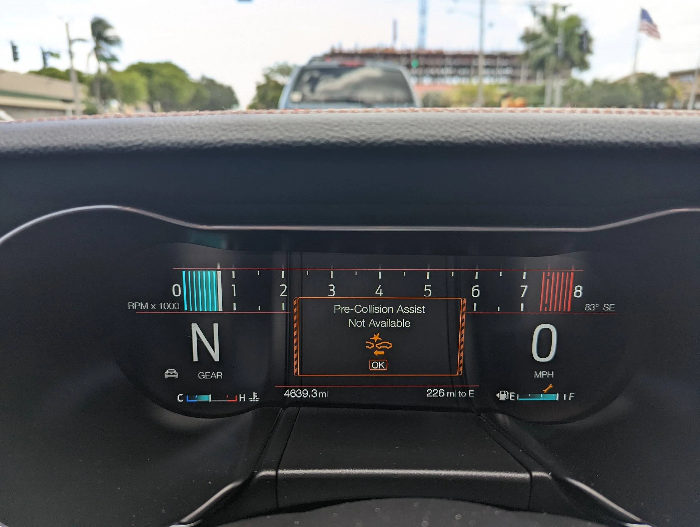

Yesterday and today, I made a right turn (shouldn't matter) and instantly floored it, Each time the "Pre-collision assist not available" message came on and car went into limp mode. Had to pull over somewhere and wait a couple of minutes for it to reset.
Today I turned off the Pre-collision assist feature and the car instantly drove better. Sounds crazy right? Each time when shifting from first into second gear (manual) I could hear a little noise coming from the gearbox or clutch, but its a noise I heard before in other cars. After turning off the collision assist that noise is gone, and the car seems to drive a little bit smoother. Does that make any sense?
Besides that, what could cause the collision assist to come on? Thank you in advance.

How did you turn it off...? I thought you could only reduce sensitivity and disable automatic braking?

Just went into the car, I turned off the distance indicator. I will turn it back on tomorrow and do a test drive to see if the noise is back and how it behaves.

The crap will sadly reactivate itself each and every time you start the engine. Luckily it can be killed for good with ForScan.

Happened again on the Interstate last Tuesday.. not cool, car went into limp mode, had to take the next exit, park, turn off the car, restart, and good to go.
This morning I had an appointment at my Ford dealership, of course they couldn't duplicate the issue. Next time it happens is to let them know, take another screenshot so they can open an "issue/ticket" with corporate.
Maybe they "fixed" it by just "looking" at the car? So far so good 🤔
Will try to force the "Pre-collision assist not available" message to come back on this afternoon.

It's strange, because the loss of the pre-collision alert should not trigger the limp mode. I did lose it once or twice in my Mondeo or Kuga, due to dirt on the radar or on the windshield, but the car remained perfectly drivable.
The limp mode makes me think that there's a deeper issue, and that the pre-collision alert is just a collateral victim of that.
