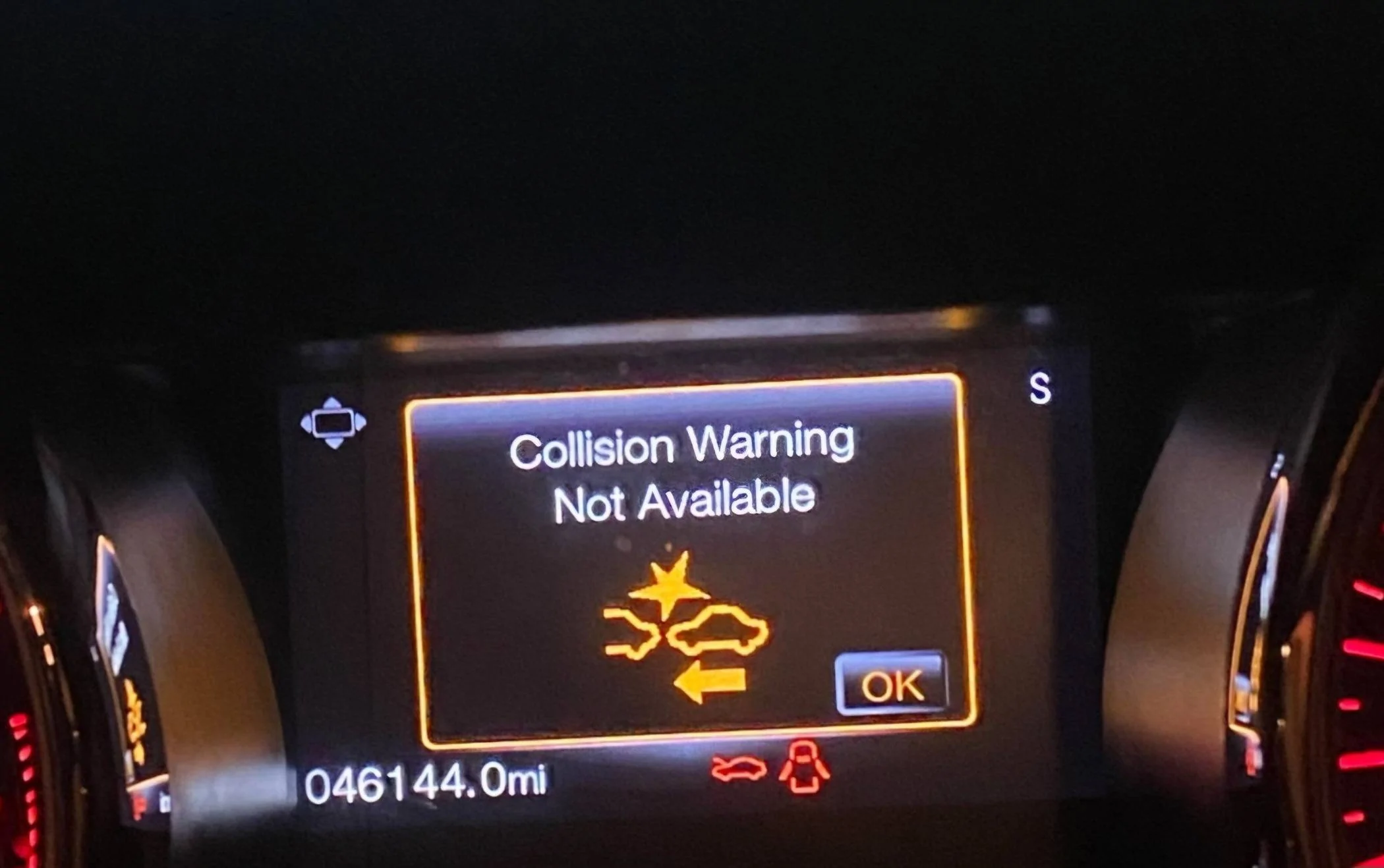

Hey had anyone ever gotten this?? I tried disconnecting the battery and it still shows up tried to reload the tune and still shows up disconnected the modular under the front bumper and still there so idkk it's not reading any codes with the Ngauge

Go to the engine bay and unplug/replug the "dyno plug" when you open the hood it should be located on the right side on the body of the vehicle inside engine bay, at least on my 2016. I believe when I unplugged mine a while back it turned off many of the safety features, mainly used to turn off traction which is also a safety feature. Try resetting it. Good luck 👍

Okay awesome ill definitely do that, thanks bro!!😭🙏🙏🙏🔥
