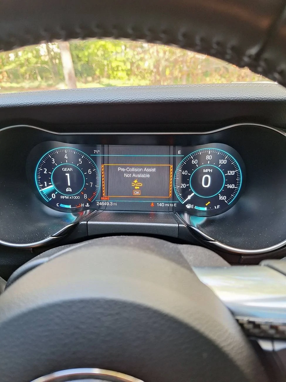

Within 30 seconds, received three alarms:
- Pre-collision assist not available
- Drive modes not available
- Traction Control off
Car was otherwise driving normally. No sputtering. No wrench light. Seemed like she was all there, except for the alarms and effectively being locked into Normal mode.
Attempted different things while driving. No improvement or changes. Pulled over to check the front of the car, to ensure I hadn't picked up a piece of trash or something. I had not. Ford Pass App confirmed same alarms. Got back in car, found this thread. By the time I decided to head home, it had been about 5-10 minutes with the car shutdown. Started driving for close to a minute, and then...
All the events cleared. Car was back 100%.
I then continued on home. Stopped and started the car two or three times afterwards, with no further alarms.
