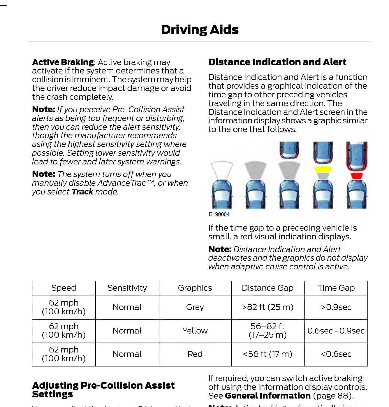

I looked in my manual and it shows both active braking and the fact that it turns off in track mode.
I activated the distance indication and alert. It’s a great tool for knowing how close you’re to the next car in case of heavy breaking.
I worry more about people tailgating me in a situation that I have to stop hard. With the distance indication (adaptive cruise off), if someone is too close behind, I try to stay on gray. I’ll have enough space/time to brake less hard in case the person in the back have crappy reflections/normal car brakes.
