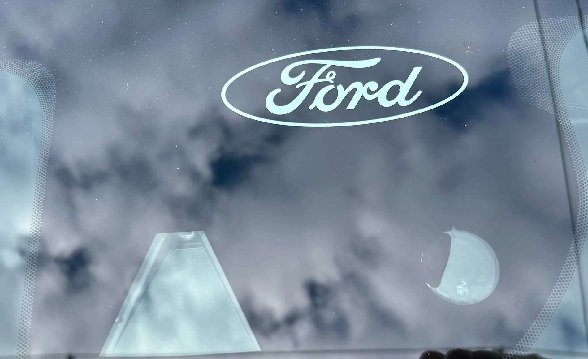

Just recently I’ve been getting Pre-Collision Assist Not Available popping up on my dash. Cruise control also stopped working. So last week while at the dealer getting an oil change I mentioned it to them. About 3-4 months ago I had the windshield replaced by a reputable shop I’ve done business with for several years and dealer told me it appears adhesive ??? is blocking the sensor and advised me to go back to the glass company. So looks like Monday I’ll be going back to glass company and see what they have to say.😩

Me toooo….if I didn’t use CC I wouldn’t bother going back to the glass company.
