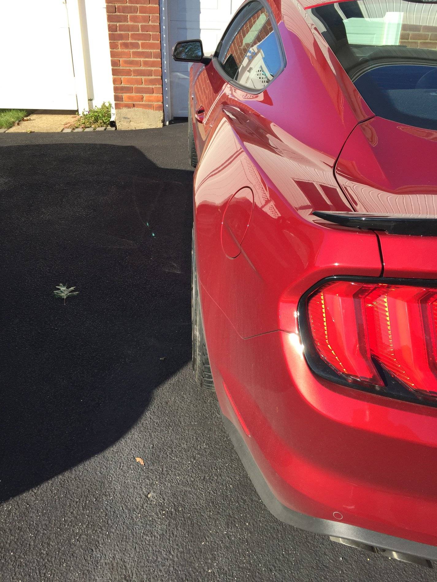

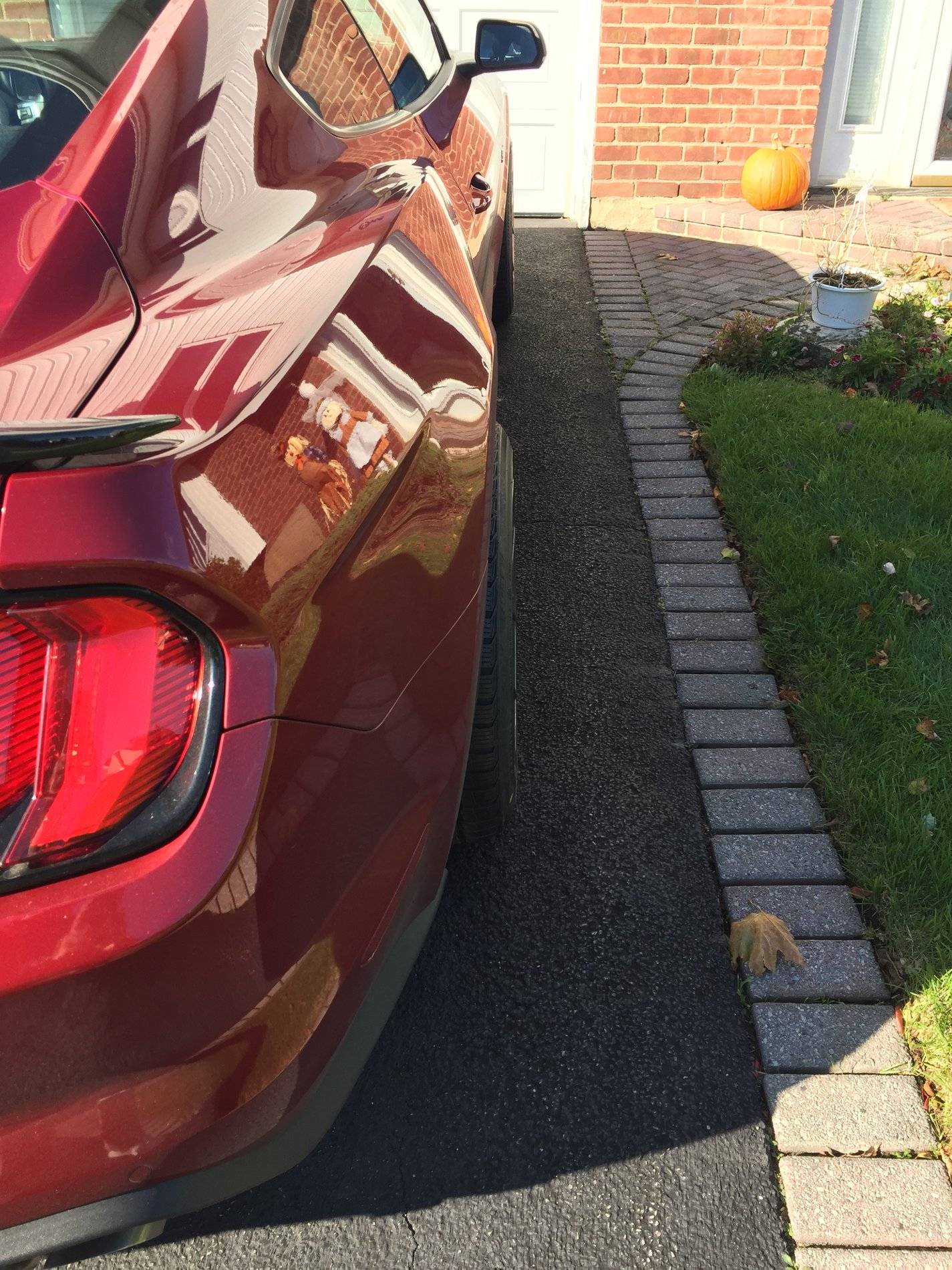

I can attest to the poke of the 19 x 10.5 ET24 in the rear. My PP2 came with a Front wheel mounted on the back (I had 3 19 x10.5 ET24 on the car)
It stuck out about 1.2"
10.5 on the rear.
Normal fitment of a 19 x11 ET48 (regular OEM PP2 wheel)
