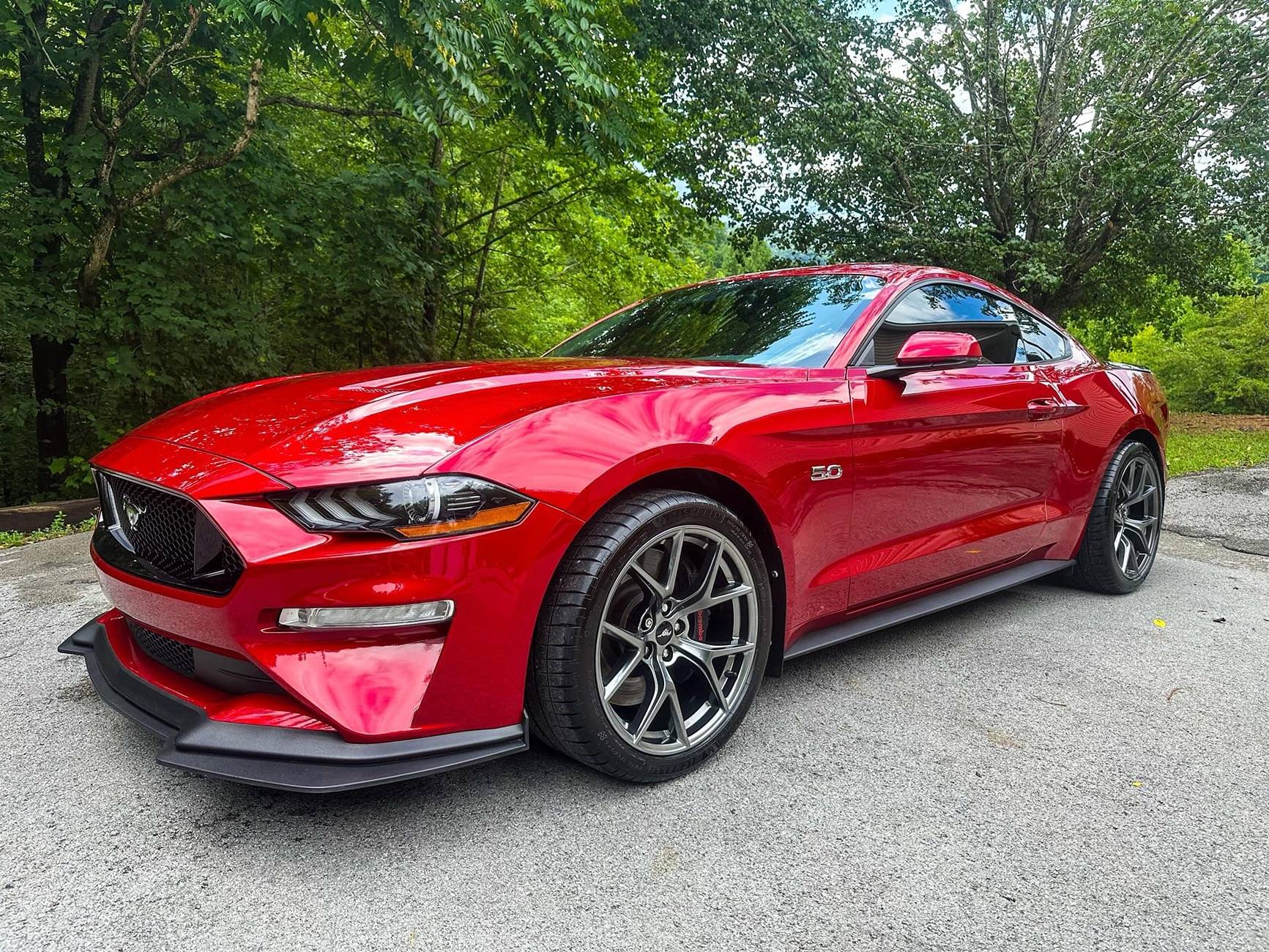

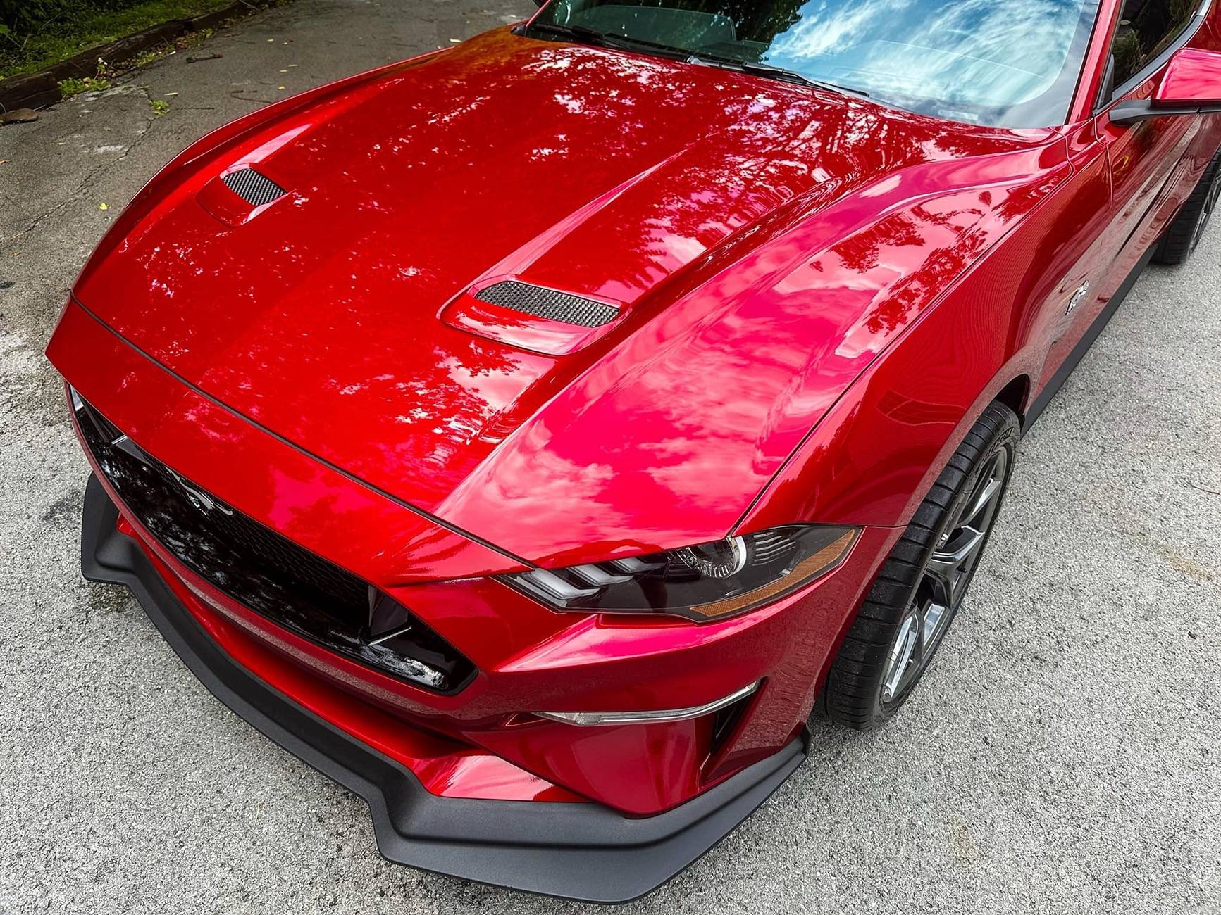

Yeah the Mach 1 HP wheels are the same way 10.5 front, 11 rear. Same offset. You can definitely see it on those wheels, its way more obvious the offset difference with them on the car. The PP2 wheels its obvious when you have them off the car, I ceramic coated a set a while back... And the PP2 wheels are my favorite by far. I wish I could find a set reasonably priced. The reps are black which I do not like. I want a original gunmetal grey set...
