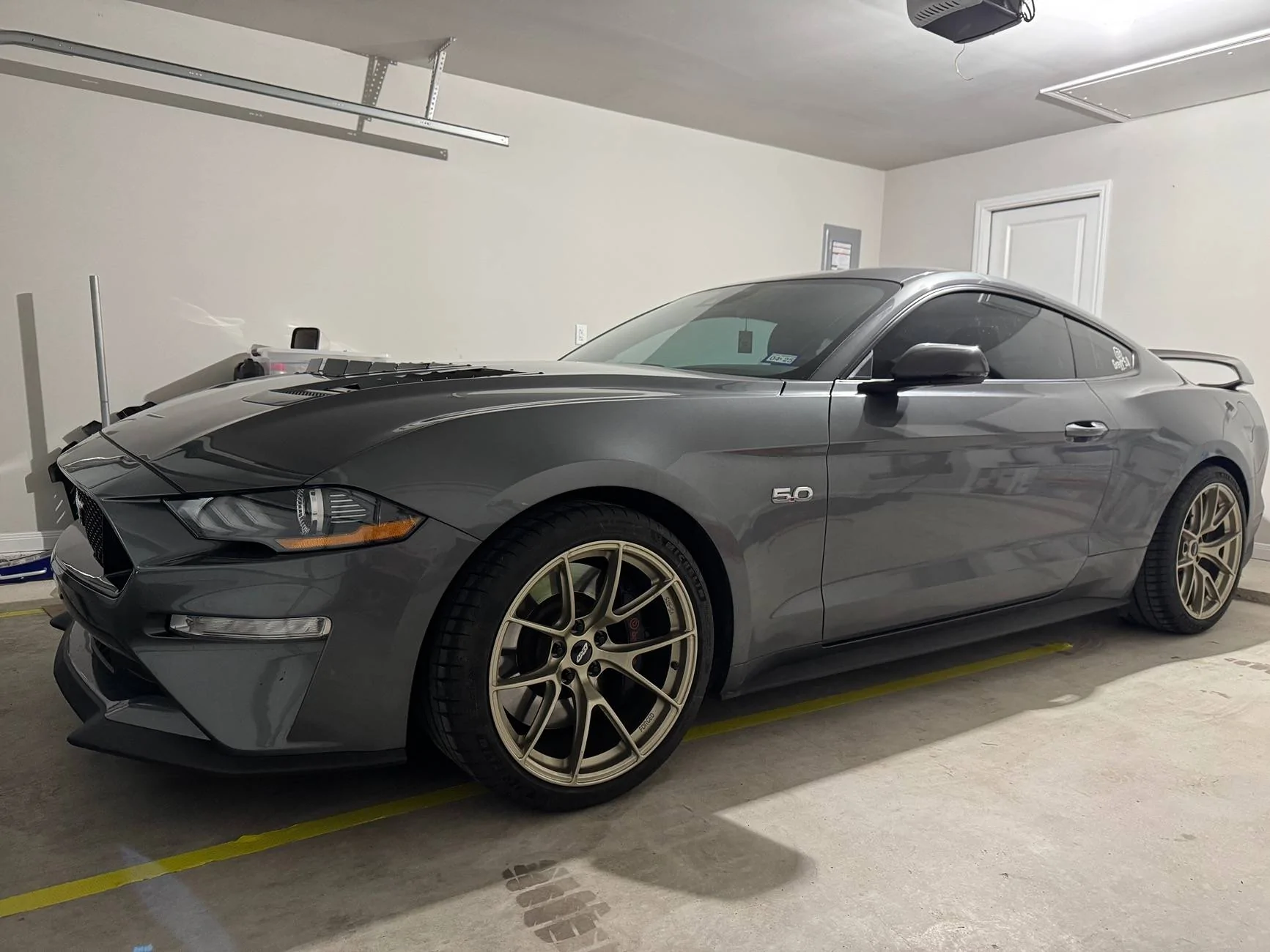

That’s understandable there and they are 19x11 ET 26/52 square 305/30/19

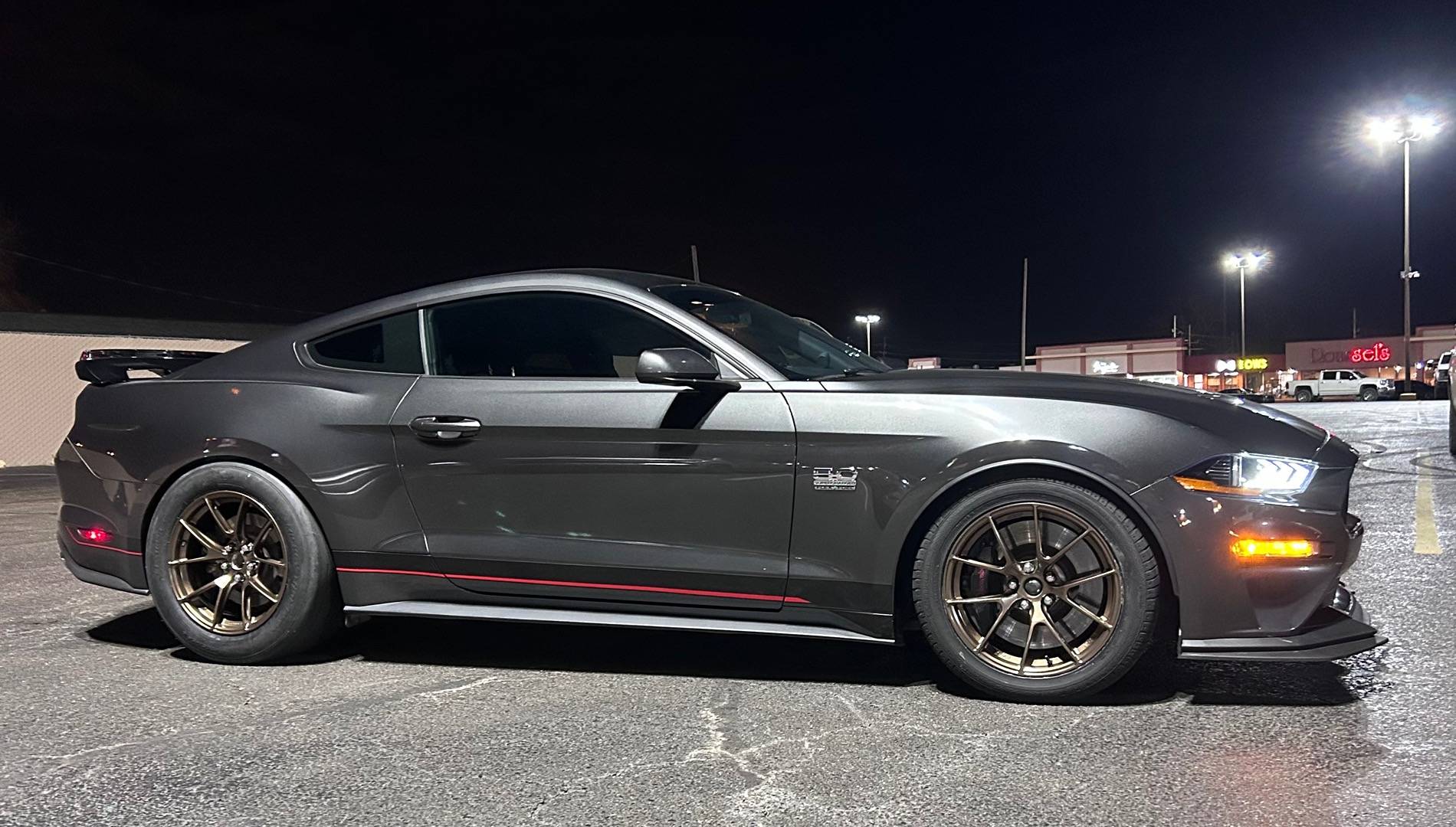

So I got a pair of 18x8.5 apex vs-5rs for the front, which appear to be intended for Tesla. The bolt pattern and offset is correct for Mustang but the hub hole is undersized. I bored it to size (don’t try this at home) and paired them with some continental 255/45r18 tires. On the scale this combo is 42.4 lb, which is a 21.6 lb per wheel reduction as compared to my current 64 lb wheels. They’re just a few lb heavier than your typical 18 or 19” front skinny setup, so I’m pretty happy with that.

I used a ryobi router and a spacer to get the cut radius correct.
If you didn’t insist on satin bronze they make a 19x9 that is similar weight and requires no cutting.
