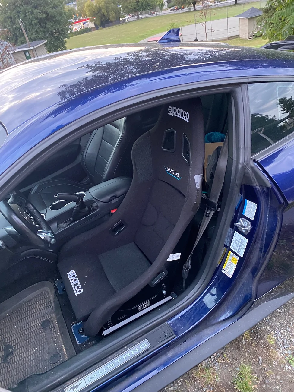

I remove my seat to put in my bucket for trackdays. I always have to move the seat forward and back when taking it out. No problem with the memories when putting it back in. I don’t unplug the negative terminal and the airbag hasn’t surprised me… yet.
