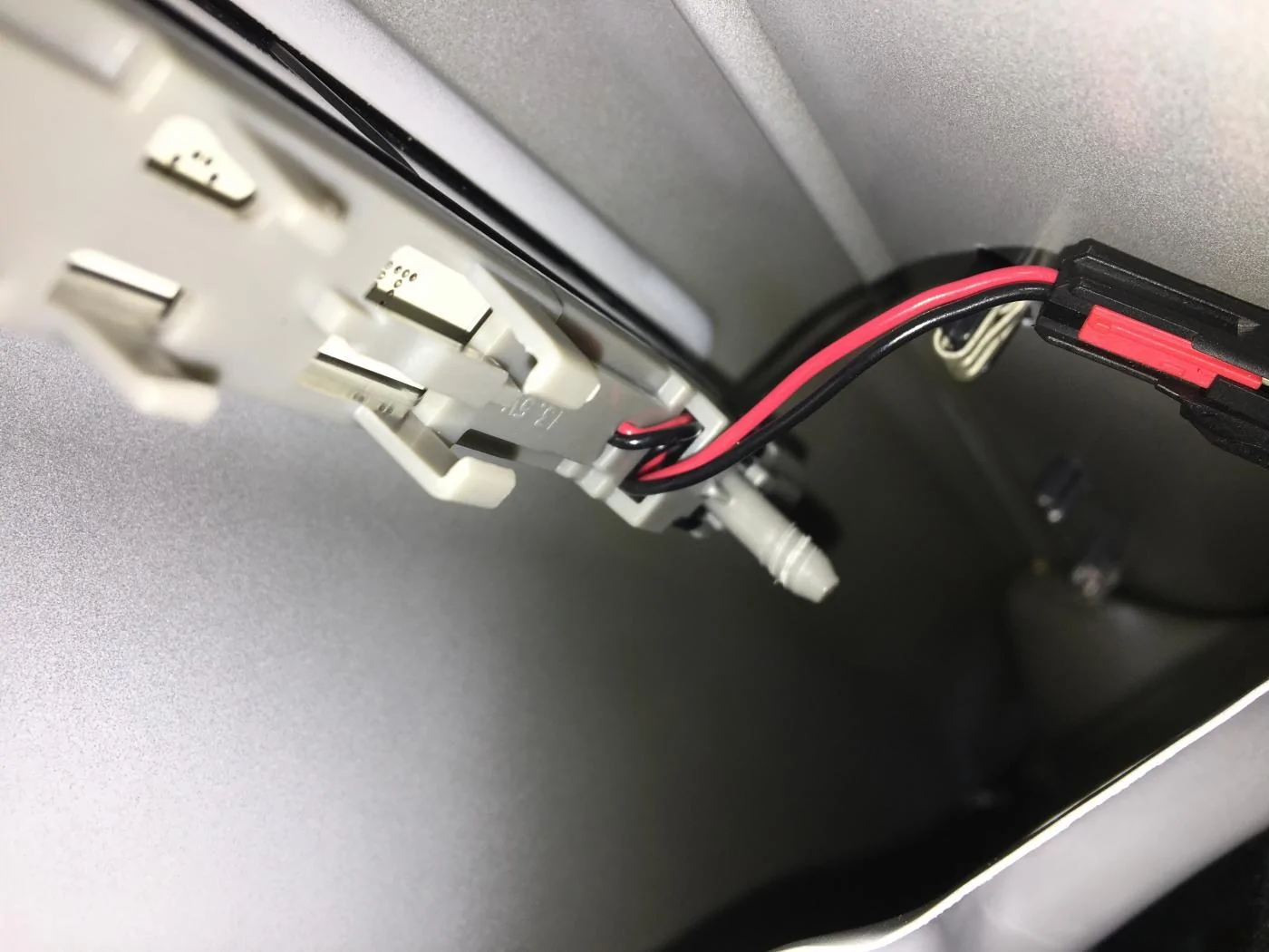

Your info was great. By the latch cover is a pain in the ass. I removed one of the clips from the back and still can't get that side of the light out. I think there is sealant keeping the light in. Makes sense to me, otherwise the trunk would be full of water. I am thinking the light comes with a sealant on it. And when pushed into the hole it seals. The clips are probably just there to hold the light until the sealant properly sets up.
Here is a pic of the passenger side of the light with the clip removed

Interesting. I could move mine on the drivers side just could not get it pas the clips. I wasn't wanting to take it off so I did not remove them, but that side seemed to be looser that the passengers.

Oh, I could move the light. But it just wouldn't break away from the trunk panel. So I am thinking there is some sort of a "sticky" gasket under the light. :shrug:
